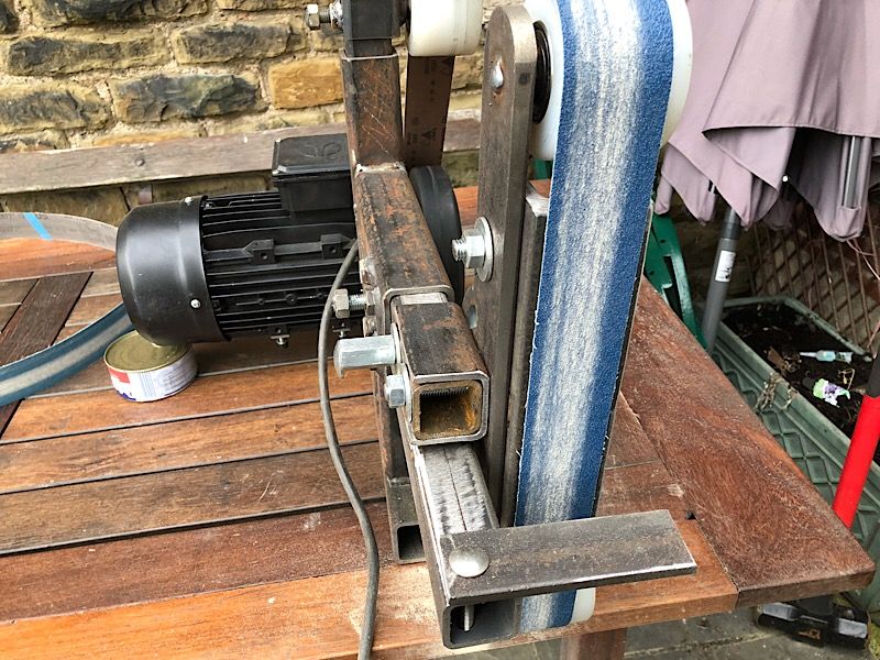

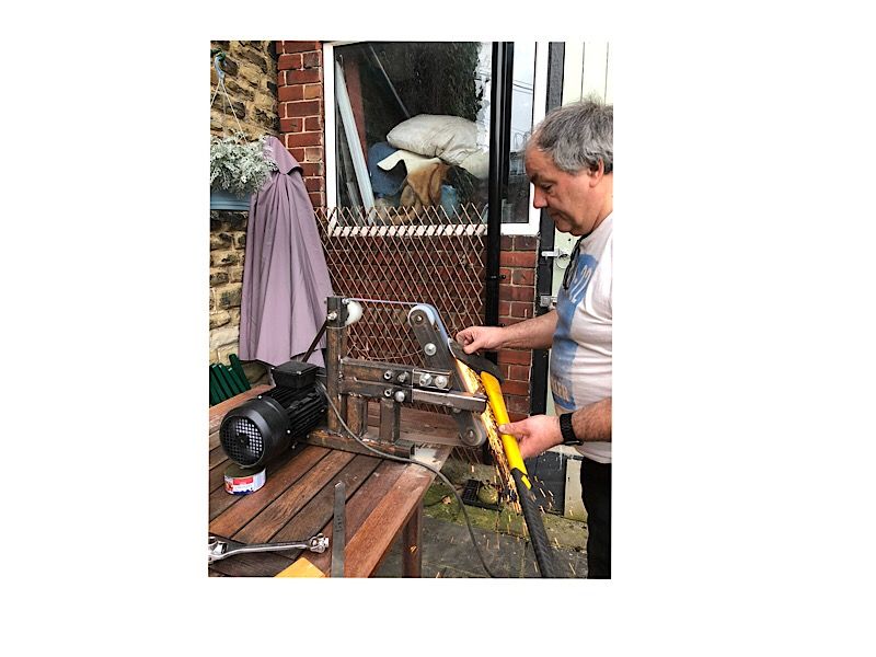

      The last couple of days i’ve Been knocking together a belt grinder/linisher/sander mainly for use on ferrous materials but also wood work projects
      Its a 1.5kw 1400 rpm motor drives from a vfd with a max of 100hz so roughly 2800 rpm
      A pallet truck steering wheel is mounted on the motor to drive the belt..its rubber and 200mm dia,this makes belt speeds of between 3 to 30 metres/second
      The other wheels are pallet truck load wheels which whilst working fine now probably need higher quality bearings fitting to cope with the increased speeds that they find themselves doing
      the frame is 50mm square 5mm wall with 40mm for the rests and tracking adjustments
      Just got it working this afternoon and it can surely make sparks

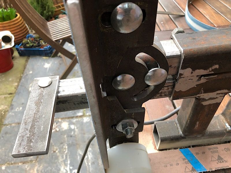

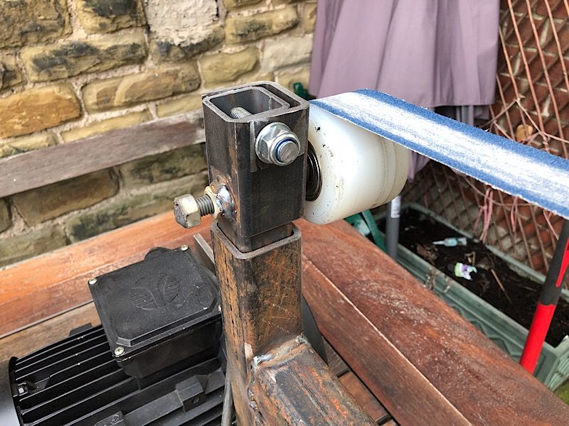

          The uppermost pulley has a tracking adjuster and is sprung with an old motorcycle front fork spring so to change belts it’s just push down and slip off old belt and slip on new let go and everything is set
          I’ve made it to take 2 inch by 72 belts which are very common and easy to get in various grits and types of grit however looking through my woodwork shop i found 30 2inch by 98 inch 30 grit belts.does anyone have any idea if i could shorten these easily? What adhesive and procedure to use?

              Very nice – quite fancy making one myself. As regards shortening the 98 inch belts, I'd be tempted not to, and just make another top pulley on a longer piece of square section to take up the slack. Or even just make a longer piece to take your existing pulley – bit of a faff if you change belts often, but will do until you've worked through your existing stock.

                I agree that I would leave the belts alone and either use them with an extra idler or sell them to buy more of the right size.

                              Some nice details there and a few things I bet you will tweak. It looks like your tracking wheel or the tool arm are designed to be adjustable to take up slack – just increase this adjustment provision so you can take 90 in belts. It is really handy being able to take different belts as it gives you more options for buying bargains. However, belts are not all the same and it is worth getting quality. I find the joint is one of the most important features (so it doesn't bump when grinding0 and making good joints in cut down belts may be an art of its own.

                                  Ian, if it can make sparks, why are you not wearing safety glasses sharpening your axe?

                                    +1 here, Chris. Wrong (even if the poster claims it was not running at the time – as is the usual excuse). Apart from personal safety, it does not give good guidance to others who may know no better.

                                      No excuse for the glasses omission but no sparks come up all go down onto your feet but that’s not to say that something could come off the belt…i’m Usually always wearing glasses anyway not sure why not there..i’m Still amazed at its metal removing power i’ve Not managed to stall it yet which i can easily on my other sanders grinders.with a 60 grit belt it chomps through 6mm ground flat stock.

                                        ndiy, it is running if you study the picture, you can see the sparks.
                                        Ian, it looks a fine job, but I would not risk it even if you think the sparks are going downhill.
                                        Some welders spats might be handy as well if you value your socks.

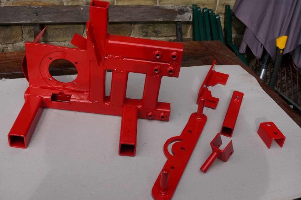

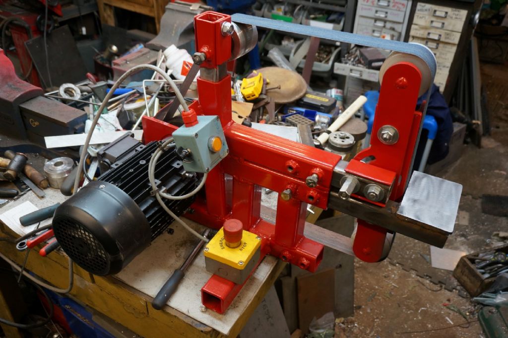

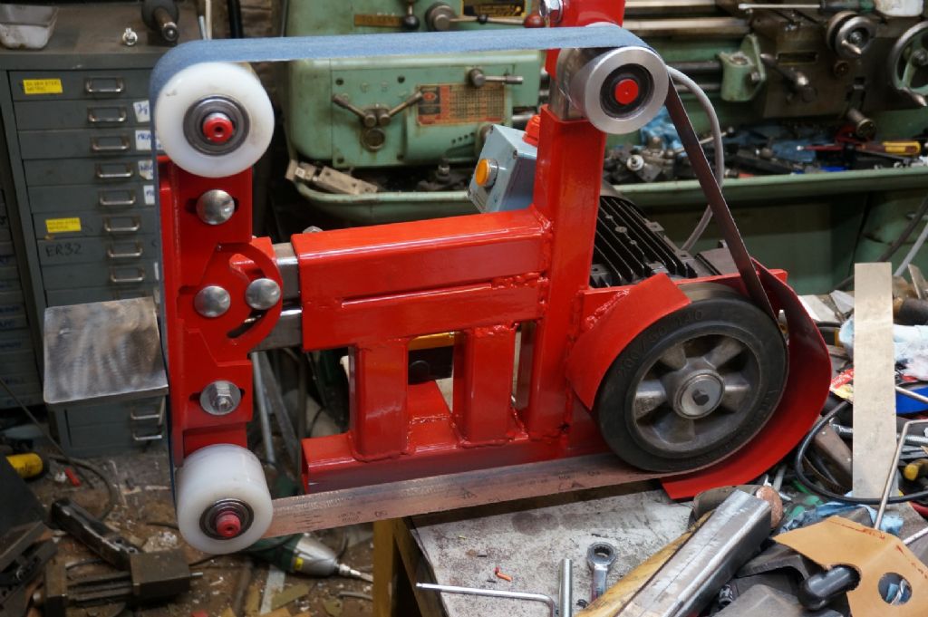

                                          After fine tuning making sure no more welding parts on and drilling was needed i took all the parts to be powder coated amazing the difference it makes
                                          now back together with vfd controls mounted
                                          At the present the vfd is mounted on a ceiling joist awaiting a suitable enclosure to be found
                                          shrpening drills and hss tool bits is now a pleasure
