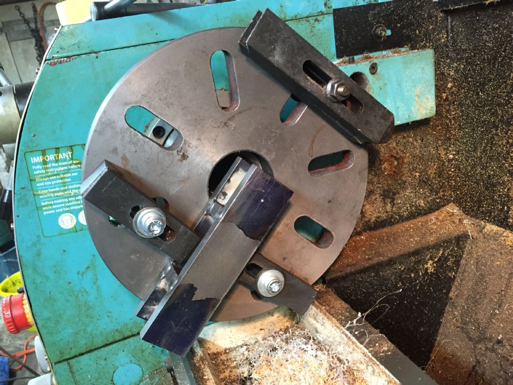

      I'm very inexperienced with faceplate work and nervous about workholding.Do you reckon this setup will be safe?
      Plan is to drill the first bar say 8mm, spot through the hole to the second then drill both in stages to say 13mm at which point I can get a boring bar in to open up the holes to 26mm.
      The counterweight arrangement is a lash-up just to get an idea of what I need – it protrudes beyond the face of the workpiece, which is probably asking for trouble, but I can fix that.
      I've spun the arrangement at 300rpm and nothing's come apart – my concern is more that when I start cutting, if I had a drill snag say and the packing pieces on the clamps were dislodged, all hell would break loose. Maybe I'm being over anxious, but any any comments or suggestions for better ways of holding the work would be welcome.

          You could bolt 2 pieces of flat bar using the on the centre faceplate slots, just butt the ends up to the lower plate being drilled, that would prevent any sideways movement of the workpiece.

              Well, safe it ain't, but serviceable – yes. I'm with you I don't like the bits sticking out beyond the periphery of the faceplate, but given that the workpiece is the size it is it don't make no never mind whether you've got one bit sticking over the edge or three. However for no better reason than to calm my nerves I'd be slightly happier if the counterweight bolt was head visible not tail visible. Anything to reduce the pokey sticky out bits.
              Which brings me to the first rule of face plate work
              Don't get your finger in the mangle.
              Second rule is don't get anything else in the mangle either (hair, beard, sleeve, watchstrap, wedding ring etc etc…..)
              Seriously though, 300 rpm – which isn't a lot if you're only drilling the pilot hole – is still enough you can't see the catch points, so you have to remember not to get close enough to get caught. It sounds obvious but make a conscious decision where the limits of the no go area are while the work is stationary and before turning if on.
              Make no sudden movements – ask yourself all the time "am I still outside the danger zone if I make this next movement"? It goes without saying you must roll the work through a few revolutions to be sure nothing fouls THROUGHOUT THE LIMITS OF MOVEMENT OF THE TOOL. I find it useful to clamp a bed stop in position to stop the saddle getting too close to the headstock and potentially contacting the rotating work.
              How are you going to deal with the situation where it all goes horribly wrong. Can you reach the OFF button without crossing the zone of flying debris? A footbrake is a comforting feature suddenly. Can you bring the situation back under control whilst staying right of the saddle?
              Faceplate work like this gives me the heebie jeebies. If anything does shift it'll go to hell in a handcart before you can say oops. But it's very effective way of getting an accurately sized hole square to the surface.
              I like Emgee's suggestion of two additional plates clamped on a diameter at right angles to the long axis of the work to be positive stops. As they are on a diameter they won't introduce an out of balance moment.
              Make sure your fixings are not only tight but also clamp solid metal, you'll be fine.
              Good luck Simon
              PS Did I say keep your fingers out of the mangle?

                And I meant to say please be sure that the packing pieces at the outer end of the two toe clamps holding the work in place are positively located to the clamp plates. They are at the periphery of the faceplate, so encounter the maximum bursting forces, and moreover if one of them does shift you're in trouble straightaway. So I wouldn't rely on the clamp force reaction/friction to hold these from spinning off the faceplate.

                    From the photo, the work piece seems to be two lengths, held apart by welded bridging pieces. So there would appear to be a gap in the middle, through which a simple strap could be passed. A bit of extra effort but a lot safer.
                    I find 'stepped' blocks tend to move even in static use (assuming that's what the 'packing' blocks are). I would try to avoid their use here, hence the strap suggestion. I'd try the two counter-weight straps differently too – mounting them individually but in a radial position (like a 'V' ). The inner ends could then be used to help hold the work in place. You may not get quite the same balance effect with this arrangement – but probably enough and it would be better than having those two bits sticking out. For something like this – I'd also run it as slowly as possible – a sharp drill will still work.

                        I would never use those unsecured step blocks as packing. I like to have everything on the face plate except perhaps the job itself with a bolt through it into the faceplate so it can come loose but not fling off. I would drill and tap a hole in the end of those two clamps and put a bolt through there that makes an adjustable packing piece. Set it so the head of the bolt bears on the faceplate and screw it out so it sets the clamp at the correct height (ie just a tad higher than the job).
                        And I would not use those two clamps with razor-like angled leading edge sticking out past the periphery as counterweights. I'll use preferably a piece or two of 2" or so round bar with a hole drilled through the middle. Painted red so you can see them swinging around in motion. If those long clamps come loose they are going to swing out under centrifugal force and foul on the bed. Could get nasty. Or a couple of spare change gears can be used as counterweights.
                        +1 on put a couple of pieces next to the job in the centre to stop it sliding sideways, because the clamps are a long way from where teh cutting is going on and job could move a bit quite easily.

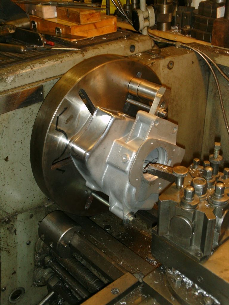

                        Using bolts tapped into the clamps as packing substitutes can be seen here, in this rather precarious set up.
                        Even then, stand well clear of the line of fire. Get your self up next to the tailstock somewhere while drilling and boring etc. And keep hands well clear of the faceplate AND PROTRUSIONS area. It is all too easy to focus on the little calm area in the middle where you are drilling or boring and forget completely about the meat shredder whirling around outside it. Obviously don't out of habit go to flick away a bit of swarf or feel the vibration on the boring bar etc. Keep on hand on the tailstock or leadscrew handle and the other on the cross slide handle etc. at all times.

                              Looking at the OP picture again, another thing I might do is move the job around so it sits between two slots, rather than right on top of one slot. This would allow clamping bolts to be right up close to the job, so in the best position for clamping force. As they are, clamping force is mediocre due to bolts being halfway between packer and job.

                                Regarding the original picture I'd be inclined to move the balance weights in slightly, as it's not clear if they'll clear the bed. I'd also second the blocks at the front of the work to stop it twisting, to the extent that if it isn't done the work will twist.
                                Ho hum, I use step blocks quite a lot. Although not clear there are six clamps and step blocks holding this smokebox:

                                          I'm not too worried about the step blocks flying off due to centrifugal force alone – at 300rpm on a 10 inch faceplate the radial acceleration at the periphery is around 12.5g (123 m/s^2) – so given that the blocks have a mass of around 45 grams, the force on them is about 5.5N, roughly the weight of a 550 gram mass – nowhere near enough to shift them all other things being equal. However I take the point that this method isn't good practice – all other things could rapidly become unequal!
                                          I shall redesign the setup in the light of your comments – secure the packing, reduce the number of sticky-outy bits and put some further supports in as per Emgee's suggestion.
                                          Regarding recovery from an 'incident', the lathe has a stamp bar which stops the motor/ spindle in well under a second. My reaction time in a panic situation is another matter….
