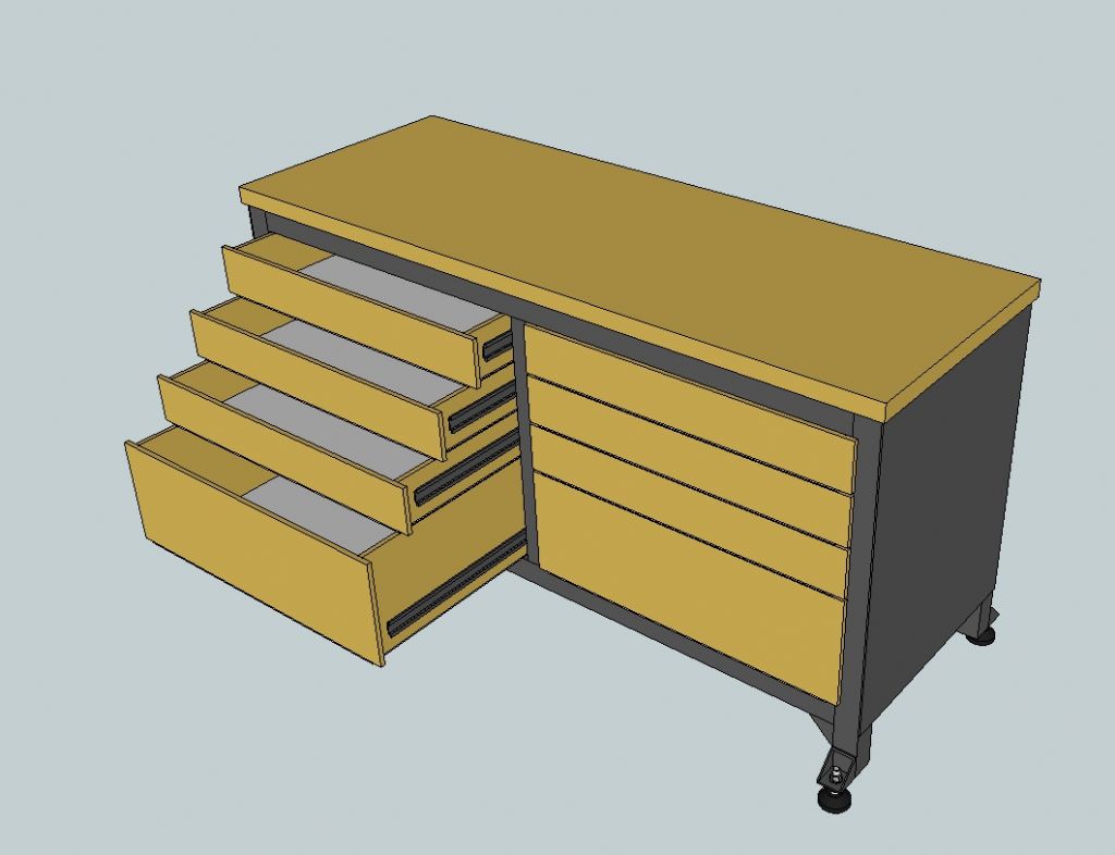

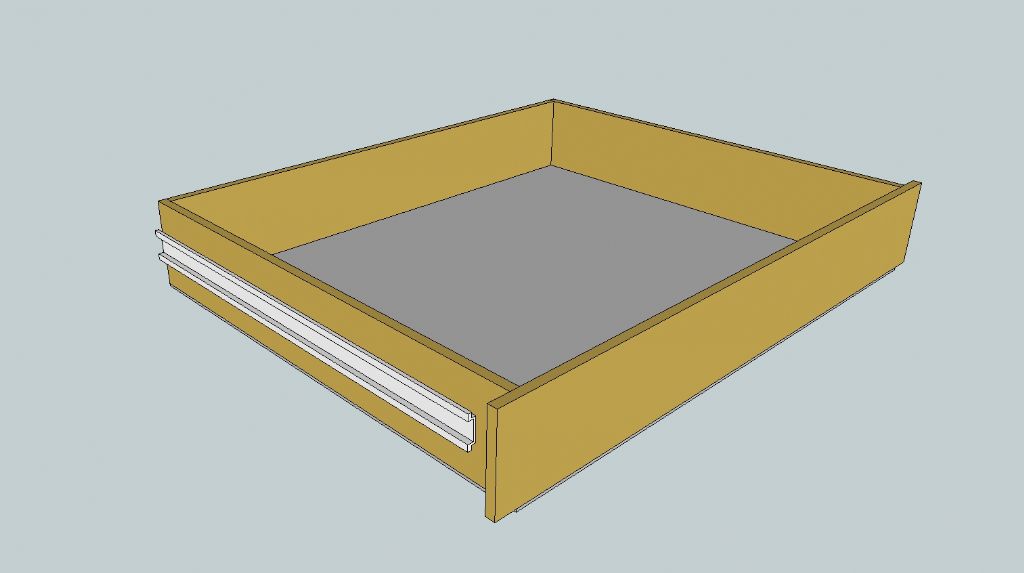

        Hello, I'm at a loss trying to figure out the best way to construct drawers for a workbench and two machine stands. Basically I want three shallowish drawers at the top (10cm deep) and a single deeper drawer (23cm deep). I'm no carpenter so I have no idea how to go about doing them. My thoughts were plywood sides, fronts and backs on telescoping rails and a steel or aluminium bottom, ( if I went for plywood bottom I'd loose more space because of the thickness)… am I on the right track? Ideas and advice are most welcome.
        This is what I have in mind, to explain myself better.

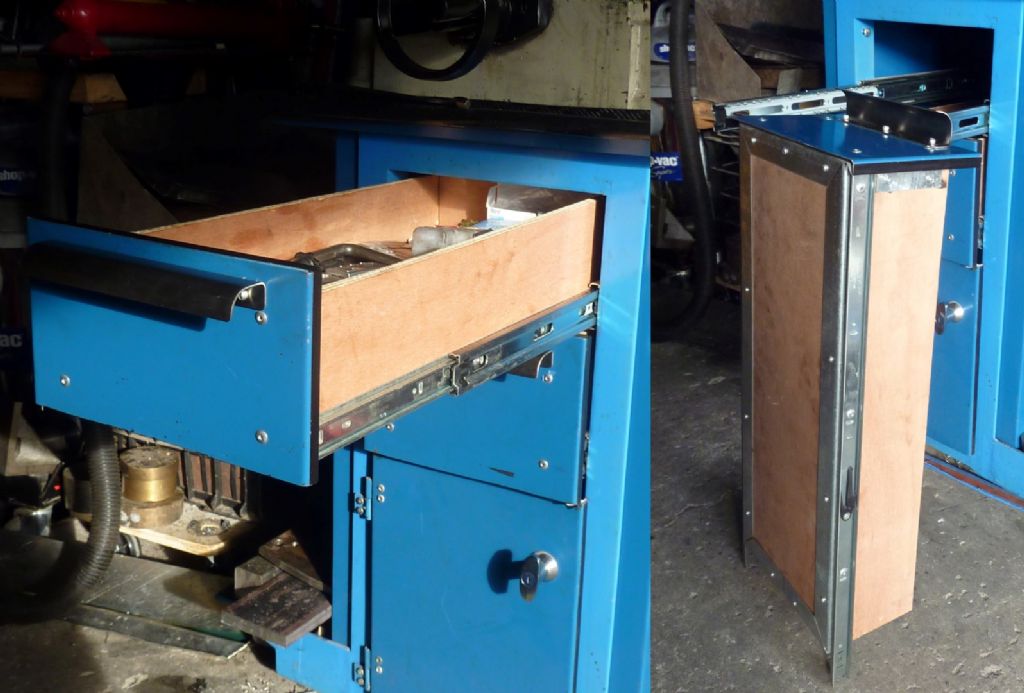

            I used plywood for the sides and bottom of the drawers and re-inforced the corners with 16g steel angle. The angle was pop rivetted to the plywood. Steel washers used as a backing to prevent the rivets pulling thru the plywood and the draw slides rivetted to the steel angle.
            These drawers are light and strong and will extend completely out of the cabinet on the telescopic slides.

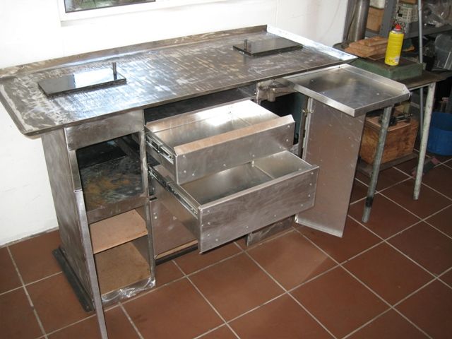

              Why not fully from 2mm Aluminium, as I did here:
              Joe

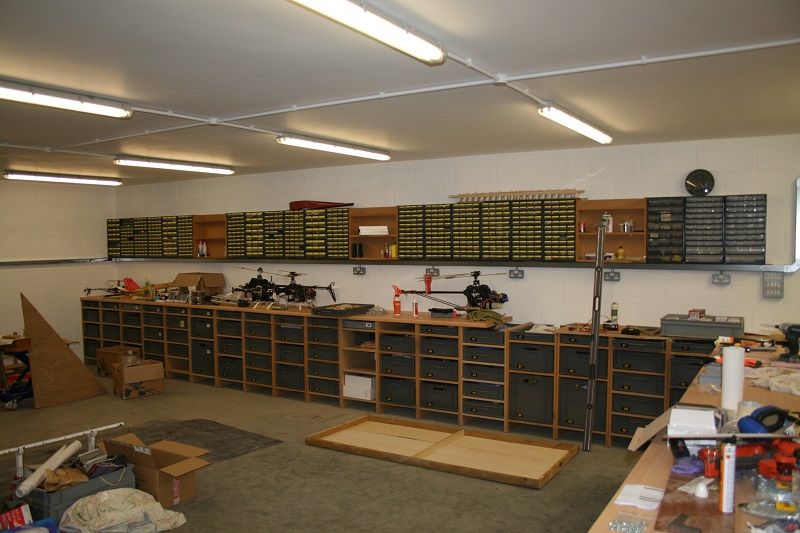

                                            oh, nice workshop Spurry……..clogs
