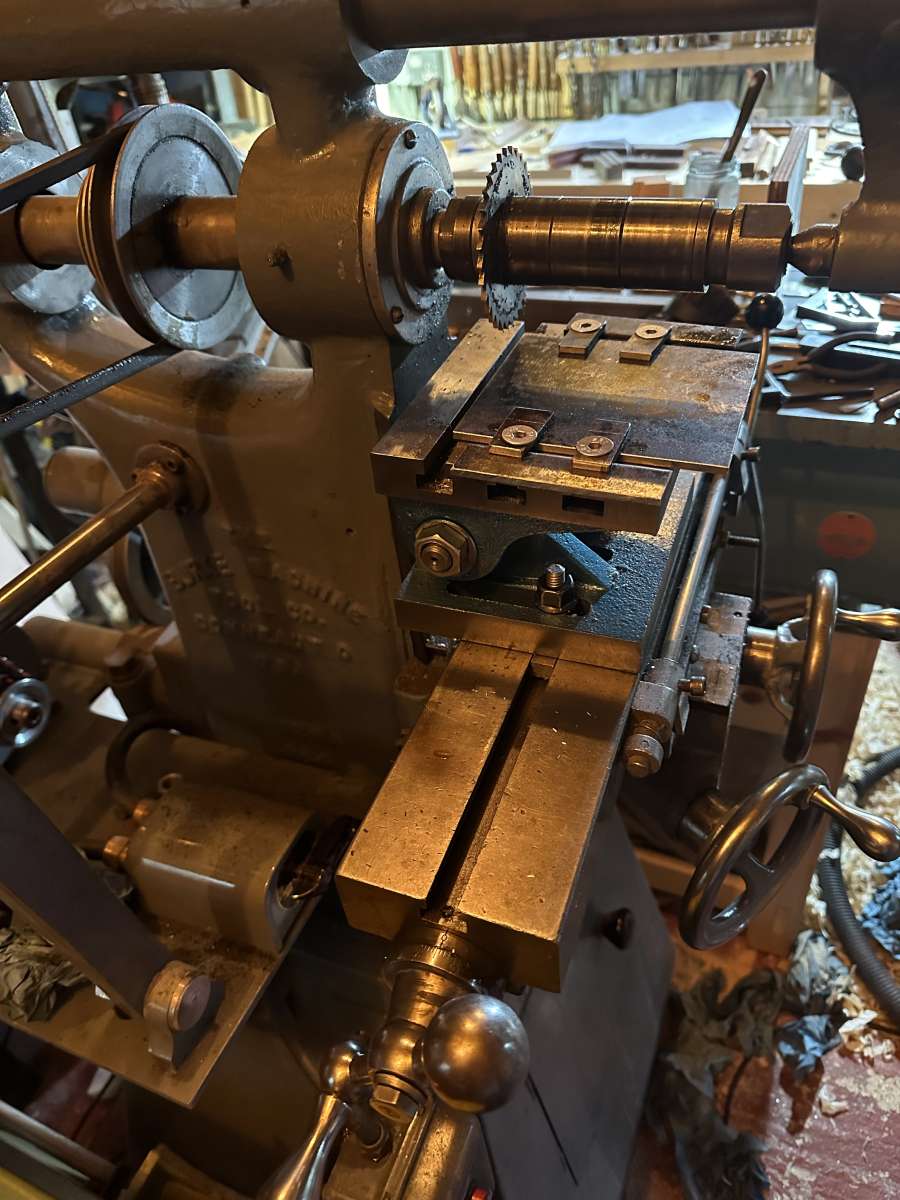

      I recently had a need to cut a piece of mild steel into an L shape, to make a little square as part of a woodworking tool I’m making. The square needs to be very square, but not engineering, square squareness. So I cut the piece and then checked it carefully using my surface plate et cetera. It was way out. For what I’m doing, I would be happy with it being a thou or two out of square.
      A problem with the Burke #4 mill is that the table has only one T slot. So to cut a straight edge on a piece of flat stock, you generally have to clamp it onto the table, and use a slitting saw off the edge of the table to cut the metal. The problem is, it’s extremely difficult to clamp it well enough to ensure that there is no movement whatsoever. I am 95% certain this is the source of my problem.
      So today, I attached a little angle table I have to the main table I made a few little low profile clamps to hold the work better. I seem to get a much better result, and the cut was much more friendly too, with no sticking with the slitting saw, which is something that it has been prone to. See below a picture of what I’m trying to describe.
      However, this isn’t really a solution because the little angle table isn’t really big enough to do many of the operations that I need to do (mainly cutting woodworking plane blades and making bits of tools).
      so really, I need to get hold of a more useful T slot table with more slots, and bolt it to the single slot table on the mill. I have noticed on eBay that there are various extruded aluminium tables design for CNC purposes. Might this be a good way to go, to improve the general work holding capability of my mail? Or does anybody have a better idea?

        I think you would be better off with a thickish ali plate that you put a key in the underside to align it to the slot, then a few thin slots, only 1/8″ on top for picking up alignment only and do the hold down with tapped holes.
        Another alignment aid on the current table is a nice straight bar say 1 1/2 x 3/8 that has a couple of pins at each end to align it to the back edge of the table. Could even be worth drilling and tapping the table itself to hold it in place.

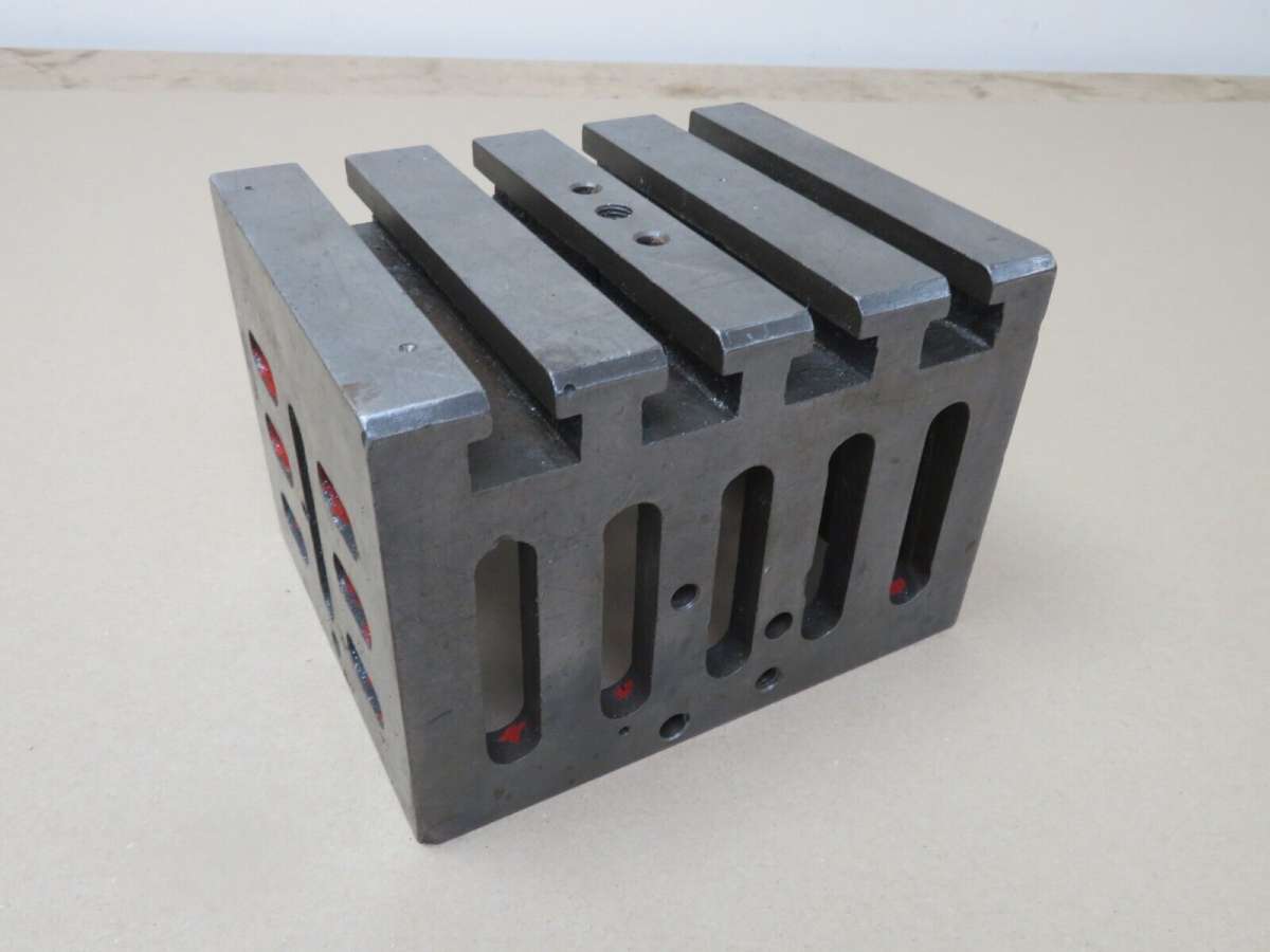

            Hi Steve you need a cube box clamping tool like this.
            s-l1600
            And also i think you can replace the arbour shaft to have a milling tool holder so you can use standard milling cutters. you can also clamp a small milling vice to the side or top of the cube to hold jobs.

              I have a vertical mill for vertical milling (Dore Westbury) . What I’m trying to do is to cut through (usually O1) accurately and with low heat. Effectively using it like a table saw for metal. I’ve gone to a lot of trouble recently to get the Burke mill running nice and slow, and it cuts O1 very nicely. But as I said the really stupid thing about this mill is the single T slot.
              I have tried a side and face cutter, problem is that those I have are too big or too wide. I thought about getting a slim ish one – say 1/8” or so. I will see what I can find on eBay.
              I like the idea of the aluminium plate…. Essentially building a jig that would work for things I regularly do, with a load of threaded holes for clamps and locator pins, and some grooves to accommodate the cutter.

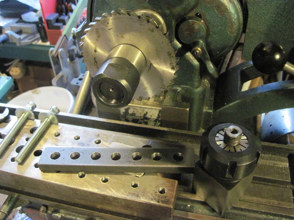

                        My Atlas MF mill has only one T-slot Steve and the answer is very simple, just use a sub-table. I have several that bolt securely to the Atlas table and they have various slots cut or holes drilled & threaded into them, depending on what I need to do. The one shown is probably a bit thick but has been very useful to hold parts for various operations. Not sure what I was up to here but I have a saw abor fitted and often use end mills in horizontal mode to trim work…
                        IMG_5387
                        A special ‘sub-table’ can also be used to adapt your mill table to other accessories such as vices and angle plates too – probably more useful when horizonal milling. Much simpler than changing your mill!  🙂
