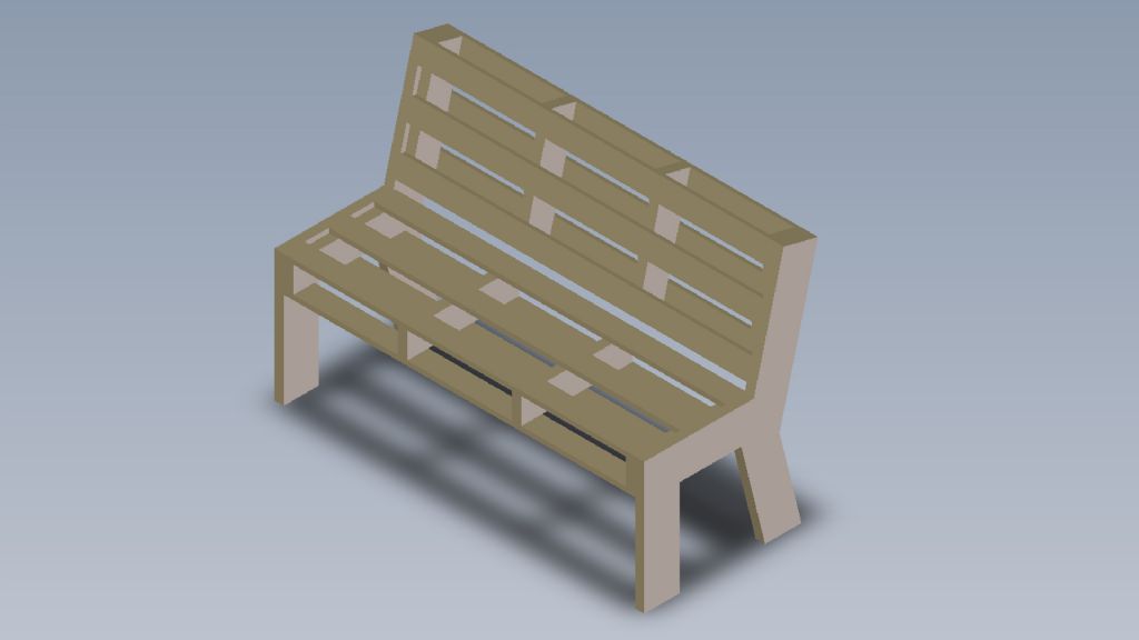

                            Ron Colvin
                              @roncolvin83430
                              Have the same problem (disposing of old pallet). My mother would like to have a garden seat, so this is my proposed two birds with one stone solution. garden seat.jpg

                                Brian Oldford
                                  @brianoldford70365
                                  Posted by Ron Colvin on 22/07/2017 19:30:55:
                                  As is, I foresee a problem of splinters in the nether regions.
