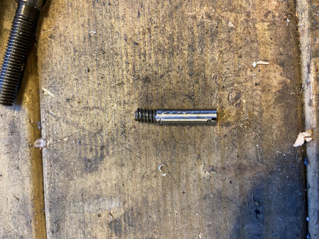

        Hi all
        Stupid question probably,.,. I have been trying to put threads on 3/16” rods using a 3/16” BSW die (this is to try to fix the half nut engagement mechanism on my lathe).
        But they often come out wonky – see pic.
        Does anyone have any tips for making sure they are straight?
        Thanks
        Steve

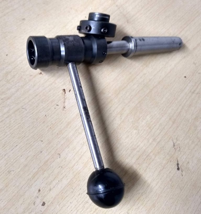

              I use a die-holder in the tailstock, something like this.
              Thor

                Fully agree with doing it in the lathe if you can. Alternatively, I have done it with the rod held in a bench drill chuck and the dieholder flat on the table to keep things true, turning by hand of course.
                To my eyes the threaded section of the rod pictured seems to be actually bent, which is easy to do when hand threading something that small without a guide.
                Mike.

                  I also use a tailstock die holder, like this.

                          What's the rod made of? I've had similar problems with DIY store metal – it doesn't machine well.
                          The rod may be on the soft side, deforming and twisting rather than cutting. Possibly a hard outer shell on a soft core, or it work-hardens like some stainless steels. A sharp new die with plenty of thread cutting lubricant like CT90 would help.

                                When using a die making the first thread or so produces seriously unbalanced forces because there is nothing supporting the inside of the die opposite the cutting edges. This force imbalance tends to tip the die off line during the formation of the first thread so a drunken thread results as the die stabilises following the line of the first thread.
                                The coarser the thread the more pronounced the effect. Coarsness being defined by helix angle not absolute pitch or TPI. High TPI or small pitch on a small diameter can be coarser than a much lower TPI or larger pitch on a larger diameter.
                                3/16 BSW is very coarse. Small diameter doesn't help because the slender shaft and even slenderer core diameter isn't terribly stiff.
                                Hence the need for firm die support. Either a die holder system with a decent size, nicely stiff, rod up the middle or something cruder like a flat ended pusher in the tailstock chuck. Pusher has to be just small enough to push directly on the die when its held in the diestock. Need to figure out something to stop the diestock turning yet still permit it to slide as one hand is occupied turning the chuck whilst the other operates the tailstock feed. As methods go that is maybe a bit on the crude and primitive size but I did many threads that way before being able to afford better equipment.
                                Objectively the best answer is a Coventry die head but its hard for the normally impecunious Model Engineer or Home Shop Worker to justify the cost.
                                D'oH moment. Make sure the die is in the holder the right way round. Put it in backwards and the clearances will be wrong way round so it won't want to cut. Which really doesn't help with going straight.

                                          When threading with a die in a tailstock die holder its probably easiest to just turn the chuck by hand with the drive in neutral. Use the tailstock handwheel to apply feed pressure. Once the die is cutting it will feed by itself. Best to back off the tailstock once the die is self feeding.
                                          Spin the chuck backwards to run the die off the completed thread. If you hadn't backed off the tailstock feed earlier once the die began to self feed you will need to now to make room for it to come off.
                                          I'd do it under power running at low speed but I've had plenty of practice. Turning by hand is less committed.
                                          Do lubricate the material to be threaded, preferably with a proper threading lubricant, but grease of heavy oil will work adequately. Much better finish.
                                          As I said in my previous posts a simple pusher in the tailstock chuck pressing on the die to keep it straight works well enough. More refined ways are just faster and need less setting up. No realistic difference in job quality.
