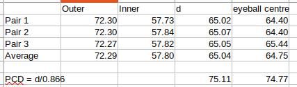

                #601813
                  Seemed like a bit of fun before I hit the road.
                  Measured the inside and outside distances between all three studs, averaged them and did the maths to get average centre to centre distance.
                  Also measured perceived centre to centre distances by eye.
                  Finally applied 3-hole PCD formula: PCD = centre to centre distance / 0.866 (At least one motoring website has the divisor wrong: I used this maths teaching site.)
                  Results:
                  So, measuring carefully suggests PCD is 75.11, and eyeballing the centres gives 74.77mm. Most likely the actual PCD is 75mm. I used an inexpensive digital caliper and don't know how accurate it is at 75mm. Digital calipers aren't brilliant : this one's no better than ±0.02mm on a good day, and I wasn't super careful. The worst error comes from the inner measurement, where the sharp jaws sank into the threads: I should have padded them with an accurate parallel and compensated.

                        #602012
                          The actual distance between two studs on a 3-hole 75mm PCD is 64.951905mm
                          My averaged measurement gave 65.04 which is an error of 0.088mm, about 0.0035", or 0.136%
                          Derek's measurement must have given him 64.692098, an error of about 0.260mm ( 0.010" ), or 0.4%. Pretty good considering threads make it hard to identify a stud's centre, and 8mm bolts never are! For many purposes, being a little over a quarter of a millimetre out on a 75mm PCD wouldn't matter. The usual practice is to drill PCD holes distinctly oversize to allow for such inaccuracies.

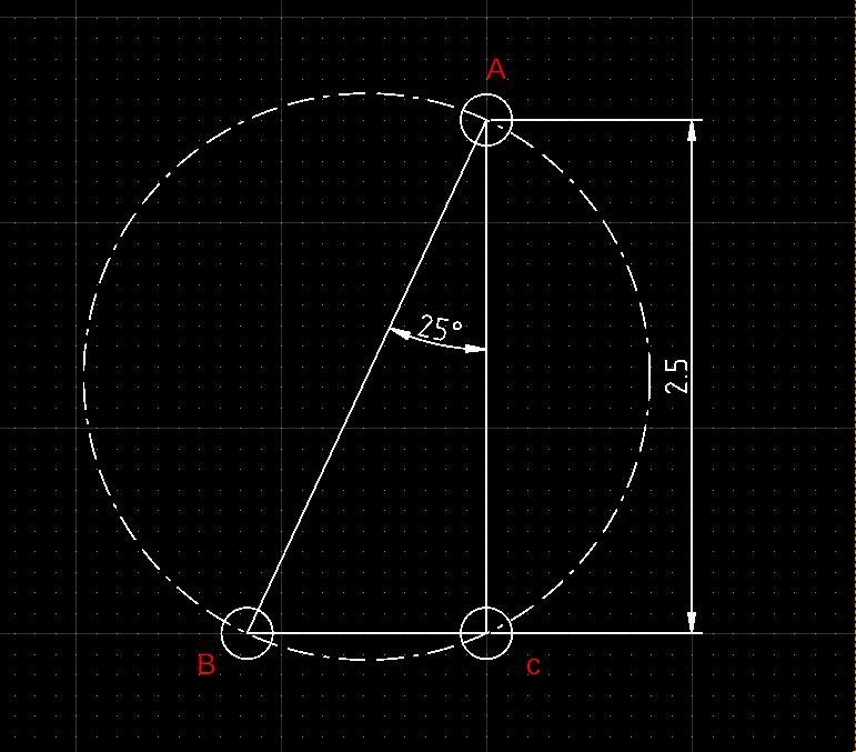

                          Curiously none of my Maths for Engineers books cover this question, not in theory or by providing a formula for 'n' studs. Closest is this question from a Technical School textbook:
                          Three holes A,B and C are to be bored in plate as shown. Calculate the distance between B and C, and the diameter of the pitch circle.
                          Hope the class can all answer this one: the textbook is aimed at 15 year olds. Did anyone go to a UK Technical School? There was one in my home town, but Wikipedia says they were rare beasts. Pity, I thought they were a good idea. Another opportunity missed.
