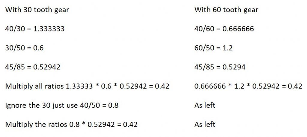

                        What is the leadscrew pitch on yours?
                        That gear train with a 40T on the spindle would give 1.275mm pitch which is about right for 20tpi at 1.27mm if it were 3mm pitch.
                        You could put a 60T in place of the 30T and use lever position C which would give same ratio but the 60T may reach the spindle

                          #318031
                            It's not an idler as changing it to some other tooth count will alter the ratio. I suggested making it a 60 and also selecting position C which will counter the effect of using a 60 instead of a 30, one doubles the ratio and the other halves it so cancelling each other out.

                                  Posted by JasonB on 21/09/2017 17:52:33:
                                  Beg to differ my maths is pretty shoddy but I came up with this:-
                                  It took me ages to get to grips with this, doesn't work if you have a five gear setup so safer to use all the ratios!

                                        yes sorry, 3 in a vertical line makes the middle an idler
