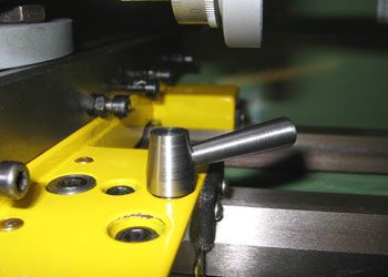

                      I'm sure you have discovered the saddle lock – I replaced mine with a hex head bolt with lever for ease of use rather than move the cross slide to access the recessed cap head bolt
                      #394931
                      Journeyman
                        @journeyman
                        If the built in saddle clamp on the WM180 is similar to my WM250 then it is a fairly mediocre design, or to put it another way it doesn't work! One of the first mods I did on my lathe was to alter the saddle clamp and add a small lever to operate it.
                        Details *** HERE *** nothing too complicated, it could probably be amended to suit the WM180.

                          Same mod on WM180 except tighter clearance – nicely done too
