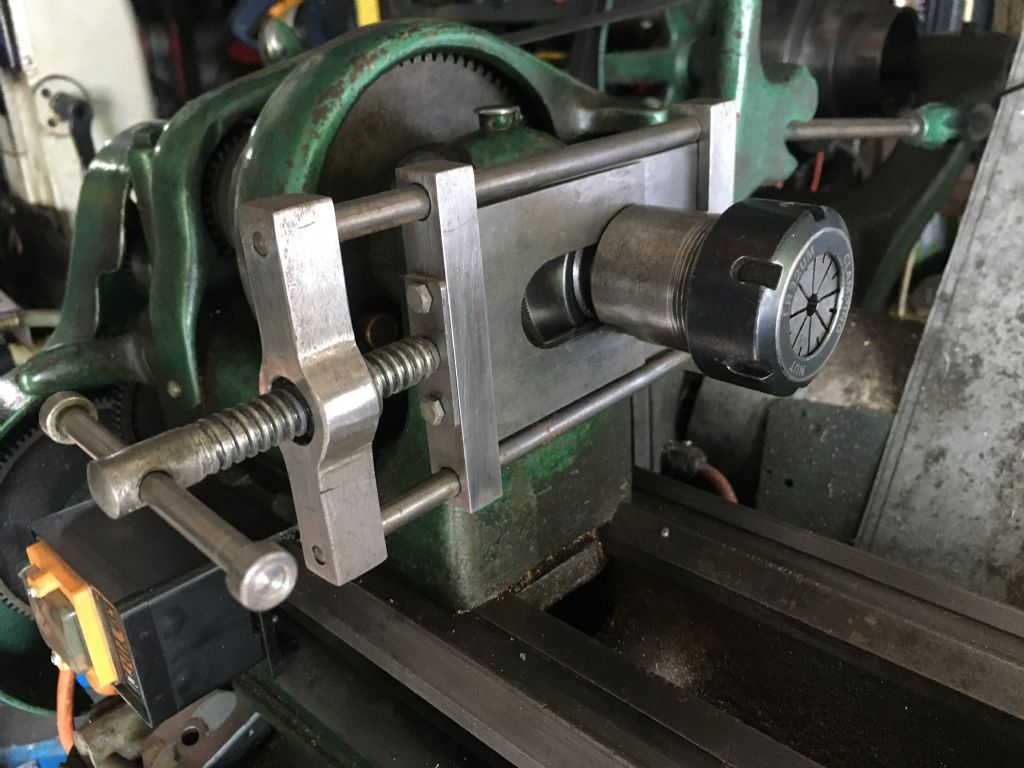

                            My lathe and mill both have a 3MT taper and it normally only requires a slight tap on the end of the drawbar to loosen the tool in the taper. If it is too tight, I use this tool that has opposing wedges.
                            Details can be found in the August, 2015 edition of MEW **LINK**

                              I use a couple of wedges (home made) to wedge out the taper, if more than a reasonable tap with a soft mallet does not remove the MT. I actually have a couple of pairs, for space differences between tools and spindle. Never yet failed me, on my 2MT mills.
                              One important point re tapers is that of not fitting a ‘colder’ taper into a ‘warmer’ socket. After the usual gripping of the joint it will then be ‘shrink-fitted’, as well, as the temperatures equilibrate. That tiny effect will fix the shaft in the socket sufficiently to make extraction more difficult. A very cold taper into a well-warmed machine is a definite recipe for trouble.
