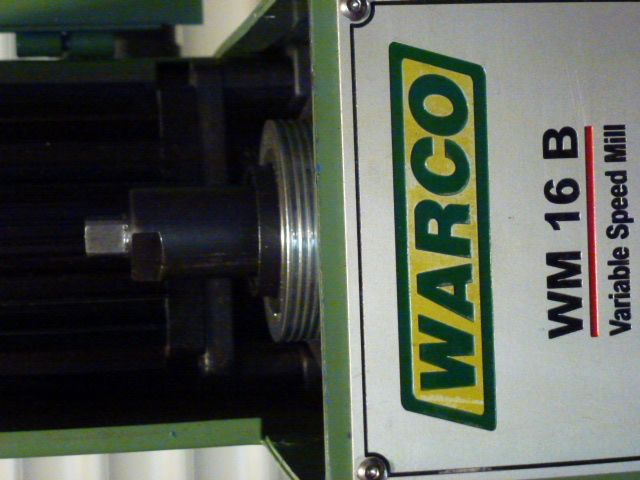

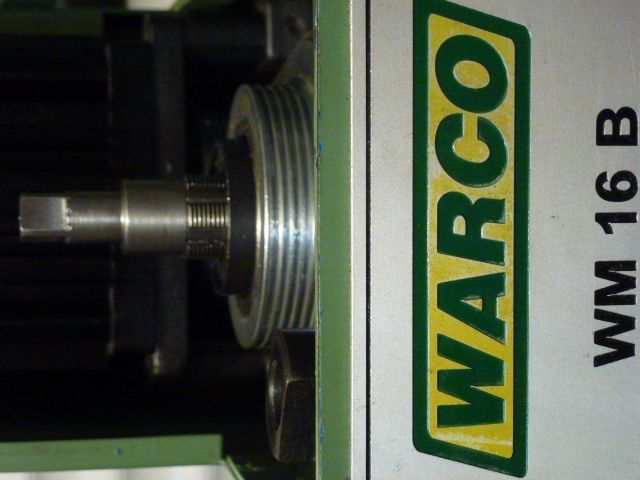

        Had to change the milling chuck for a drill chuck for the first time
        The new Warco produced manual instructions are to loosen the draw bar cover by approximately three to four full turns and then to tap the head of the draw bar with a rubber mallet . Sound easy doesn't it .
        Problem is the top of the draw bar is a 8mm square that projects only a couple of mm above the draw bar cover when it is tightened down. Unscrew the cover and the end of the draw bar is below the surface so nothing to hit,
        Put brain cell in gear. Removed cap and draw bar. Skimmed 4mm from end of cap and similar amount from the collar below the 8mm square of the draw bar
        . Putting it back together results in the 8mm square end of the draw now projecting above the cover. when screwed down . 8mm spanner can now turn the draw bar with the cover still firmly in place . Collar at the top of the draw bar now presses against the inside of the cover and breaks the taper
        Brian .

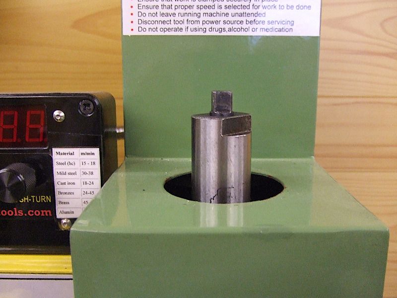

            #517159
            Journeyman
              @journeyman
              Hi Brian, slightly misconstrued your OP, have got it now. Mine looked like this from new with the square nicely visible.

              Clive Brown 1
                @clivebrown1
                The drawbar square on my WM 16B protrudes a full 10mm, so no problem with the self ejection. Sounds as if the upper part of the drawbar could be wrongly dimensioned. A replacement isn't too hard to make, or perhaps just a thick washer between the drawbar and spindle might do the trick, but this would reduce the thread engagement with the MT arbourp1020876.jpgp1020875.jpg Incidentally I find that a 7/16" af hex.socket fits the square nicely, which speeds up tool changing by allowing the use of a ratchet.
