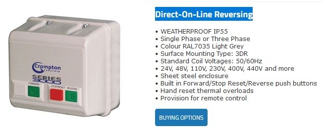

                john swift 1
                  @johnswift1
                  sooner or later you will need to be able to reverse the motor
                  all you need is a reversing direct on line starter
                  the starter contains 2 interlocked contactors
                  PS
                  the starter has  the same NO VOLT RELEASE   found with the more common start / stop direct online starters
                  Edited By john swift 1 on 19/11/2017 20:24:57

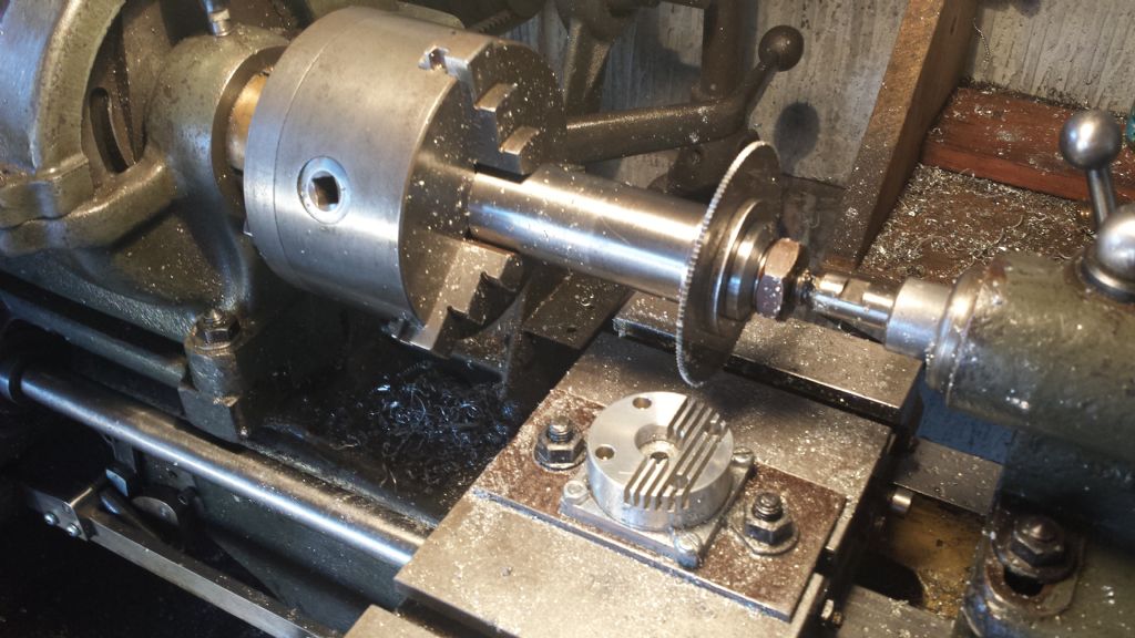

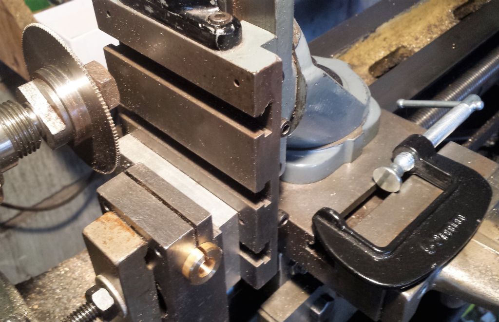

                              geoff walker 1
                                @geoffwalker1
                                cylinder headHi Eug,
                                Simple answer with the dewhurst. Remove the handle, shorten it and then refit. No chance now of switching on accidentally and still plenty of leverage to operate the switch.
                                I would always have a reversing facility as I have no milling machine and require more versatility from the lathe, also an M like yours.
                                These set ups are a slitting saw on a morse taper milling arbour and on an arbour between centres. Reversing the spindle is essential here as when the work is fed forward into the saw via the cross slide you needs to up cut mill rather than down cut mill as would be the case with spindle running forwards.
                                Keep the dewhurst Eug. Just wire it in alonside your NVR

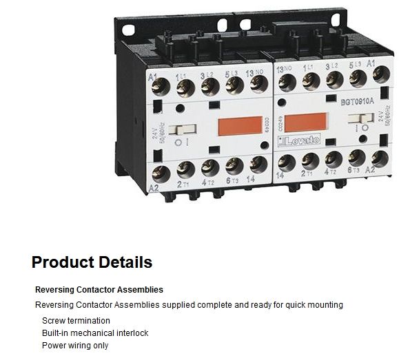

                                                john swift 1
                                                  @johnswift1
                                                  Hi Andrew
                                                  the reversing DOL starters like the one in my 19/11/17 post at 20:15 use a double contactor assembly like this
                                                  it could be incorporated with overload protection inside the machines electrical cabinet instead of the external box
                                                  on 3 phase machines the mechanical interlock makes it safer when you put the motor into reverse to stop the motor quicker !! – both the contactor & motor will have to be rated for this use
                                                  ( I have known the brief application of reverse without stopping as "plugging" )
                                                  with single phase motors you will have to stop the motor before reversing

                                                  Hopper
                                                    @hopper
                                                    Posted by not done it yet on 20/11/2017 06:37:12:
                                                    very rarely ever wished I did….. I even bought a reversing switch and mounted it…
                                                    If that does not indicate indecision or contradiction, I don't know what does! smiley
                                                    Clearly you wished for one enough at some point to go and get one mounted. Not wiring it in might indicate something other than not actually wanting it operational? I sometimes have a problem of "getting round to it".wink
                                                    Yes I need to get one of those "round tuit's".laugh
                                                    Probably will happen when my need for reverse is greater than my reluctance to crawl under the lathe's bench to access the underslung motor and try to figure out the wiring on my Australian-made motor that does not match the terminal lettering/numbering protocol described in all the UK-based literature on how to wire up a lathe reversing switch for a non-capacitor type motor. Probably the next time I need to turn a long metric thread.
                                                    Meanwhile, I do my milling much the same way as Geoff W shows in his pics, but start the cut with the job behind the slitting saw and bring it forward to make the cut.
