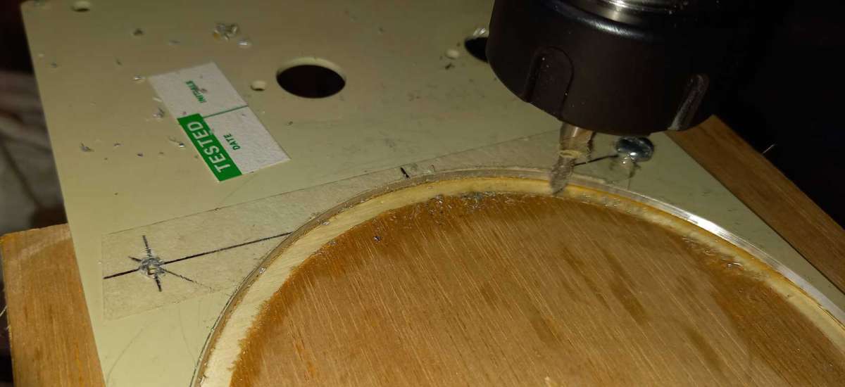

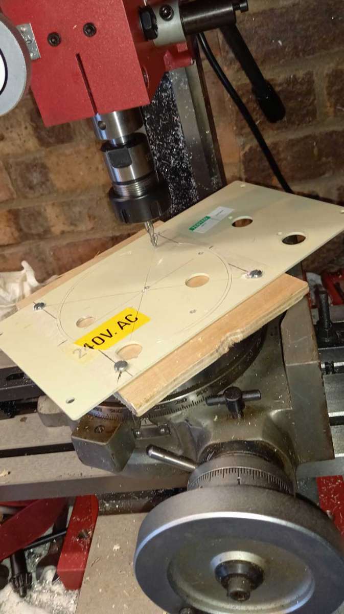

      Bit of a retorical question, but I thought it might be useful information for a prospective purchaser.
      Some years ago, before getting my current mill, I purchased a used Seba 6″ horizontal / vertical rotary table. It was a bargain buy at an amateur radio rally. Fast forward to this week and I need to make a 115mm diameter hole for a cooling fan in a aluminium panel. This is for an electronics project and the panel is from a 4U half rack case that I’m repurposing. Having aquired a mill (from ARC Eurotrade) last year it seems a no brainer to use it and the rotary table to cut the hole. But would the large 6″ table fit on the little SX1-LP mill? And second can I rotate the 240mm x 130mm panel through 360 degrees with the center of the hole offset to one side?
      The answer is yes, I can.
      mill-115mm-3
      mill-115mm-1
      The plate and thin ply backing are held to the table by screws in the fan mounting locations (105mm square) into nut plates in the rotary table T-slots. I made the plates a little long and they fouled the table clamp screws. It was easier to remove the clamps than shorten the plates and re-align everything. The rotary table centerline is on the center of the mill table.  The only problem I had was the aluminium was a bit soft and stuck to the cutter so I used lubricant. I also made the initial cut inside the requred diameter and then finished with a light cut. I need to get a MT2 center to make alignment easier. A good learning experience for me being first use of a rotary table and a lot easier than chain drilling and filing.

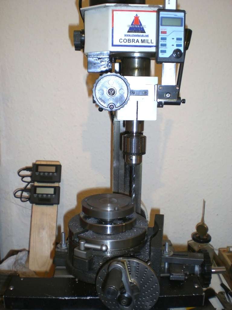

                        Hi, if it’s any help to anyone, I have used my Vertex RT on my Chester Cobra mini mill, the only real restrictions are the height above your work, and the distance from the centre of the table and the column, which on the Cobra is 140mm.
                        Vertex RT on my Cobra Mill
