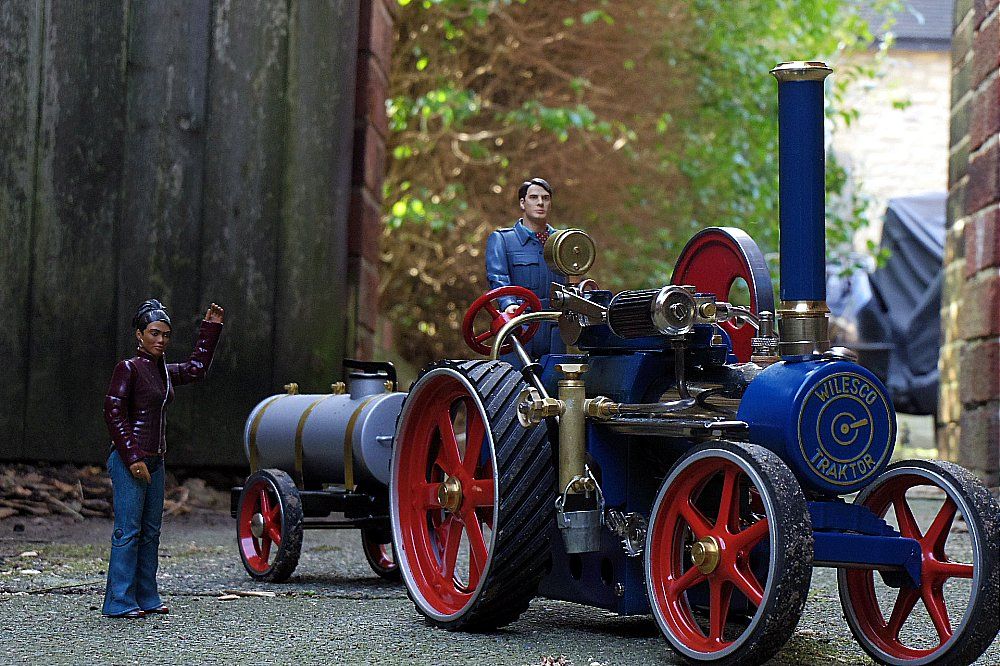

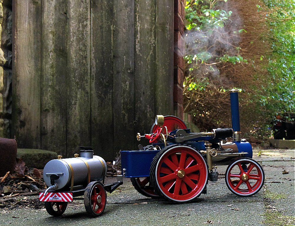

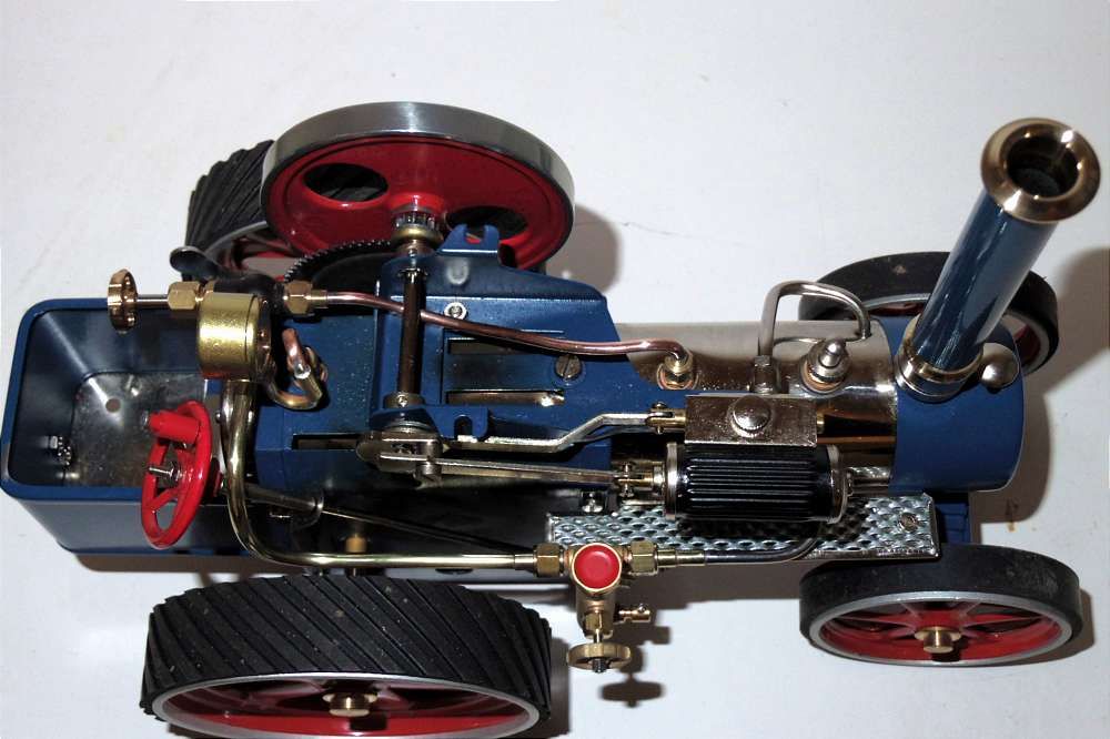

              Wilesco's range of steam toys are the most sophisticated made today and represent good value for money. I have no doubt that you will soon be looking to add to your collection. How about the D18? Or if you like constructing things, the D415?
              It is very easy to modify Wilesco steam toys. Here are some pictures of a D415 I modified.
              In the pictures it is running on gel fuel though now it has a Bix gas burner system which gives a longer run time and is controllable.

                Levent Suberk 1
                  @leventsuberk1
                  Very beautiful mod Henry. Chimney is different. It is very good idea to add figures. Figures are from Dr. Who series?

                            Henry Artist
                              @henryartist43508
                              Posted by Levent Suberk on 15/08/2017 18:11:58:
                              Thank you. face 1
                              Modifications include – different chimney, new axles and hub caps, tyres, pressure gauge with syphon, steam valve and displacement lubricator. Adding a Bix gas burner has definitely improved performance especially when running outdoors.
                              It will now happily trundle along at a scale speed on about 15 – 20psi. It is one of my favourite steam toys and always a pleasure to run.
                              The figures are indeed from the Dr Who series. They are approximately 1/16th scale and are not expensive.
                              I have seen other Wilesco engines where the modifications have been taken much further – even to the point of having something that looks like a scale model of a real traction engine rather than a steam toy.

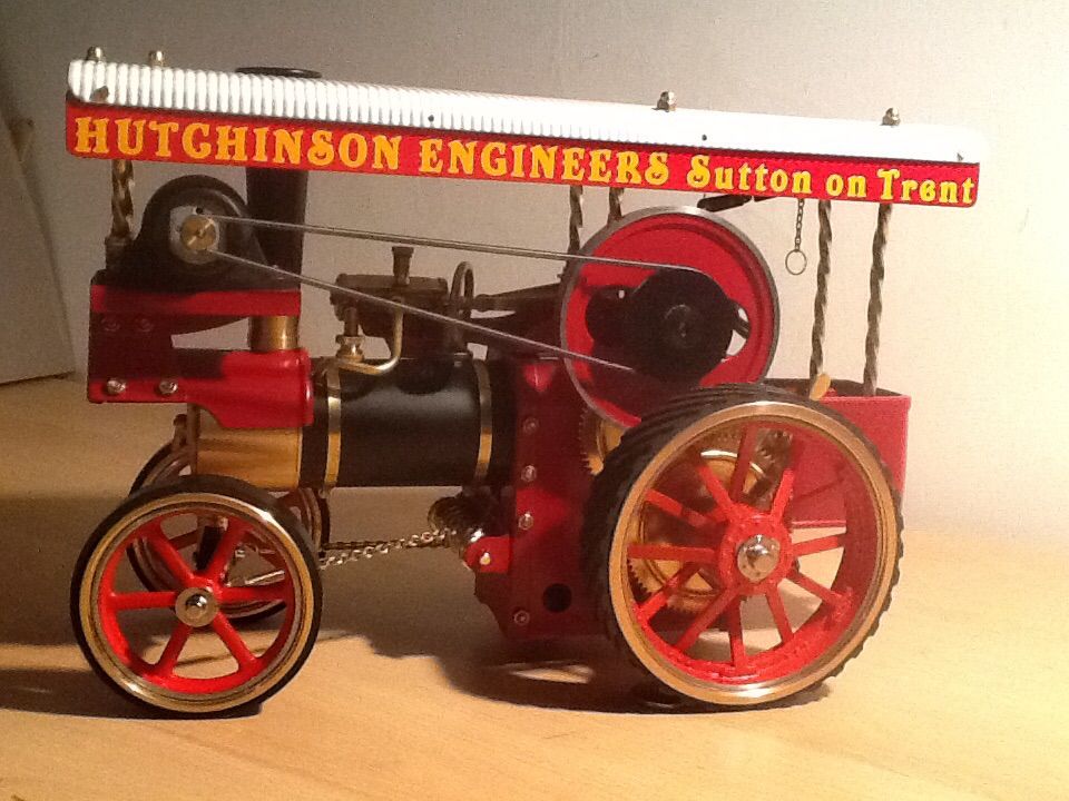

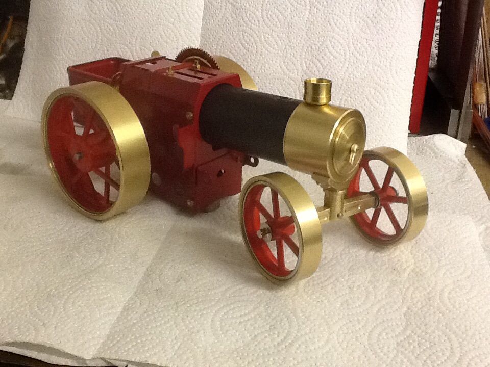

                                That's a nice sweet running little Wilesco engine you've built Levent, the boiler is an attractive looking unit as well. Did you get the little Dynamo from Forest Classics as well? I think it won't be too long before you have built a bit of a collection of them. Any idea which engine your next one might be?
                                The modified engine by Henry also looks good. I like the little pressure guage and displaced lubricator, I wish I had thought of fitting them to this Wilesco D409 Showmans engine I modified a couple of years ago, also from the excellent Forest Classics.
                                Some of the main modifications I made to it were fitting the more realistic and heavier Mamod wheels. I then made the bronze wheel rims, brass twist canopy supports, facia boards, smoke box with door and front axle assembly. After buying it and then modifying it I then gave it away as a gift for someone's 60 th birthday.
