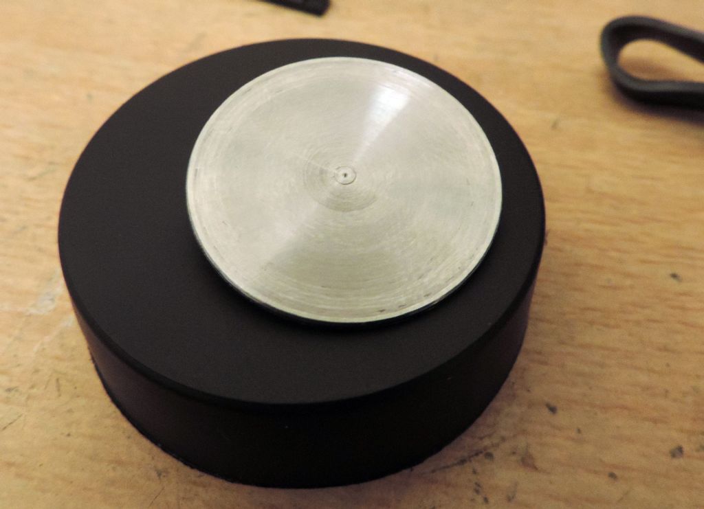

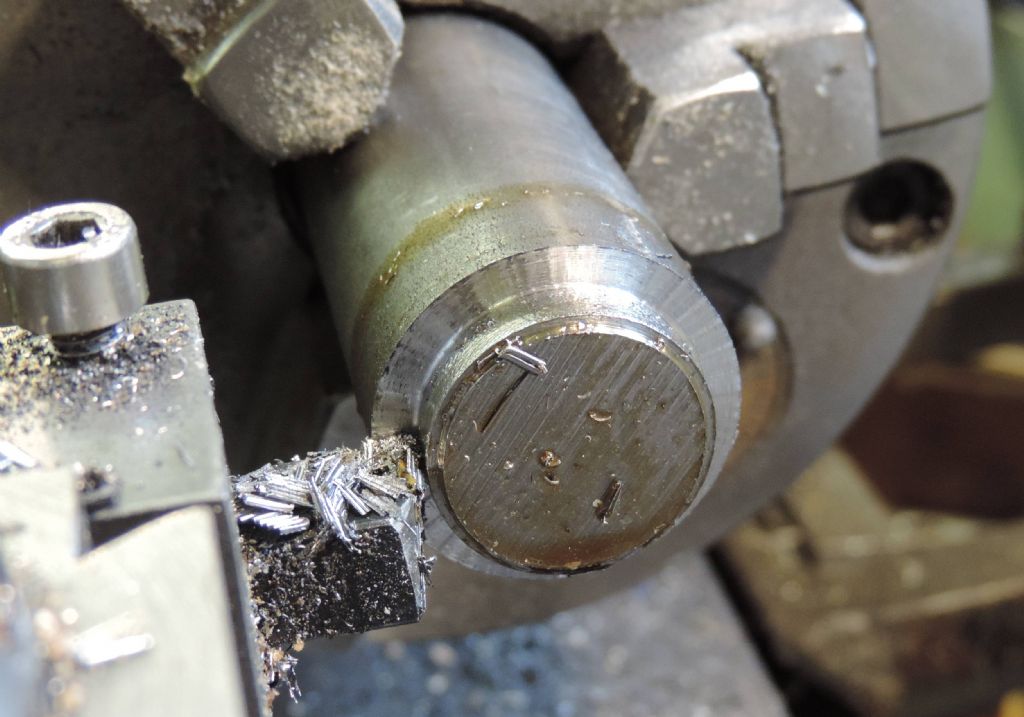

                                    In my experience, the things that make the biggest difference when parting are:
                                    • Well-adjusted lathe.
                                    • Sharp tool set on centre height.
                                    • Lubrication into the cut, by brush is fine.
                                    • Confidence, so that you keep up the feedrate.
                                    Finally, this isn't parting and you can see some chatter, but it shows the sort of DOC (3mm) you can achieve on a mini lathe at modest diameters.

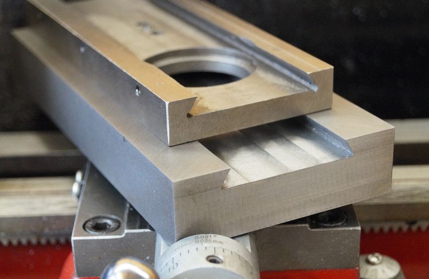

                                                  Ron Laden
                                                    @ronladen17547
                                                    I think one of the failings of the small mini lathes is the lack of rigidity of the tool mount/compound slide through to the cross slide, you can see in the video the amount of flex at the tool post.
                                                    My CJ18 mini lathe was a bit of a nightmare when parting off, it depended on the job it was sort of ok with not too heavy or deep cuts in aluminium but parting steel was always a problem.
                                                    I went down the rear tool post route which transformed it and made parting off a pleasure to do, it did mean however making a heavier duty cast iron cross slide with T slots and a 50mm square steel tool post for the parting tool. Obviously a fairly serious mod but it did cure the parting problems and to some degree improved general turning having a heavier cross slide bed.
                                                    Picture below of the original cross slide and the heavier version, not a 5 minute mod but it was worth the effort.
                                                    Ron
