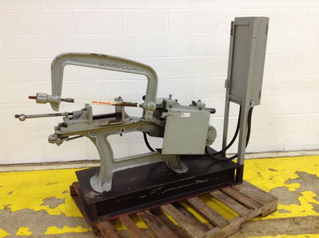

                                                I use a Portaband for cutting metal by hand, both straight and curved cuts, generally on thinner material that does not need to be clamped.
                                                For cutting heavier pieces, I have an inexpensive generic horizontal bandsaw, but it does not cut straight, and it not very reliable.
                                                I wanted a machine that would cut larger pieces unatttended, and something heavy duty enough that it would never stop working or need adjustment.
                                                My solution was to buy a Marvel No.2 draw-cut hacksaw.
                                                I am going to change the motor from 3-phase to 1-phase (I don't want to use a phase converter or VFD).
                                                There is a video of someone online that has the exact model, and he rebuilds it, so that will be a great help with changing the motor. I am missing a few tensioning parts, but I can fabricate those.
                                                The cost was $400, and about 2/3 more for shipping, but I think it will work out well, and it does not seem to have much wear and tear on it.
                                                I will post some photos in a minute.
                                                I don't know this individual, but he does a good job on rebuilding his Marvel.
                                                He is what we call in these parts a "Good ole boy", but he has talent.
                                                The part of the video at 4:37 makes one want to yell "Just Say No to Crack !!".

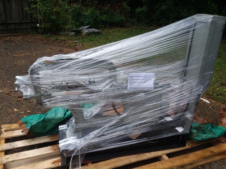

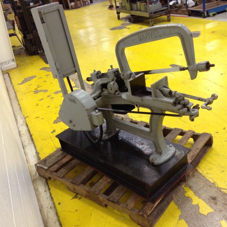

                                                  Here is the saw I purchased.
                                                  It does turn off automatically.
                                                  The lever on the front has been sheared off so I will have to cast a new one in gray iron.
                                                  It seems to be rather a beast of a saw, but I often cut up large pieces of gray iron scrap to use for the foundry.
                                                  Edited By PatJ on 17/03/2019 23:00:12
