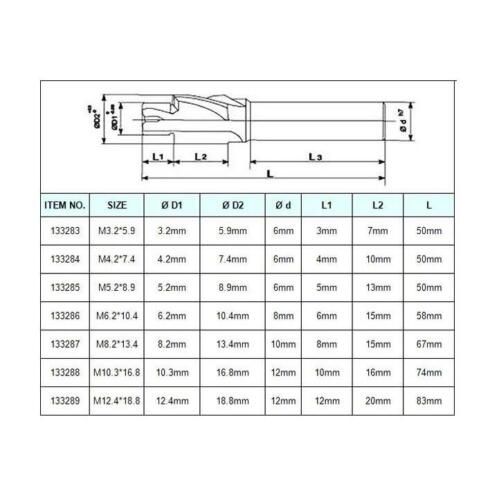

                                          Bill Phinn
                                            @billphinn90025
                                            Many thanks for the further replies.
                                            My counterbores are branded SWT, made by a big company in Xinan, China. They’re sold by many sellers on eBay, which is where I acquired my set of M3-M12. The dimensions chart I’ve posted clearly shows they’re sold as metric.
                                            I had already seen the Engineer’s Bible pages showing the many different standards for counterbores. It confirmed my perception that standard metric counterbores are very oversized for the fasteners they’re intended for. I’d not read the Unbrako pages before today [and they do look interesting], but I was aware that the Unbrako name was acquired a few years ago by an Indian company called Deepak Fasteners Ltd.
                                            I was surprised to read in my 17th edition of Machinery’s Handbook that “Counterbores for screw holes are generally made in sets. Each set consists of three counterbores: one with the body the size of the screw head and the pilot the size of the hole to admit the body of the screw; one with the body the size of the head of the screw and the pilot the size of the tap drill; and the third with the body the size of the body of the screw and the pilot the size of tap drill”.
                                            I’m sure I’ve never seen counterbores sold that way.
                                            I wasn’t aware of the existence of shim washers. Their dimensions fit the bill but a casual search suggests they're rather pricey.
                                            I remain forlornly hopeful that manufacturers of metric counterbores and reduced diameter washers will see sense some time soon and start producing both with smaller diameters that more closely correspond with the real-world dimensions of metric cap screws.

                                                Not seen the last of the three but YG-1 list fine and medium screw hole as well as tapping size, all with the same 15mm for M8 heads
                                                I suppose it makes sense as if the head hole was tight there would be little point in having the screw hole larger as the head would not be able to wobble about if there was no room around it. If you were using aircraft type counterbores then one 15mm would be needed and just swap pilots as needed to suite the clearance hole.
                                                Don't know what standard those ones in the chart are made to but at least your washers are made and available at 12 or 13mm dia for M8.
