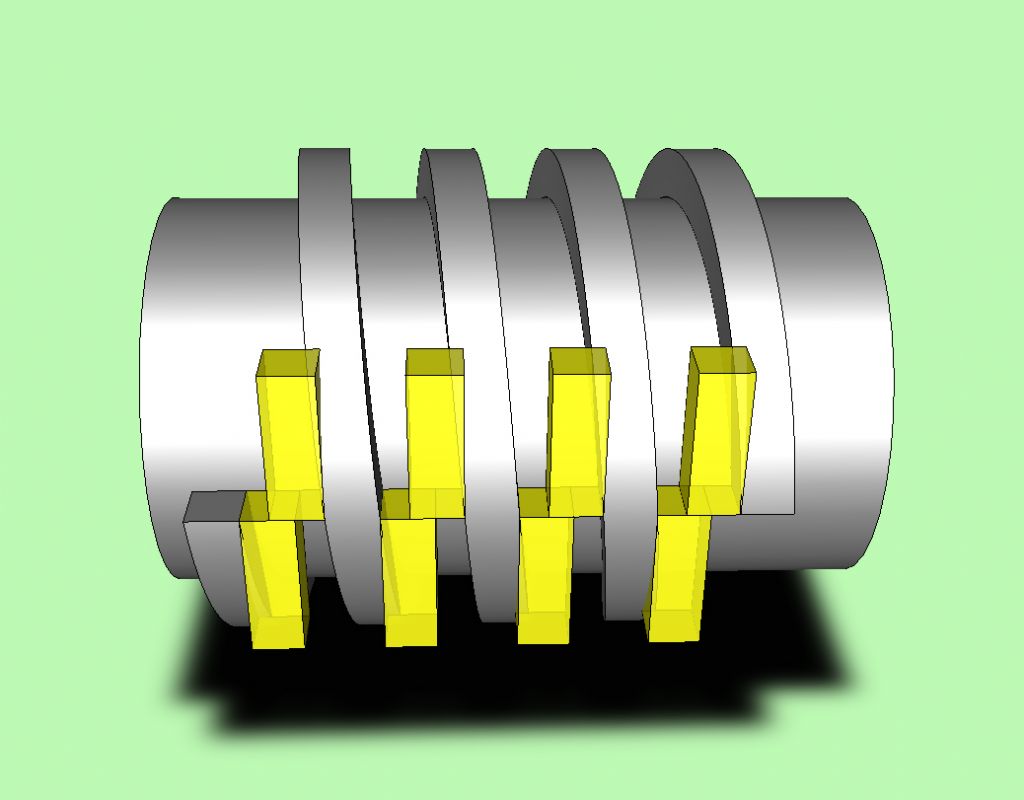

                              Sam Stones
                                @samstones42903
                                With a square thread, the (lathe) split nut would not engage nor disengage without interference.
                                This results from undercuts in both nut halves formed by the root diameter of the helix.
                                It’s the same with split moulds for plastics and die-casting etc.
                                I tried to illustrate this but I can’t work out (in my CAD package), how to subtract the yellow bits from the thread flanks. The helical section of the thread is somehow locked in as a single entity, and refuses to cooperate.
                                Sorry, but you'll need to imagine which part of the thread is interfering.
                                Buttress threads are highly recommended for plastics caps and closures. With a near perpendicular flank, they produce lower lateral forces, and improve cap/closure retention. The same interference issue applies to this face as that for a square thread.
                                Sam
                                Edited By Sam Stones on 04/12/2017 01:24:23
