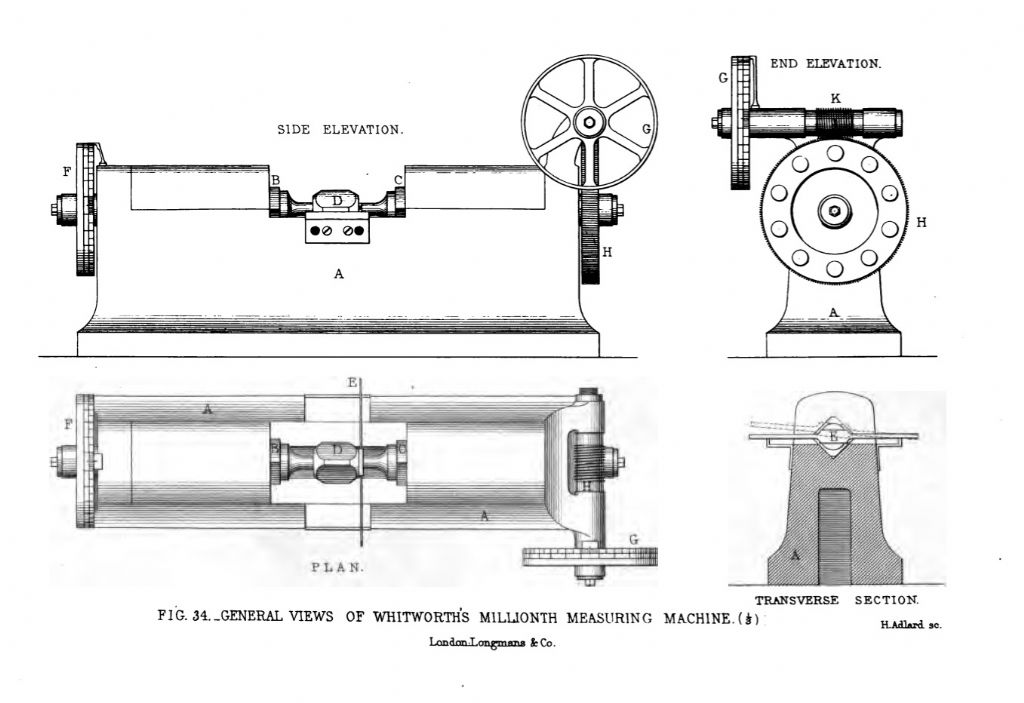

      1. Whitworth’s micrometer made in 1859 has a 250 division on the hand wheel, which when turned will move the anvils 1/4,000 of an inch thus one division is 1 millionth of an inch. Presumably this was via a differential screw with pitches sleightly different. The closest i have got is 0.95 millionth using a 40 and 41 tpi.
      Does anybody know the exact numbers? In addition how was he able to cut threads with the extreme accuracy needed for this device which he produced in serious numbers.
      2 ) The standard meter was required and the French parliament commisioned a survey to find the exact length.. This was to be defined as 40 millionth of a global meridian It was decided to work on a 1/4 meridian from the North Pole to the equator, about 1000 klm long running from Dunkirk to Barcelona which would be surveyed using the French Toise( about 6 ft long). The survey was carried out over 6 years ( during the Terror). By Merchain and Delambre and the results were announced in April 1799 it came out as 5,130,704 Toise which divided to 0.5130740 Toise, for a metre. A platinum bar was cast ( 25mm x 4 mm section ) to this length and became the standard metre and it still exists . It was later re surveyed and found to be out by 0.2 mm all an epic task.

                      #632984
                        Zan
                        May I suggest you read this: **LINK**
                        https://archive.org/details/whitworthmeasur00whitgoog
                        Meanwhile … this illustration from it should help with your question:
                        Edited By Michael Gilligan on 10/02/2023 21:21:32
                        Edited By Michael Gilligan on 10/02/2023 21:23:07

                            #632996
                            Zan
                              @zan
                              Thanks Peak4 and Michael G this will provide some interesting reading. So Whitworths device was a comparator not a micrometer and used to check the size of 1 inch standards.
                              but I still wonder how the Tois was divided and measured to 7 decimal places at the time to produce the metre standard
