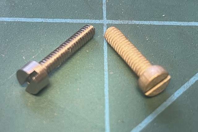

          Coming late to this fascinating thread I’d just like to add a note about actual model making. Please accept my apologies for the further thread drift.
          In the years before 1914 many model locomotives were built using tiny Whitworth threads – specifically 1/16″ and 3/32″ Whit. Screws in these sizes filled the roles occupied by, approximately, 10BA and 6BA nowadays. These sizes went out of use after 1918 and are virtually unobtainable now. Many models have been butchered by forcing BA and other sizes into Whit tapped holes.
          Quite apart from damage, the use of modern screws spoils the appearance of vintage models because head styles are completely different now. Here’s a newly manufactured 3/32″ Whit screw with a comparable 6BA size:

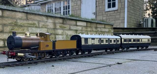

          Many vintage models are handed down to us stripped of fasteners and so I’ve taken to having replicas, like the screw above, made. We are deeply fortunate in UK in having manufacturers still willing, and able, to carry out this kind of speciality work. An example is this little Gauge 2 0-6-0, made before 1914, rebuilt with original screw threads:
          IMG_3529 cp sm
              The best reference I have found for all these obsolete threads is Sidders’ “Guide to World Screw Threads”, still in print today.
              Another Whitworth form oddball from the above book is gas cylinder thread. Unlike BSPT, the gas cylinder threads are perpendicular to the taper rather than the screw axis.
