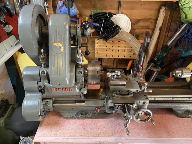

      Hi again everyone,
      I have my lathe at the moment, cleaning it and adjusting it on a chest of drawers.
      but obviously I would like to get something a lot better.
      id obviously like the proper Myford stand, but they are selling these for ridiculous prices.
      would I get away with some riser blocks and a drip tray on the chest of drawers or is this just asking for trouble.
      any help appreciated as always.

          It really needs something more rigid then "just a chest of drawers"
          When you adjust the mounting bolts to correctly set up the lathe bed in accordance with the Myford ML7 Manual, there will likely be some twisting force that a chest of drawers will not resist. That said, when I first had a ML7( 68 years ago) it just sat on a bench and did what I needed at the time.
          Although now unused (I have oher lathes) it sits mounted on a substantial bench, the top of which disguises the fact that underneath there is a large piece of channel girder!

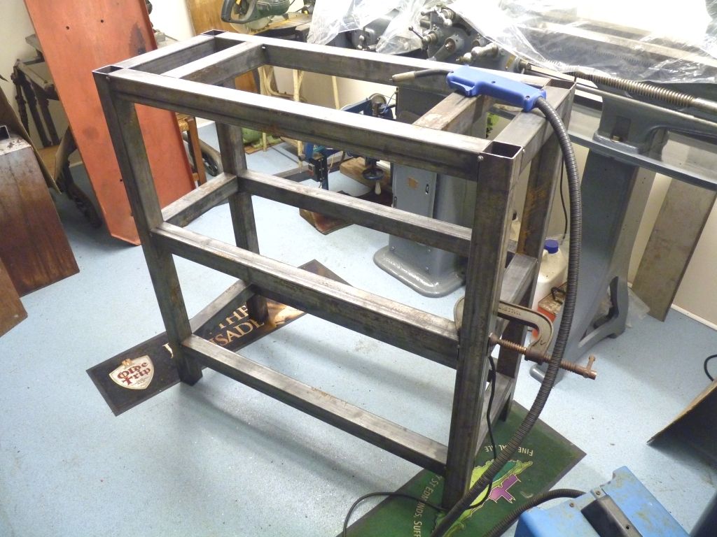

            I made mine, fabricated from RHS (square section tube). There was a lot in the scarp bin at work. The Myford stand might be too low for you, I finished up with 6" square timber under mine, much less backache. Get the cross slide handle level with your navel is about right.
            You can make it deeper front to back as well, the motor sticks out anyway, making it deeper gives more storage space and more stability

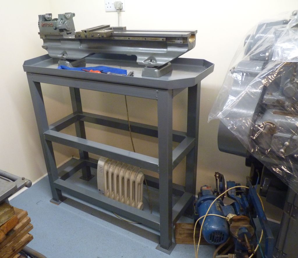

                    When I moved my ML7 into the new workshop, I built a stand from 50mm square steel tubing. The lathe was originally in a spare bedroom on a piece of kitchen worktop on some old kitchen units. It worked fine but I wanted something better in the new shop.
                    I already had riser blocks and an original Myford driptray but I replaced that with a more substantial one that I picked up from a workshop clearance. That one is 3mm steel and very solid. The crosslide handle is at elbow height as has been mentioned which makes using the lathe for long periods quite comfortable.
                    It now has two shelves fitted on the rails which hold all the chucks etc.
                    Edited By John Baguley on 30/05/2022 16:30:45
