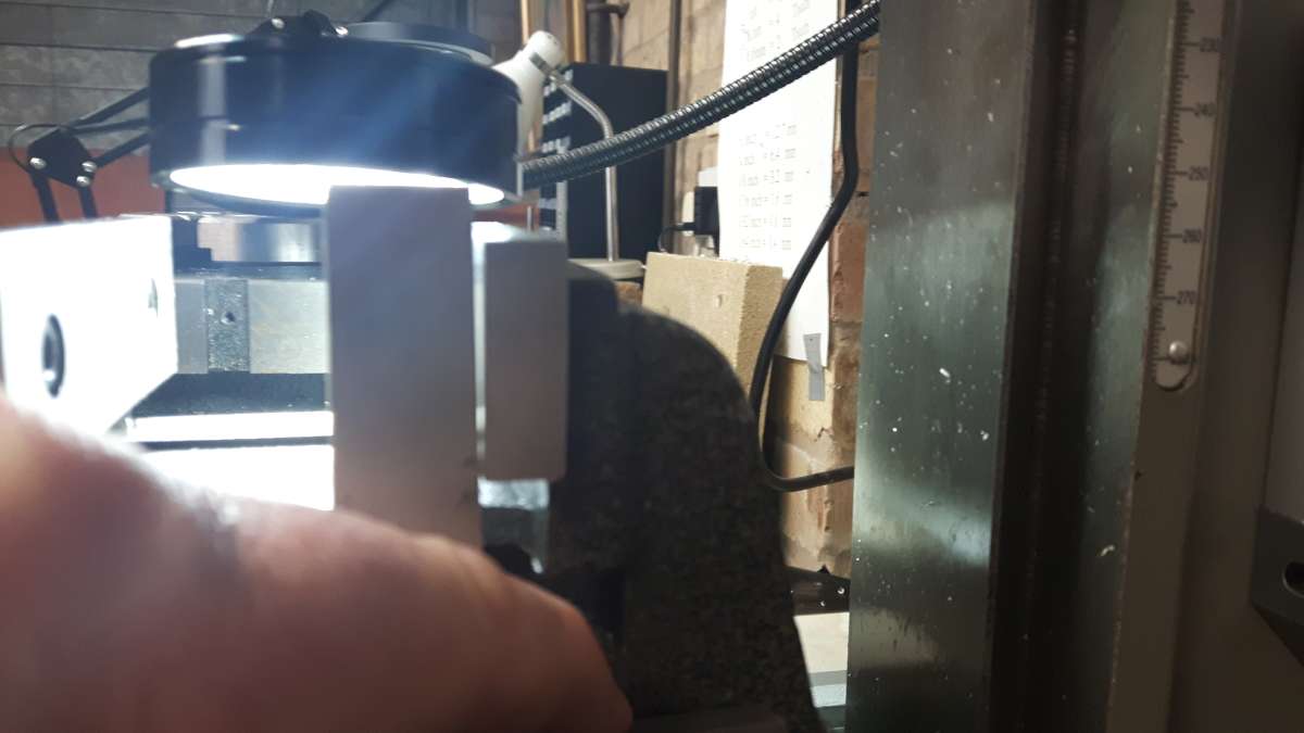

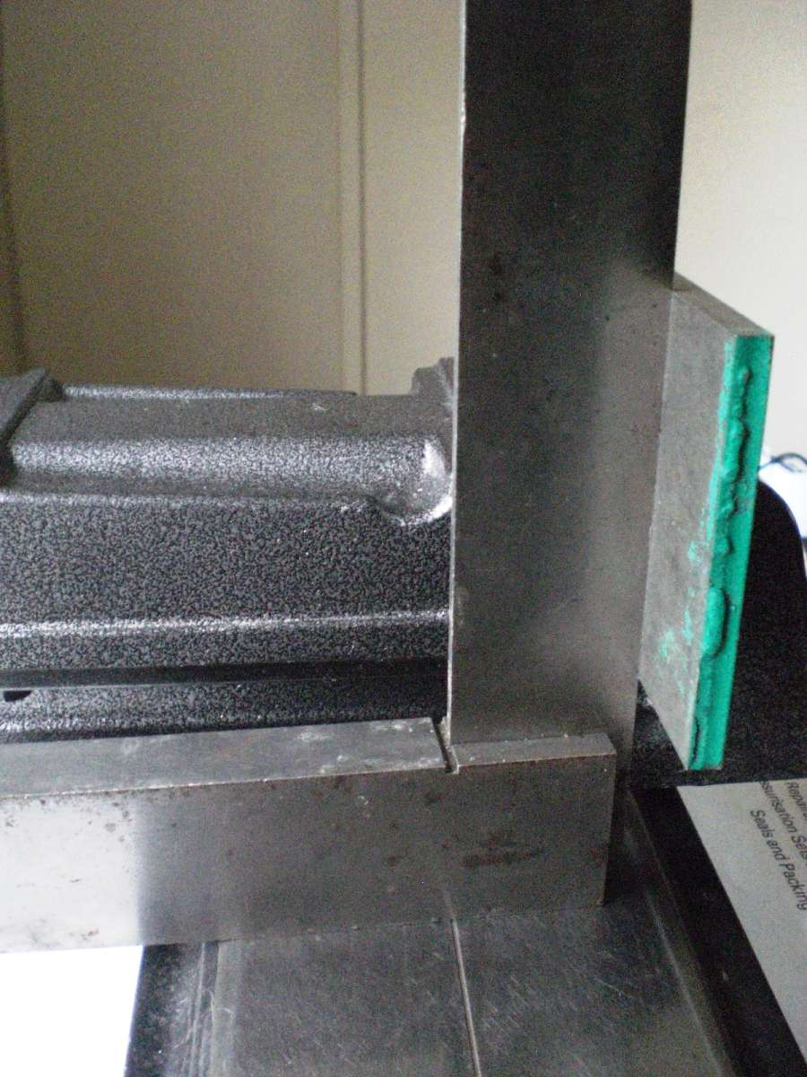

      Hi,
      What would you guys recommend as a good vice for use on a Chester 16VS Mill, I have bought 2 that i thought were good quality (from RDG) but the squareness of them when trying to hold work upto a milling cutter leaves a lot to be desired.
      For example on just a 3inch fly-cut on on square bar the surfaces will be upto 1mm out of square along that 3″ face. i.e. it will have a 1mm slope to it rather than been precisely 90 degrees to the face that helds upto the jaw face. I use a piece of thin rod along one face of the material so i know it’s been held flat against the other jaw face.
      Both the vices I have are screw handle types bolted directly to milling table.
      When I bolt work directly to the table it comes out precisely square, so it is the vice that has the error in it and not the Mill.
      Thanks
      Dave D.

        1mm does sound rather excessive can you post a picture of your setup as there may be something obvious that is not right such as the piece of rod should be against the moving jaw.

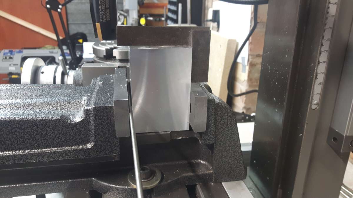

          I always put the rod against the moving jaw to eliminate jaw lift but I don’t think jaw lift is the issue here, i have removed the fix jaw and there is almost 0.1mm difference in the width of the jaw from top to bottom. Just seems not be accurately ground ?
          I have attached a pic to.

            It looks the right setup.
            But 0.1mm lean on a fixed jaw that is say 30mm high should only result in 0.2- 0.3mm over the 3″ workpiece not 1mm?
            What is the moving jaw like? may be worth just swapping them round if it is OK and see what sort of cut you get then you would know it is just the jaw and not the surface the jaw fixes to adding to the problem.

              Good idea to swap the jaws, so i did that, i measuring the moving jaw first and that one’s spot on, i did a fresh cut with the jaws swapped but still have a 1mm error in the same direction.

                is it possible to check the jaw and also it’s mounting face with your square resting on the mill table? may need to swing the vice round length ways to do it

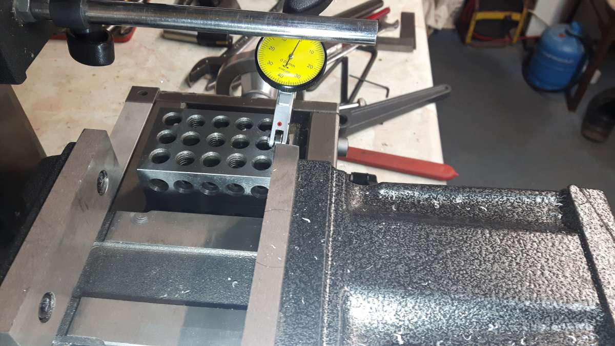

                  I’ve done that, the best I can anyway as the base of the vice is slightly in the way, but as you can see from the pic there is a gap there but the way it is “leaning” should make the error i see in the cuts be the other way round, when viewed using your edited pic with the green arrows on it.
                  Just to prove i’m not going mad i measured a 1-2-3 block using the DRO next to the vice but directly on the table and that shows zero errors.20240403_15531120240403_155524

                    You need to get a DTI involved and do some readings to see if the fixed jaw/work is square to the table. What error do you get running a clock up and down the actual work rear face?
                    Tony
                    #723943
                    David Deaville
                      @daviddeaville66164
                      Running a DTI up and down the fixed jaw i get a error of 0.1mm
                      Running a DTI over the same distance on the works rear face I get zero error.

                        With the tilt to the jaw that your square is showing I would expect the first picture to be showing light under the square at the front of the machine as the angle (if the cut is horizontal) will be less than 90deg.
                        As Tony says if you have a dti mount it on the head and raise that up and down to read difference between top & bottom of the jaw. Then front to back across a freshly flycut surface. That way the angles an dgas can be confirmed with a bit of trig.
                        I assume you are moving the table side to side to make the cut.

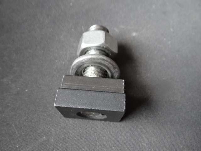

                                      Is it possible the vice isn’t clamped to the table properly because a BOLT is screwed into the t-nut?  If the bolt bottoms before the vice is fully clamped it and the work can move under cutting pressure, which might explain the peculiar results – the vice is fine, but it can move!
                                      jack
                                      Bolts are considered bad practice because they can bottom out on the table and apply enough up pressure to break the T-Slot.  A stud into the t-nut, plus a top nut gives a reliable clamp and is much safer:

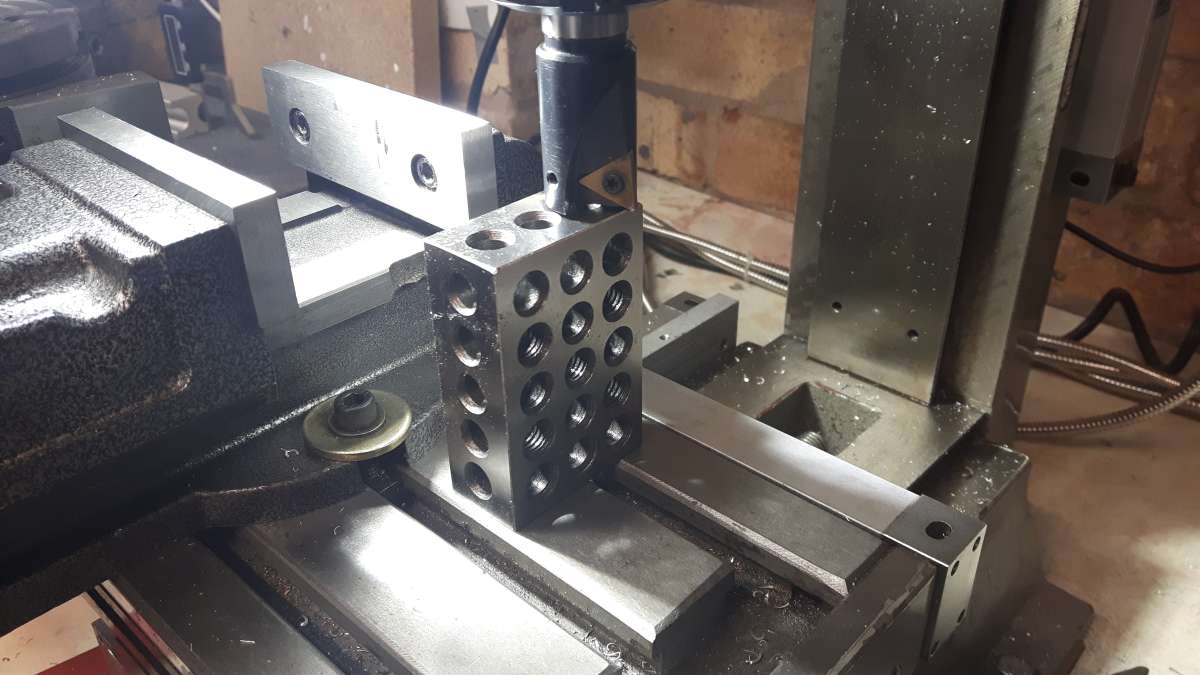

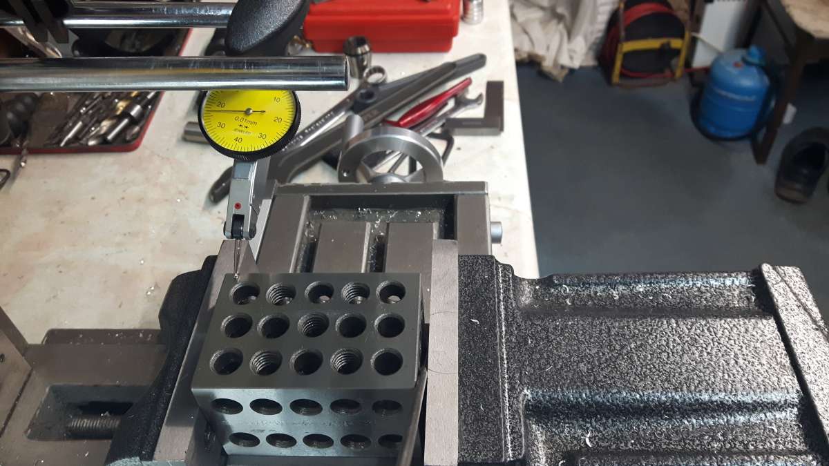

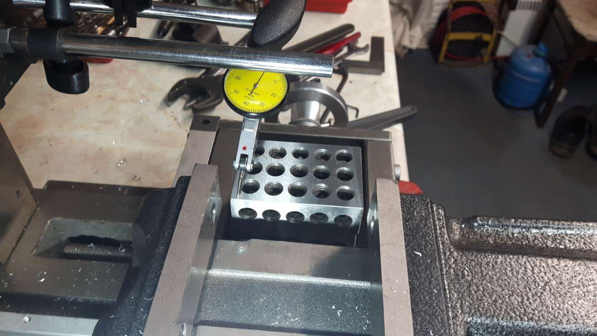

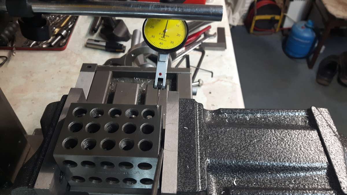

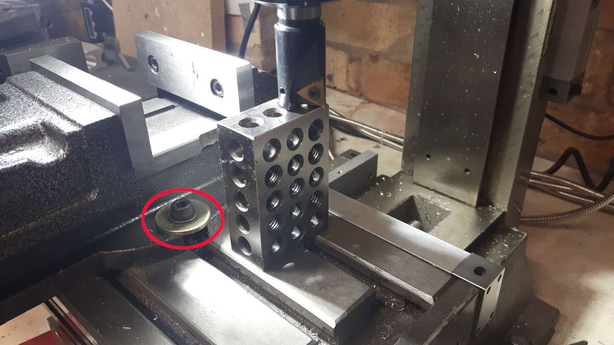

                                        Well whatever’s going on here i think the following 4 pics prove its the vice at fault ?20240403_17165420240403_17171620240403_17185020240403_171911

                                          @daviddeaville66164
                                          The cap head bolts dont go all the way through the T-Nuts. It’s very tightly clamped down to.

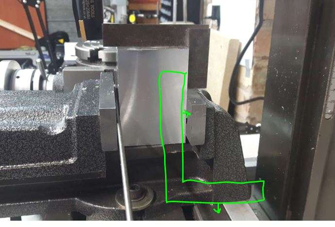

                                            You have a large mass of iron overhanging the front of the mill table. If there is any slack in the dovetails it may lift the far side of the table. Try rotating the vice 90° on the table and see what happens. Try putting a dti on the near edge of the table and see if you can lift it with the vice hanging off it. Look at the back of the table to see if there is a gap between the table and the saddle or between the saddle and the base.
                                            Martin C
                                            #723997
                                              If the weight of the vice is tilting the table why does the table clock zero run out? The 123 block is getting higher the further it goes to the moving jaw which is the opposite of what it would do if the weight of the vice were pulling it down.
                                              First two pics show 0.22mm which is close to what I said it would be if jaws were 0.1mm out, don’t know where the original 1mm comes from
                                              Send the photos to RDG and ask them to send a replacement.

                                                Hi, The original 1mm is shown in the very first photo, the distance between the end of the Square and the top of the work piece is 1mm.

                                                    Nicholas Farr
                                                      @nicholasfarr14254
                                                      Hi David, you should take those two blocks out, and test the surface of the vice they are sitting on, to get a true reading, as the blocks can give you cumulative errors. measuring the vice surface will tell you directly if it’s sloping up/down, one way or the other, with respect to the table, assuming the table itself isn’t sloping, with respect to your cutting tool. Looking at the photo with your block, and showing a gap at the top of the vice jaw, it looks as if your vice is high at the tightening, end which may mean the base and the surface at the bottom of the jaws, might be slightly tapered.
