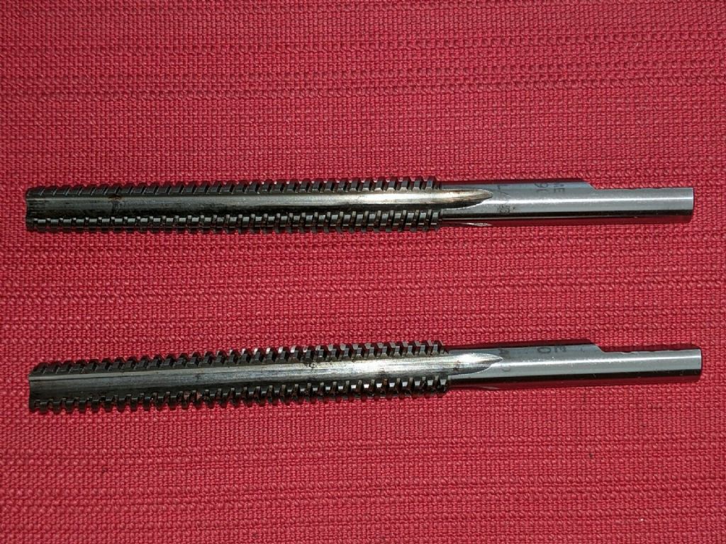

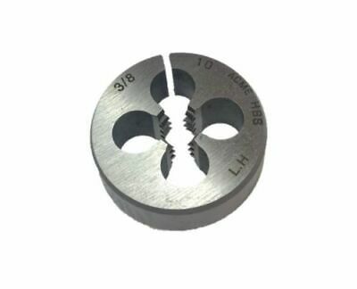

                      Doing some more digging there are some synthetic greases on the market which are loaded with PTFE particles specially made for "power screws". I saw this on the lead screws used for x-y tables for DRO milling
                      FYI the pitch on these is generally 2mm but it can have 4 starts giving a lead of 8mm – impressive precision from EB
                      I came by some 3ft lengths of 1,5 bsw threaded rod cw full nuts. I had in mind to make a screw press (like a cider press)
                      then I did some digging and discovered how little force you got for your effort . You could lose up to 70% of force due to friction from the threads, which is why acme threads were invented
                      Then I thought – its easy to make an acme threaded rod – but what about the nut?
                      3/8" x 10 tpi LH acme die from a well known supplier (but he doesnt offer the tap to go with it) – cant have punters making their own nuts
                      Now here's a rare sight 1/2" acme 10 tpi3-8 acme die.jpg
                      LH of course from EB £10 2u
