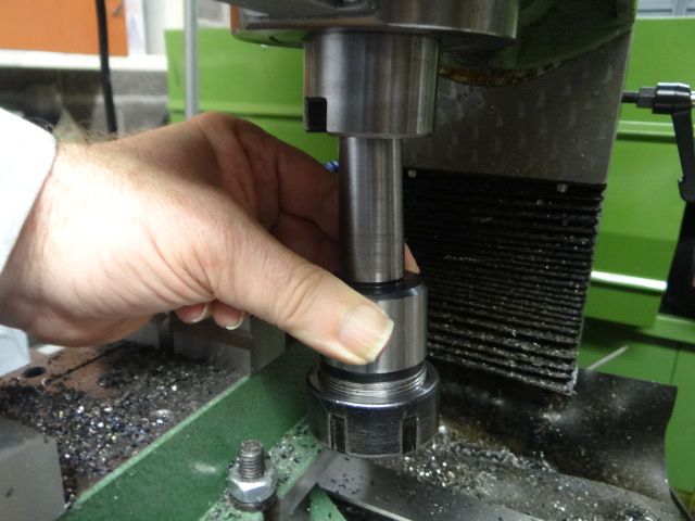

      Sooo, my mini mill says the arbor is MT#2 and I bought an MT2 22mm arbor but doesn't match – the quill(?) is far too long and has threaded end http://www.arceurotrade.co.uk/Catalogue/Cutting-Tools/Slitting-Saws-and-Arbors/MT2-Stub-Milling-Arbor-22mm
      I am probably having a senior moment – can anyone offer advice please?

                          @Vic – yes, I did intend to buy the slitting saw version – I bought the blades at the same time

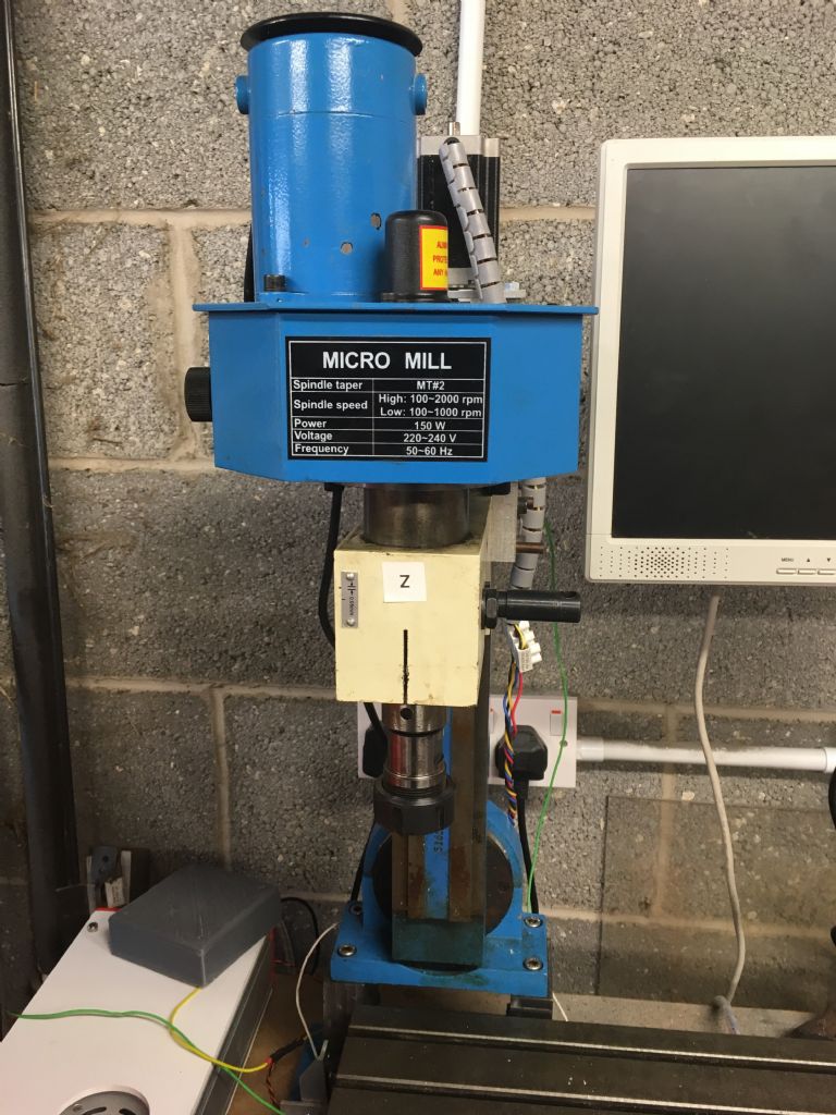

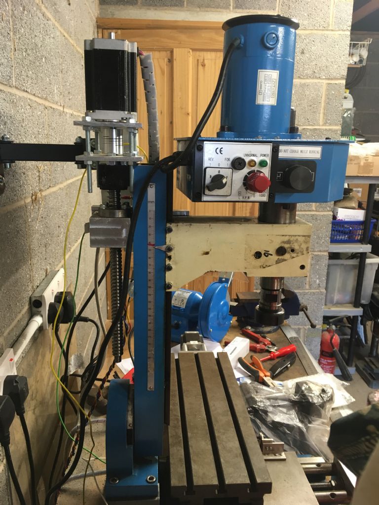

                          Here's the puppy – looks like there is an MT2 already fitted? which begs the question of how to remove it please – and yes, an idiots guide is recommended The good news is that I am a quick learner so it's not forever though it may feel like it for a while

                          #307380
                            On the top of the mill head is a black cylinder about the size of an old 35mm film container with a red/yellow sticker on it
                            Pull that off and it will reveal teh hexagonal end of teh brawbar.
                            Hold the collet chuck that is in the spindle with one hand and use a spanner to loosen the drawbar about 1/2 a turn, may need a spanner on the collet flats if it is tight
                            Take a copper hammer or put something ontop of teh drawbar nut and give it a blow with the hammer which will break the grip of the taper.
                            You can now fully undo the drawbar while holding the collet so it won't drop and out it will come.
                            To fit new arbor push it up into teh spindle so it just grips and then screw in the drawbar and tighten.

                                looks like a Sieg SX1L as supplied by Arc Euro (tho they state the long table SX1L is exclusive to them – their ‘house’ colour is red) but later fitted with the stepper motors to drive the head and table using what looks like ball races (rather expensive mod which if fitted to the table requires John Stevenson style ‘butchery’ -as described in a thread on this forum some time ago – may be it got a repaint at the same time

                                            Its a fairly generic pattern of its day but the colour says its a Chester UK badged machine they called a Cobra Mill from about 10-12 years ago. I've probably got a spec somewhere. The stepper motors are extras and it seems to have a few standard bits missing or detached.
                                            It is MT2 and it will be an all metric machine in its fittings. The height scale says its an all metric machine on its slideways too.

                                              it looks very heavily modified – the quill control seems to have gone with I assume fine control available via the ball race controlling the head – some extra head room seems to have been added by riser blocks – the quill lock screw has been replaced by a more convenient handle made possible by loss of the quill arm – suspect makes drilling more of a tedious affair tho.
                                              using a ER25 collet avoids some of the time wasting head movements but a collection of stub drills will be found very useful!
                                              The early drives had a somewhat of a reputation for burn out if overloaded – possibly a later design of control board is used – the high-low speed control is also somewhat of a kludge there is a Graham Meek mod that seems to correct this (tho not sure where this is now published) – tramming the head is somewhat of a bind so avoid angling the head unless totally necessary

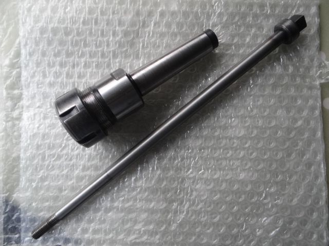

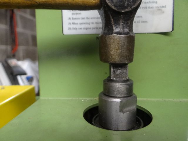

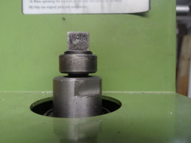

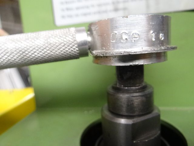

                                                Whilst waiting for paint to dry I took a few photos:
                                                1. The top-hat removed to show the drawbar.
                                                2. Spanners used to slacken (not remove) the drawbar:
                                                3. Slacken 1 turn or so:
                                                4. Use a copper headed hammer or something like this to protect the nut:
                                                5. Sharp Tap with a hammer to release the MT taper below. (Aluminium buffer tool not shown because I only have 2 hands.):
                                                6. Unscrew the drawbar by hand whilst holding the MT tool. The tool, in this case a collet chuck, drops out of the spindle.
                                                7. Normally the drawbar stays with the mill but this is what it looks like removed:
                                                The drawbar screws into the taper end of the MT tool and pulls the taper into the spindle. Nip the drawbar just tight enough to hold the tool. Gently does it, if over-tightened the tool is difficult to remove and you may damage the thread doing it.
                                                The pictures just confirm what the others have been saying. If taking the top-hat off as shown in Photo 1 doesn't reveal a nut, you may have a self-ejecting drawbar. I don't know how they work: don't hit it with a hammer, ask again! Someone else will help.
                                                #307483
                                                  Posted by Hopper on 16/07/2017 13:05:51:
                                                  Sooooo…… if you haven't yet managed to take the original collet chuck out of the mill spindle, how do you know the new slitting saw arbor will not fit???
                                                  Sounds like Andy was trying to put the MT2 arbor into the collet chuck
