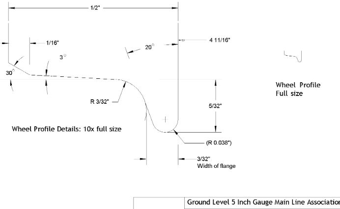

      As above, I have four 16 mm thick billets machined up with axle hole bored true to face.

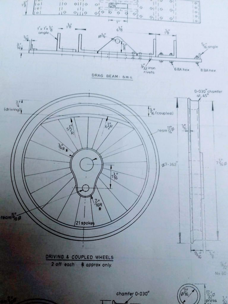

      I started to think about final dimensions and pulled up this drawing. AALS standards, whatever they are. My question was about the back taper 0 – 8 degress being a bit open ended. Then I pulled up a wheel drawing from a mag,for an Atlantic and found it to be quite different, only 9/16 thick including a 1/16? thick flange. Very different !
      I have done some google and found nothing to help, I am out of control here, lol.
      What should I be doing here ?
      With Thanks
      Pete

          Well it appears that 153 viewers don't know the answer, lol, so I did some more research .smiley
          I found the GL5 standards to add to my confusion ! …………..the.0.038 tip radius made me smile. I was beginning to think that I was over thinking this until I saw that, serius stuff, ……….or maybe I am over thinking it lol
          And then I looked back at the Atlantic details. that 1/16 flange isnt much, but a big radius behind it wth no dimensions or taper………..does it all matter
          Pete

            There is also the SMEE wheel standard, which is detailed in Tubal Cain's workshop handbook, and I think is the same as **LINK**. The profile on your Atlantic drawing doesn't look right. If you want to be adventurous you could use the profile in Dennis Monk's articles in ME some years ago (issue 4189 et seq), but they are a lot more difficult to make.

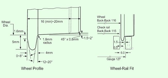

                The AALS (Australian Association of Live Steamers) standards for 5" gauge actually have two options, 16mm wide wheels for models of standard gauge locos and 20mm wide for models of narrow-gauge locos.
                The profile is suitable for running on either 'proper' Vignole section rail or flat bar rail as often used in miniature railways. The wider flange allows for smoother operation through pointwork built for dual 5" and 7-1/4" gauge ground level railways having a common rail, as the flanges on wheels for 7-1/4" gauge stock are wider and the associated flangeways in the points are naturally wider as well, causing narrow wheels on 5" gauge stock to 'fall in' when crossing the flangeway.
                So Paul Kemp is correct in that you need to decide where you are going to run your loco, and make sure the wheel profile you choose is compatible with the track construction it is going to run on.

                  The Atlantic dimensions will be finescale for use on good quality extruded aluminium track. You want fat wheels with the thickest flange that fits the 5g standard keeping the back to back correct in case you run on track with check rails. When running on steel bar track the flange will wear on the square edge of the rail and you want a wide tread to allow for less than perfect track gauge.

                    The Atlantic offering was taken from the series in M.E.March 2010, that was the one that didn't look right to me.
