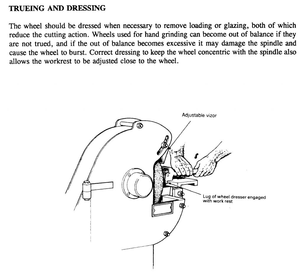

                    Hi, trueing and achieving a flat face on an off hand grinder can be done using a star wheel, using the mthod described by Nigel Parkinson. The star dresser should be dipped in water before and during use, as this will lubricate it and keep it cool and will help keep the dust down. The grinding rest has to be in good order of course.
                    Below is an extract from my abrasive wheel regulations course.
                    Regards Nick
