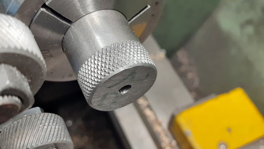

      I have getting used to my new lathe by making a saw arbor for a 0.3mm blade and as far as I am concerned it turned out okay, but now I am making a spring loaded tap follower but the knurling has turned out rubbish, I have a knurling tool clamp type with a screwed knurled nut any suggestions please.
      Thanks Dell

          It's a bit hard to see, but it almost looks a bit lop-sided as if the body of the tool wasn't truly vertical?
          * is it a series of 'V's?
          .a closer picture might help..

            Thats a double or triple pattern with only one knurl doing any work.
            Things to check :-
            Is the material suitable? Anything that has work hardening tendencies will be hard to knurl at home. In general stainless steels can only be reliably and satisfactorily knurled using the cut knurling system.
            Are the knurls sharp?
            Do the knurls spin freely under load?
            Is your knurling tool strong enough to apply enough force to the job and rigid enough to keep the knurls correctly aligned?
            Is your knurling tool set up properly to pinch on the centre line of the job with the knurls aligned with the lathe axis?
            The sample looks as if the knurls are out of line with the lathe axis and the tool is sufficiently flexible to let the ineffective knurl skid sideways.
            Knurling using conventional push knurls is pretty brutal process. Considerable force and rigid tooling is needed if things are to just work. I have a hefty Marlco clamp knurler and ex-industrial machines. Even then the process is not always routine. It's very important tha the forces between the knurls are balanced. If I have issues its generally because I've gotten rush headed and not set things up balanced.
            Although plenty of people have gotten good results from clamp and even push knurling on smaller machines my view is that the three wheel, hand squeezed "nutcracker" type is far more reliable on smaller lathes. Being hand operated you can feel whats going on. Its obvious when things aren't going well.

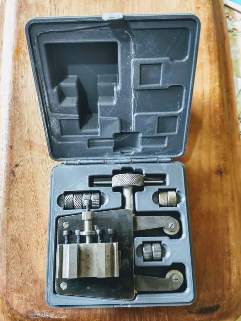

            Here is picture of mine.
            Bought when I was driving SouthBend 9" it instantly solved my knurling woes. The 9" Southbend is sturdy enough to make a decent stab at clamp knurling with a lighter weight tool or even push knurling but it always took a bit of experimenting to get good results. Even then there were failures where the job just point blank refused.

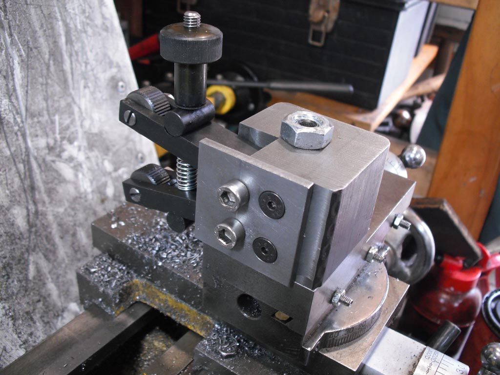

                              This is the one I made, from drawings found I dont remember where on the internet but I think it is the same as the one in MEW issue 72. Those 3mm thick flat side plates stop the arms flexing or wandering, and also form the main frame of the tool so it is very simple to make. I have been very happy with it.
                              The cheap Chinese knurling wheels i used seem to be very good.

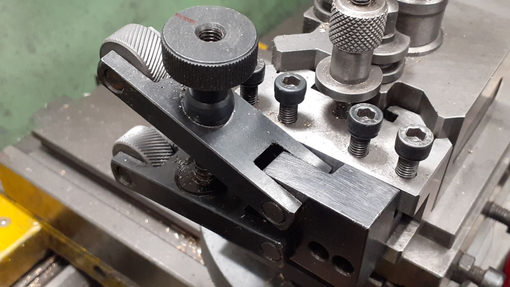

                                    here is a close up picture as requested, also the steel is EN1A so not hard , I had tool on centre of bar, here is a picture of my tool and I did use cutting oil, I have gout in my hands so I probably was not able to turn the knob enough due to lack of grip, I have noticed that even though the tool is new there is some play of the knurling wheels on there shafts, it looks to be the same tool as JasobB is using and his has turned out fine.

                                      Hi Dell, it looks like it is skewing round out of parallel to the work, as suggested by JasonB, or you have not got it parallel in the first place.

                                            Del, yours looks exactly the same as mine. What I do is set the height so both arms are approx at equal angles, just bring the wheels to contact at 12 and 6 oclock then back off and wind the adjusting screw in then advance the tool to ctr or I can just feel it going over ctr. If not deep enough back it out and adjust the screw some more, etc.
                                            That way you are not trying to close the wheels up under load with that small knob

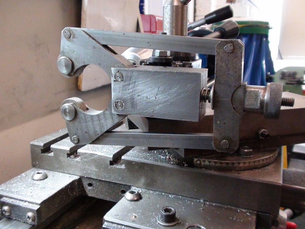

                                              No comment from himself, yet, so I'll post a picture of the one I made to Graham Meek's design, originally published in, I think, Engineering in Miniature. I don't recall where I got the plans from unfortunately.
                                              In my experience, it works extremely well and the added advantages over other designs are the much wider throat to accommodate large diameter workpieces and the provision of flats on the adjusting nut which allows a high degree of pressure to bear on the knurls during operation using a spanner. Although mostly used on brass, I have also used it on BMS to equally good effect.

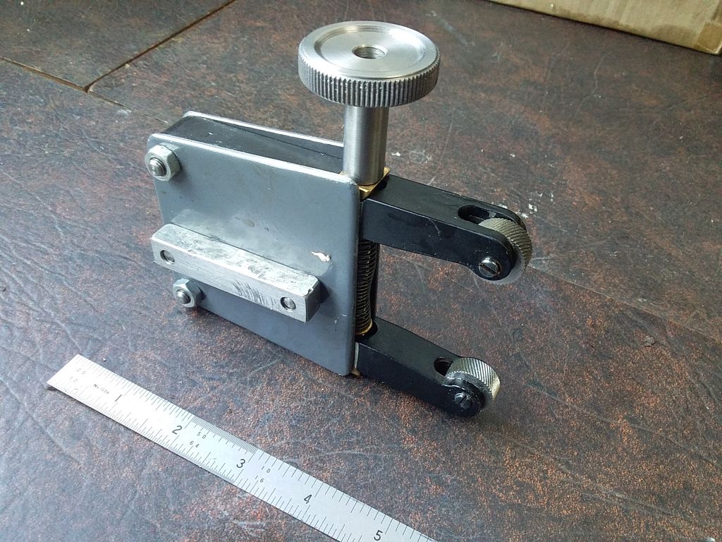

                                                Hopper: That article was the first one I ever submitted for publication .I'm pleased you're happy with it. A couple of people at my club made one, but I had no idea if anyone else had bothered.
                                                I got some different sized knurl wheels but had problems keeping everything together, so designed and 3D printed a fitted case for it all.
                                                Here are the components of the tool.
                                                and an example of what it can do.

                                                  From what I can see in the OP's photograph it would seem the Knurls have been presented to the work in the centre of the diameter to be knurled.
                                                  This is not something I would do.
                                                  I have detailed my method elsewhere on the forum under a similar heading. Perhaps one kind Moderator might provide a link?
                                                  The pattern shown in the workpiece left by the wheels leads me to think the axles are not parallel to the work axis in both the horizontal and vertical planes. (This may be a defect in the tool construction, or mounting). This is a critical requirement with scissors knurling tools. Also critical is the side to side movement of the arms of the knurling tool. Each wheel is fighting to move sideways due to the resultant forces involved. The wheels are no different to a Helical Gear and these need to be paired in a gearbox to cancel out axial forces. Any play in the arms will therefore be exploited by the knurls at the expense of the finished knurling.
                                                  Small diameters usually benefit from straight knurling.
