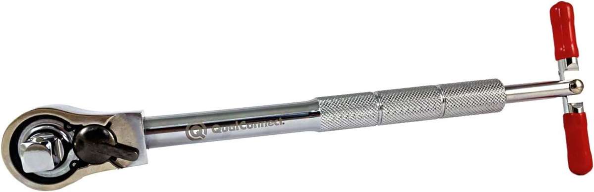

              For future reference, in case anyone searches the forum, another one which works along similar lines is the Qualconnect Sidewinder.
              image_2025-12-28_180833403
              I have a couple, but don’t use them often, though they are handy when space is restricted; Mine are slightly differently branded with a sidewinder snake as the trade mark.
              The head is a bit deeper, but maybe narrower, than the Facom style.
