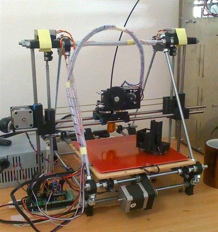

                              Hi All
                              Here is a picture of the Pruasa 3D printer that I am building I am at the stage of getting the flow rate correct.
                              Bob

                                Prusa is the one I’m building. It’s just the (Wade’s) extruder that I need to finish up. The nozzle is done (with its 0.5mm hole!) I now have the piece of PEEK which I need to machine. The PTFE rod is still on order though.
                                I’m in Canada and haven’t managed to source the specified Thermistor. RS in the UK has it but the shipping is prohibitive. I’d like to buy a few in case I want to experiment with extruders. I have found an axial version which I think I can use …. I’d just drill the Thermistor hole all the way through the heater block and bring the leads out both sides.
                                What are you using for electronics?
                                Since you’re farther ahead than me, I might take the liberty of contacting you by PM if I need advice if that’s OK with you?

                                  Hi
                                  Good luck with that — bear in mind that on extrusion you get a shrinkage of at least between 0.3% & 0.6% using ABS. The shrinkage also varies depending upon the depth of the layer and how many times the ABS has previously been extruded and cooled. Shrinkage also varies depending upon additives (including the color) in the particular ABS spec.This means a piece extruded in one colour may not come out exactly the same size if you change color. Shrinkage also varies in the part of a layer that is closest to a previous layer from that that is further away..hence you can usually see & feel the individual layers. ABS is certainly an improvement

                                    PS I should also have mentioned that it is possible for ABS to change dimension with ageing.
