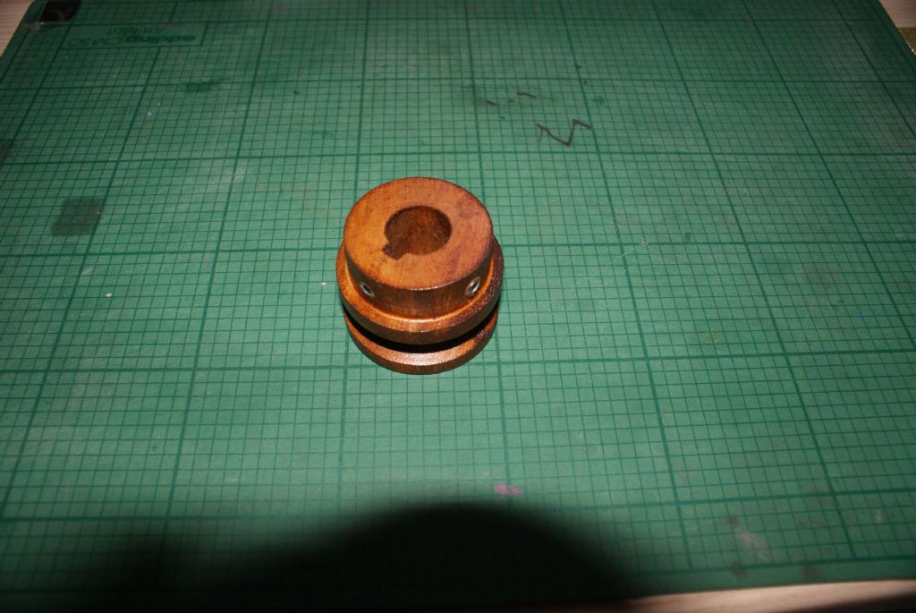

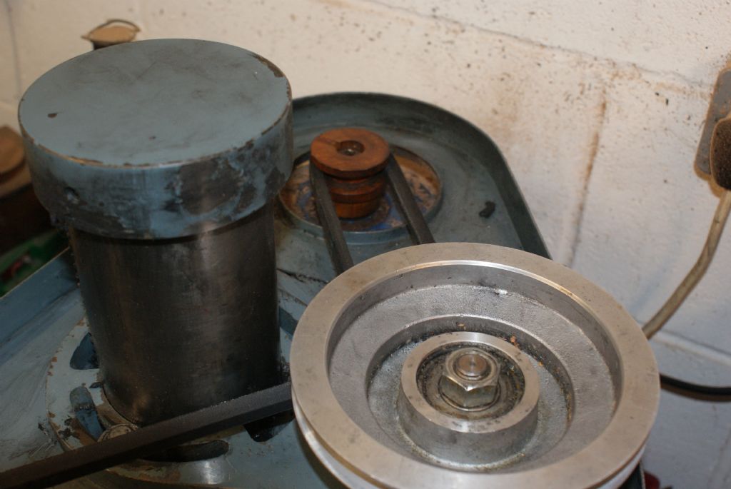

                                            #588251
                                            malcolm hollins
                                              @malcolmhollins96641
                                              dsc04895.jpgChesters and Warco doesn't have any Motor Pulleys Couldn't find any on internet decided to make my own.
                                              Was going to make a single step pulley out of aluminium but Macc Models was closed.
                                              Made a pulley out of Hard Wood .
                                              Mill now works.
                                              Plan to fit a 3 Phase Motor , correct size pulley and a VFD in thefuture.dsc04893.jpg
