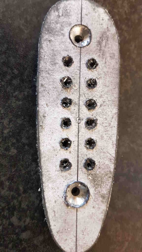

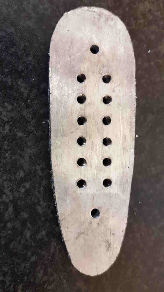

                                        20180726_061123.jpg use double sided carpet tape such as https://www.ebay.co.uk/itm/Rolson-Heavy-Duty-50mm-x-25M-Double-Sided-Carpet-Adhesive-Floor-Rug-Stick-Tape/262842864715?epid=16011027141&hash=item3d32a7d44b:g:iCMAAOSwJtdaAxDX like this and it works well when I cut out oval shapes in Ali it goes through cutting on a bandsaw, 12 tapped holes, 2 countersunk holes and finishing off on an sander and its still suck, so that works for me and it peels off nice and easy when your done as long as you wait for it to cool down.
                                        Martin
