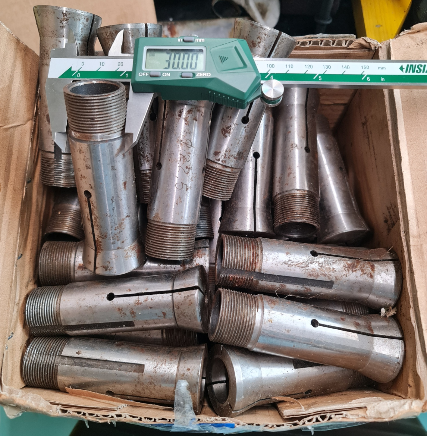

      I found a box with 36 collets at a reasonable price. I was thinking to make an MT5 collet holder for them. But from the seller pictures I didn’t realized how large they are. Anybody knows what kind of collets are this? It is not R8 or 5C.

        Actually is very close to 5C. For example thread diameter is 1.17″ comparing with 1.24″ from 5C. And body diameter is 1.26″ vs 1.24″. But the total length is 4.1″ vs 3 9/32 “. So I think this makes them 5C collets?

          Decent ones normally have the type engraved on the, all my Crawford 4C are marked 4C and CC for Crawford Collet.

            possibly 1AM

              The overall length seems to preclude 5C.
              One possibility, if other dimensions concur, would be to get one of the square or hex 5C collet blocks & nut, then adapt to suit; it could then be used in a 3 or 4 jaw chuck.

                  Mine are indeed very close to 1AM. Or to 5C except the length. Anyway in the end it doesn’t matter. If I will ever use them I will make a collet holder for them.

                    You might find that the thgread on the end is British Standard Brass!
                    I bought some (as part of a kit of Bell Chucks) and found that, when I wanted to make an adaptor for the drawbar to pull them into the holder.
                    The keyway to prevent rotation when tightening is shallow, and probably 3 mm or maybe 1/8″ wide.

                            I failed to find a match in the Crawford catalogue, the thread could be 1 3/16″ or 30mm. Checking the thread pitch might narrow it down.
                            You do have enough to make it worthwhile making a holder, maybe from a steel bar which could be held in a 4 jaw chuck, or part of a plate which could be bolted to a chuck backplate.
                            It was common for markings to be on the nose of collets, it might still be visible on the least used of them.
                            They look like our Smart & Brown 2802 collets on steroids.
