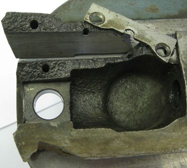

      Hello to all,
      I recently acquired an ALBA 2S shaper, to discover that the ram head dovetails have been smashed. Repair does not seem possible, so I need to machine out the existing and bolt in place a cast iron block into which I can hopeful machine new dovetails.
      It is not easy to obtain Cast iron materials here in Namibia, but seems I can get some continuous cast SG Cast iron. However, from what I understand this Spheroidal Graphite grade iron is not easily machined, and not great for slides.
      I have not found a source for a nice block of grey cast iron, if there is such a thing..I find many grades and specs for both SG cast and grey cast, and have no idea which would be best, or in fact what I am looking at!
      The SG iron I have access to is :
      Ductile iron Grade 400-15
      heat treated so the hardness is between 180 – 200 HB
      Tensile strength is 400 – 425
      Elongation is min 15%
      I have no idea how to compare this in terms of machinability to grey cast iron, some of which seem to have similar specs, eg:

        #304326
          SG cast cast-iron is beautiful to machine (aside from the pervasive dust). The grey colour is due to the precipitated graphite and this also makes it low-friction when rubbing against itself, ideal for slideways.
          It has all the benefits of grey cast iron, but is less brittle. What's not to like?

                            Posted by Joseph Noci 1 on 26/06/2017 18:41:16:
                            Since this is for the vertical slide on the Shaper, the slide does not do as much work as say a lathe slide, but I am not sure that fact guides my choice..What I need is maximum ease of machining, as its quite a lump I have to machine, and my mills are small…
                            Joe
                            If you are talking about the small dovetail slide that you adjust to take a deeper cut etc, you could probably make it out of mild steel, or use a couple strips of mild steel bolted and doweled to the original casting.
                            Photos of what you have and what the damage consists of would be helpful.

                                  As Hopper has suggested, does it need to be cast iron? Reading Joe's other post the cracked dovetail is on the vertical slide, it's not the reciprocating ram, I'd use mild steel. Aren't a lot of these machine parts made of cast iron because you can easily & cheaply produce complicated castings which will just need a few faces cleaning up rather than it's low friction properties?

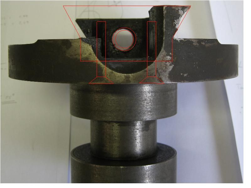

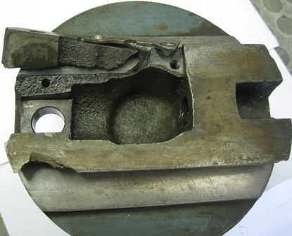

                                      I am pleased that there are other options rather than the cast iron – I am finding it almost impossible to obtain cast iron. 'Cloggs' even suggested Bronze, and I think that's a jolly good idea! I am going to try source a chunk and do it that way – if it does not work I can always try again with cast iron…(!).
                                      I am going to try machine out entirely between the two dovetails, to a depth that is sensible and leaves enough meat on the head, behind the dovetails, and locktite and bolt/screw in a T Block of bronze, and then machine the dovetails to match the remaining part.
                                      The Actual Break:
                                      What I hope to do:
                                      The whole thing is fraught with much pain…
                                      From South Africa I can only get 45deg and 60deg dovetail cutters – these dovetails are 55deg..
                                      Also, the dovetail is 17.5mm tall, so I need a big cutter. I see a manufactured cutter in my future..
                                      Joe

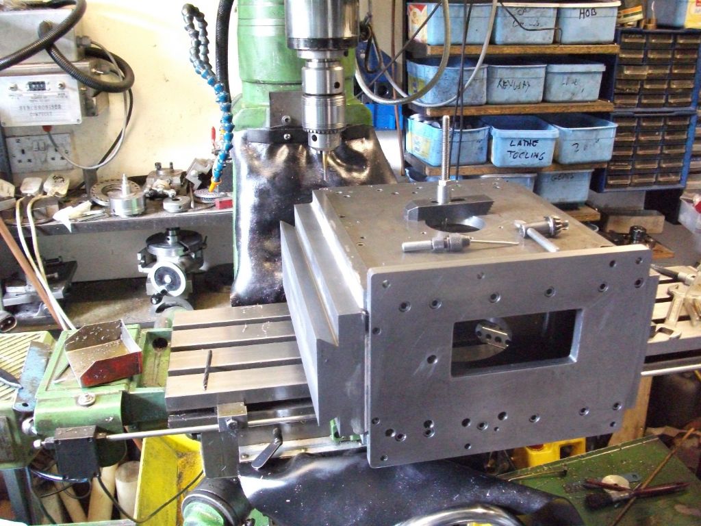

                                        Hi Joe,
                                        Something like this is fairly easy to make ,i used some old carbide 1/8 inch
                                        cutter shanks ,drilled 12 holes at the appropriate angle then silver soldered the blanks
                                        in place .the lands that keep the position are machined or ground away,then it is
                                        just a matter of grinding the cutting edges.
                                        Hss would probably be easier to grind than the carbide that i used .
                                        The cutter head is bolted on to the 2 morse taper arbor.
                                        The cutter is 41.5 mm diameter and 18.5 mm deep.
                                        Used to cut the front dovetail seen here of this home built shaper.
                                        #304550
                                          Looking at your red outline you don't even need a dovetail cutter to make that part. Just angle the work or mill head
                                          #304560
                                            The bugbear will be that while it should work fine, if you have a crash it may split at the screw holes.
                                            55 degree dovetails? Easy if you had a shaper…

                                              Neil;
                                              I see no other way of fixing the replacement dovetails in place, short of making a whole new head.
                                              Jason;
                                              I thought of tangling the part and using an end mill – problem is getting the new part to align properly with the remaining old part. Dovetailing in situ would allow correction of any linear misalignment of the new block.
                                              John;
                                              I am intrigued by the dovetail cutter you made. Can you explain a bit more for me please? How did you do the cone before slotting in the carbide rods? Was it just a , say, 45mm diameter 55deg cone , holes drilled at 55deg very close to the periphery, almost breaking out but not quite, and then machine the cone down to expose the holes, ie, remove half a hole, slot in the rods and silver solder and then grind the cutting edge open? I think you did differently, since in the first photo I see the soldered length of the rods are already almost fully exposed, not siting in 'half-holes'.
                                              I have a quantity of 4mm square HSS , about 150mm long each. I could cut those and mill slots in the cones sides to fit, but would silver soldering the HSS not ruin the temper/hardness? Re-hardening/tempering in-situ would not be easy.
                                              I like the idea and am interested to try something along these lines. I was looking at making a cone, milling flat faces to take the rhombus shaped carbide inserts, the smaller included angle is about 52 deg. I was thinking of silver soldering the inserts on to give more rigidity to the backing. The inserts are small, about 12mm long x 7mm wide, so I would have to work down the dovetail sides – could not cut the hole dovetail length. But your implementation is very attractive. Please tell me more!
