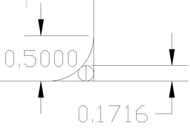

                                                To measure the radius in the same way as the gauge Bill described you could use a square without a notch in the corner and try putting different thicknesses of wire in the corner of the square to find the largest that doesn't make the square rock against the test piece, then draw it up in a large scale (or in CAD) to determine the radius. The catch is that for radii between 0.1mm and 0.5mm you would need to source a selection of wires between 0.0344mm and 0.176mm.
                                                Sorry about the rotten drawing, I have only just switched to 4M CAD and haven't worked out how to add diameter to the dimensioning toolbar (or how to dimension manually)
                                                Brian G
