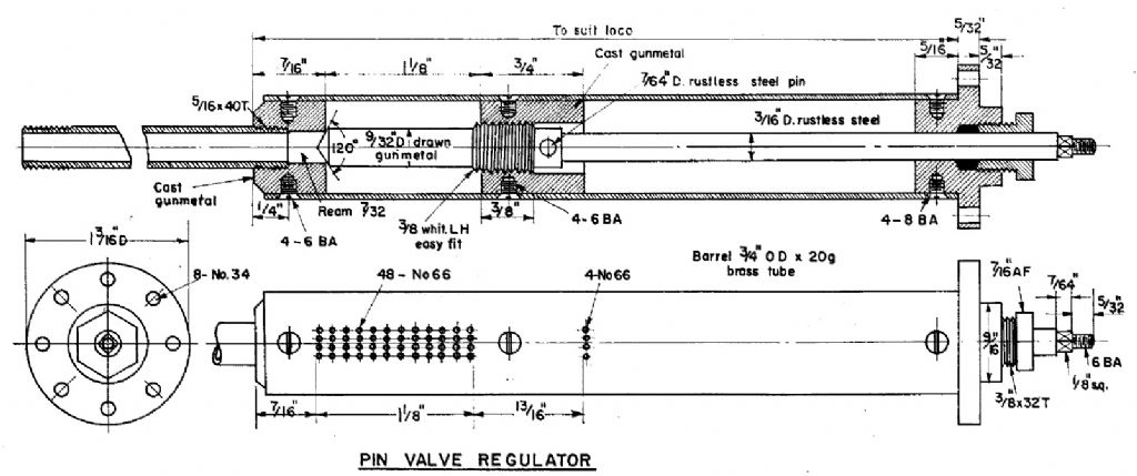

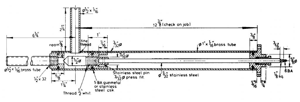

                  Attached should be drawings for two screw down regulators. Martin called them pin valve regulators. The larger regulator has it's dry steam feed from the tube that is pointed upward. This tube would go up into the steam dome. This is the type that was used on Evans' Super Simplex. This is the better design of the two.
                  If you don't have a steam dome, the smaller regulator might work. It gets it's "dry steam" through the pattern of holes drilled into the top of the regulator tube. But, it is easy for boiler water to splash into this pattern of holes. This regulator, along with many other boiler fittings, was described in Vol #3228 of ME.
                  The crossed drilled pin that connects the valve spindle to the "handle" spindle, is buried in a counter bore inside the threaded center part. This is so if this pin ever worked it's way out, or loose, it would be captured in the counter bore. It would be not good if the regulator was open, and the pin came loose! Take the extra time to make the center part exactly like the drawing.

                    Great, thanks for that David. The Holmside looks to have a steam dome so I’ll be able to do the top one with any luck.

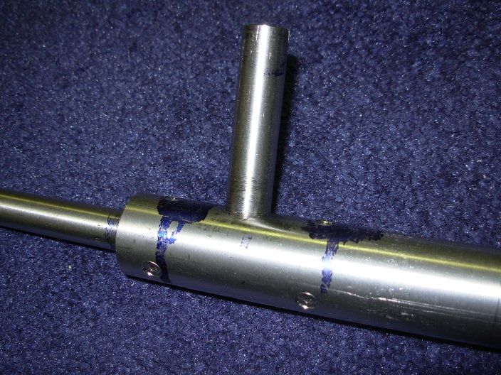

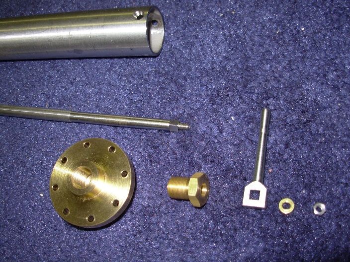

                            Hi James,

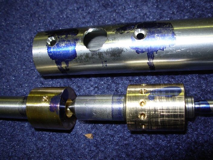

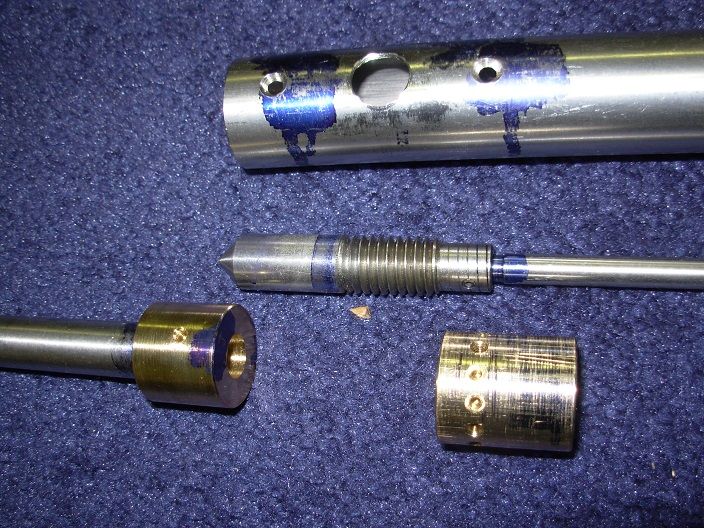

                            Yes, do use brass on any part of the regulator. Stainless steel, bronze or phosphor bronze only. Brass should also not be used for any of the boiler bushings. Use bronze or phosphor bronze. I used aluminum bronze on the solid parts of my regulator and stainless for the tube and everything else. Aluminum bronze is okay, but, it is not easily silver soldered.
                            If the solid piece that the valve screws into has a few extra tapped holes for mounting it inside the tube, you can adjust it's position for exactly where the regulator handle will close the valve. The thread for the valve can be right or left handed, depending on how you want the handle to move to open the steam valve.
                            Attached should be a few photos of the part of the regulator in my Super Simplex.
                            David

                                    #340386
                                    duncan webster 1
                                      @duncanwebster1
                                      If a screw down regulator had a flat face you would need to open it by 1/4 diameter to get full area opening, allowing for a 90 degree point my sums suggest this increases to nearly half. Taking the above example with a 3/8 bore you need 3/16 lift, which with a 3/8 BSW 16 tpi thread is 3 turns. Fortunately you don't need anything like full opening, but it can be seen that taking off the pointy bit to say 5/16 diameter would reduce the opening you do need substantially.
                                      #340531
                                      David Wasson
                                        @davidwasson11489
                                        When in use, the regulator I built above, is hardly ever open more than 1/4" turn, usually much less. The thread is a 1/2" x 13 tpi.
                                        David

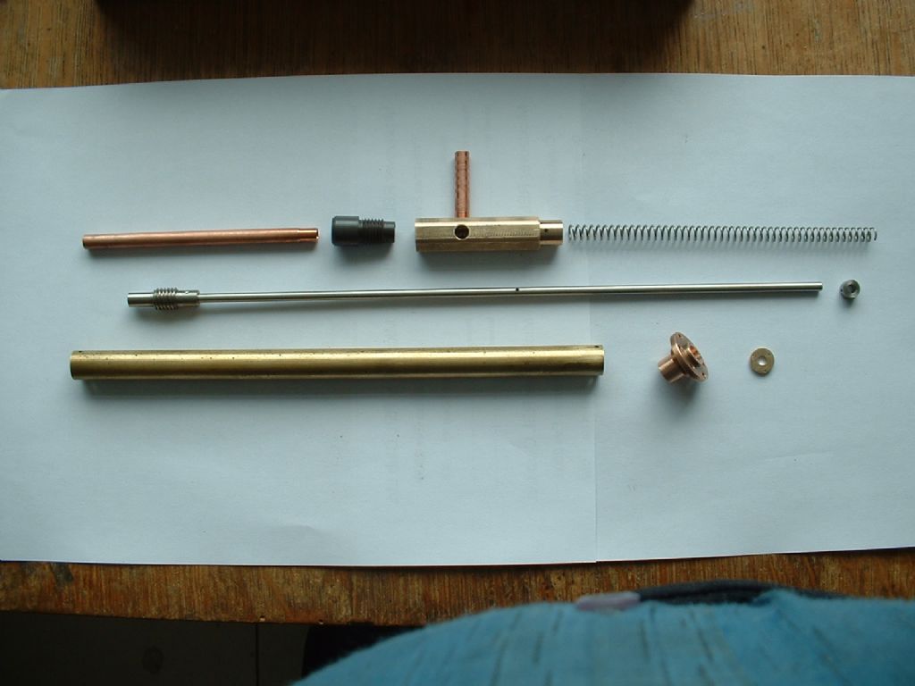

                                          John Baguley
                                            @johnbaguley78655
                                            For my screw down regulators I make the seat part from a bearing grade PEEK. This gives a perfect seal and the valve never seizes shut when the boiler cools down. I find the control to be very gradual and smooth unlike some of the regulators on locos I've driven where it's all or nothing!
                                            The thread on the one for my Helen Long uses a 3/8" BSW thread and for normal running the regulator is barely cracked open, no more than 1/8 of a turn. Any more than a 1/4 turn and the opening makes no difference as the steam flow is controlled by the valve gear rather than the regulator. The pointy bit has an angle of 120°.
                                            I added the spring to take up any backlash in the thread but found it wasn't necessary.
                                            And yes, the tube is brass but it will probably outlive me! Copper would have been a better choice.
                                            #340666
                                            David Wasson
                                              @davidwasson11489
                                              Hi John,
                                              Your regulator looks great! Yes, you are correct, I run with the regulator open about 1/8 of a turn, anymore than about 1/4 of a turn does nothing.
                                              As for making the tube out of copper, I would be careful. When you close the valve tight, all the tension is on the tube and transferred to the three little flat head screws at each end. Copper is pretty soft and it might actually stretch at the screw holes. Given time, it might eventually break. Just a thought.
                                              David

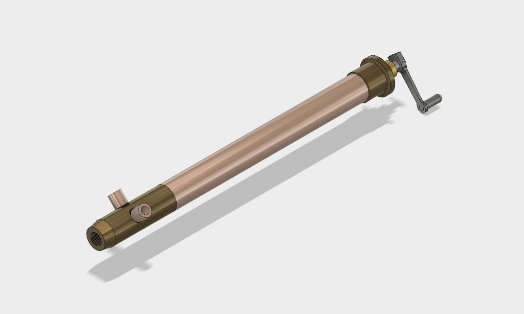

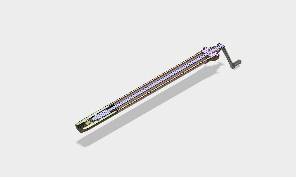

                                                  As promised here is an image captured from Fusion 360 which I have used to develop my next regulator. The body has a PEEK bearing face pressed in and an O-Ring at the Backplate. I have put a 15 degree chamfer on the valve itself.pin type regulator.jpg

                                                    Very interesting, although you have left no way for steam to enter the tube on the back side of the valve. This is usually done with a series of holes drilled on the top side of the tube, or, a tube installed at 90 degrees to the main tube. This tube goes up into the steam dome to get "dry steam". I would stay away from the drilled holes method, as water from the boiler can still splash into the regulator tube.
                                                    The part that contains the seat for the valve looks pretty complicated, I would not want to machine that. I look forward to photos of the finished product. A simple screw down valve against a metal seat in the tube works just fine. Make the angle of the valve whatever you think will work best. Also, graphite string works just fine for packing.
                                                    David
                                                    #342101
                                                    Bruno Taylor
                                                      @brunotaylor21701
                                                      Aha, If I show the whole thing, perhaps it helps. I am going to put two short inlet pipes in the top like this. The plan being to put the regulator body through the backhead flange and then insert the short pipes in through the safety valve bushes, taking care not to drop them! The idea is to collect steam from the highest and dryest part of the boiler. The boiler is domeless so cannot do the taller style of collector pipe.
                                                      I don't think it is too complicated. I will drill through in several diameters to form the step for the PEEK valve face to be pressed in, the valve cavity and finally for an M10 thread. Reverse in the chuck and then drill and tap the other 5/16×32 ME for the steam pipe. The PEEK valve face being a press fit from the M10 threaded hole.
