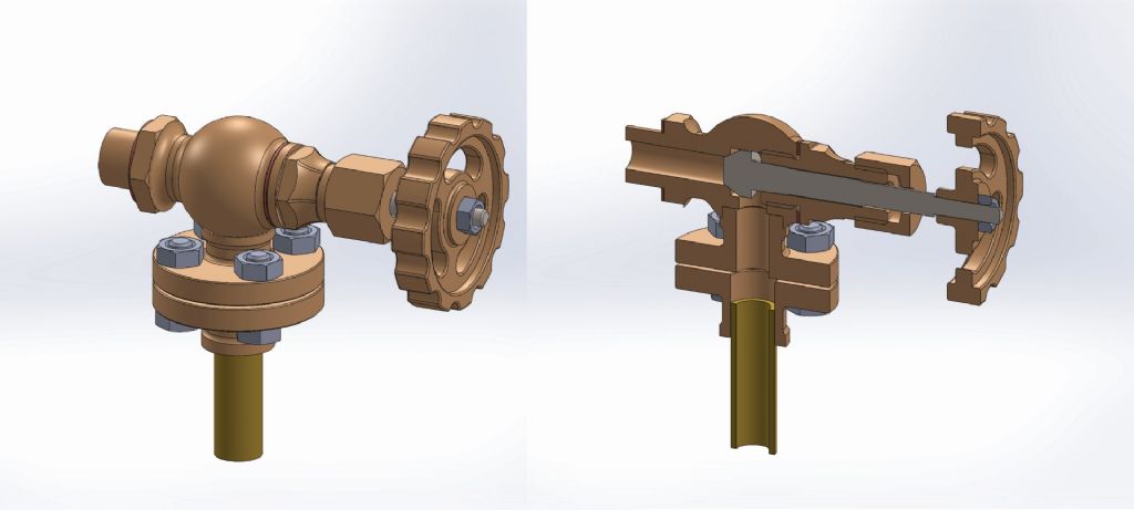

                                There are several families of stainless steels with different physical properties. The magnetic properties of stainless steel are very dependent on the elements added into the alloy. A basic stainless steel has a ‘ferritic’ structure and is magnetic, formed from the addition of chromium – it can be hardened through the addition of carbon, making it ‘martensitic’. However, the most common stainless steels are ‘austenitic’ – these have a higher chromium content and nickel is also added. It is the nickel which modifies the physical structure of the steel and makes it theoretically non-magnetic.
                                304 stainless steel contains chromium (min. 18%), and nickel (min. 8%). It is an austenite steel and is only slightly responsive to magnetic fields. It also contains 18 – 20% chromium and 8-10.50% nickel, and lesser quantities of some other elements. It is relatively easy to machine and less expensive than 316.
                                316 stainless steel is a molybdenum-alloyed steel. The fact that it is also negligibly responsive to magnetic fields means that it can be used in applications where a non-magnetic metal is required. It also contains a number of other elements in varying concentrations. 316 can work harden and make machining difficult. It has a much better corosion resistance and is used for marine fittings.
                                I recently inspected the spindles on some model globe valves which I made about 18 months ago out of 304 S/S because they were not sealing properly and found that the seats were pitted and coroded. Now have to make them again, this time out of 316 grade.
                                Paul

                                        Posted by Paul Lousick on 15/01/2021 06:20:29:
                                        Clipped
                                        Paul
                                        This are of corrosion is complex. A good guide is the PRE no which is a guide to pitting and crevice corrosion resistance
                                        As a guide
                                        304stst is about 18
                                        316stst is about 24 so 30% better but if at elevated temperatures would not be considered marine.
                                        Generally if there was a problem on a swimming pool or sea water I would look for a PRE >40
                                        This takes us to super Duplex such as SAF2507 or 254SMO which is like 316 but with more chrome and molly.
                                        Steve
