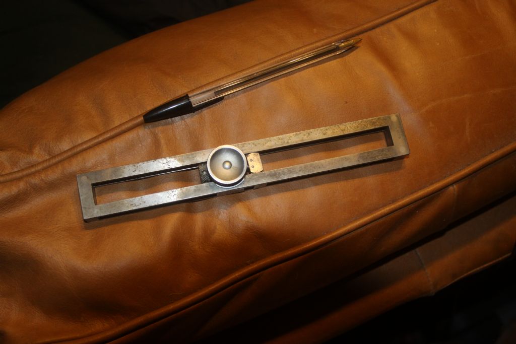

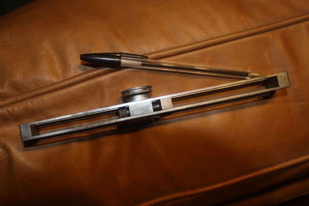

What is this tool?

        geoff adams
          @geoffadams14047
          it could be a slip gauge holder for holding a stack of gauges hard to see from that angle and not knowing the size
          Geoff
          #506962
          Square Peg
            @squarepeg53768
            Think you could be right…
            #506968
            peak4
              @peak4
              Posted by geoff adams on 12/11/2020 10:55:39:
              Geoff
              Having just bought one of ebay, I'll go along with that
              Bill

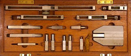

              #506971
              Mike Poole
                @mikepoole82104
                It may have become estranged from a set like this which greatly extends the usefulness of a set of slip gauges
                Mike
                #506972
                  … and not knowing the size
                  At a guess … It’s roughly one and a half ballpoint pens in length angel
                  #506986
                  Howard Lewis
                    @howardlewis46836
                    +1 for a Slip Gauge Holder, that has escaped from the box and accessories.
                    A most useful item
                    Howard
                    #507032
                    old mart
                      @oldmart
                      The jaws are missing. Our inspection department had a complete set, which got used very occasionally, as they did not deem them very accurate.
