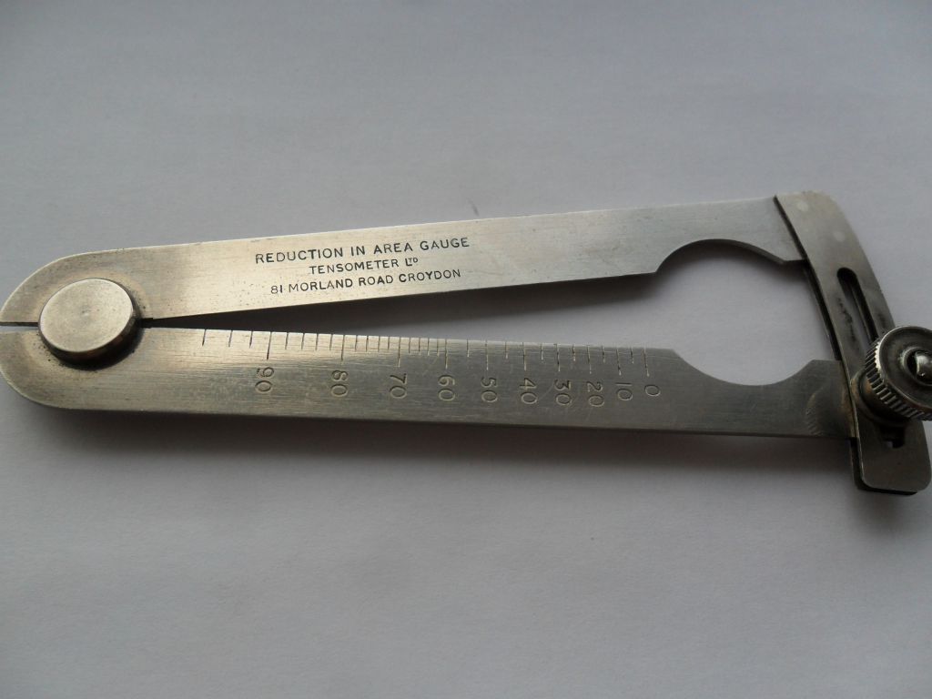

        some kind of gauge

          Its one of these

            Thank you ASF came with a job lot of tools I bought on line
            #343836
              I assume you put a full diameter piece in the zero position to set it, and the figures tell you how much smaller a stretched piece is.

                The intriguing bit being that the scale is calibrated as 'Reduction in Area'
                Presumably 0 to 96% reduction.
                That's neat !!

                  Its still a puzzle for me . Its well made

                    http://www.instron.us/en-us/our-company/library/glossary/r/reduction-of-area
                    The one illustrated on this page has a patent number:
                     http://www.mathsinstruments.me.uk/page60.html
                    … but it's illegible sad​

                      Thank you for link It makes sense to me Stress over Strain = E etc
