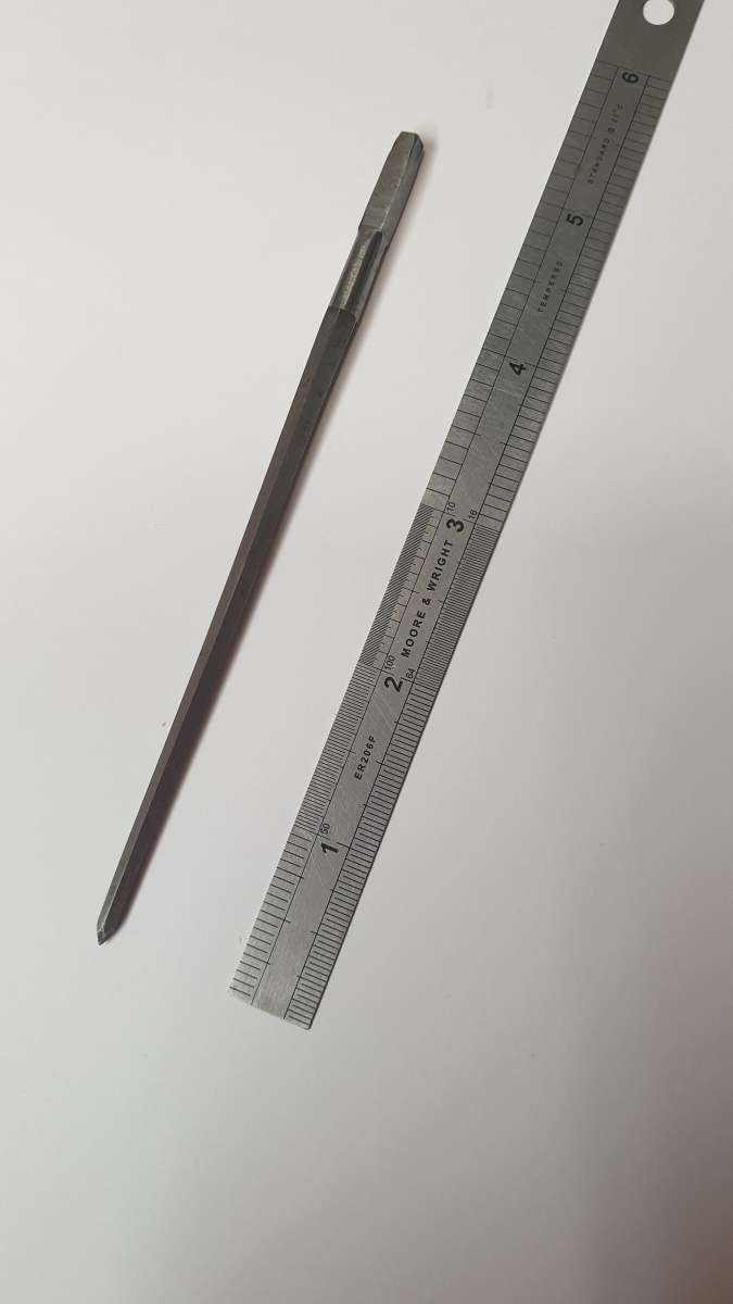

      I Found This Amongst Some Used Taps & Reamers I Bought.
      It is 5 Sided.
      Does not have cutting Edges like a Reamer and is Tapered.
      My question is What is called, and what is it used for.20250325_213925

        It’s a rather large cutting broach, used to enlarge holes typically in brass clock plates.  Available from clock sundies suppliers.
        https://www.cousinsuk.com/product/individuals-0375-to-01049mm
        Still useful tools though not exactly precision.  Best for cutting brass, would be hard work in steel.

          looks to be about the right taper for easing holes for taper pins ??

            Taper-pin reamers usually have the same ‘flute & land’ structure as a standard parallel reamer..
            I’m sure John’s bang-on.

              Yes a cutting broach. I have a few and they are quite useful at times.

                Clock making Broach for sizing pivot holes. The slight taper allows for a small amount of movement away from the perpendicular which avoids binding if the holes in the clock pates are not exactly opposite each other so the fit can be made closer. It also means that the bearing contact area is a small annulus which reduces friction. Similar smoothing broaches exist of the same shape but without the facets. They go down to very small sizes too.
