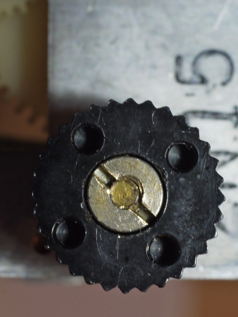

      Hello all. Another beginner question:
      Whilst restoring a Stanley plane and similar aged tools I've noticed an annoying tendency of not quite getting a perfect fit flat head screw driver.. I must have about 10 flat heads of various ages (a few with W Germany stamping) up to modern metrics, and as I say sometimes nothing quite fits, with the blade turning a smidge in the slotted head…
      was there an Imperial flathead dimension system that I've missed? Any advice is welcome. I'm a firm believer in 'right tool for the job'.

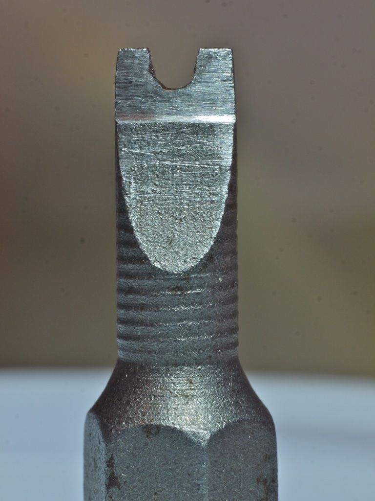

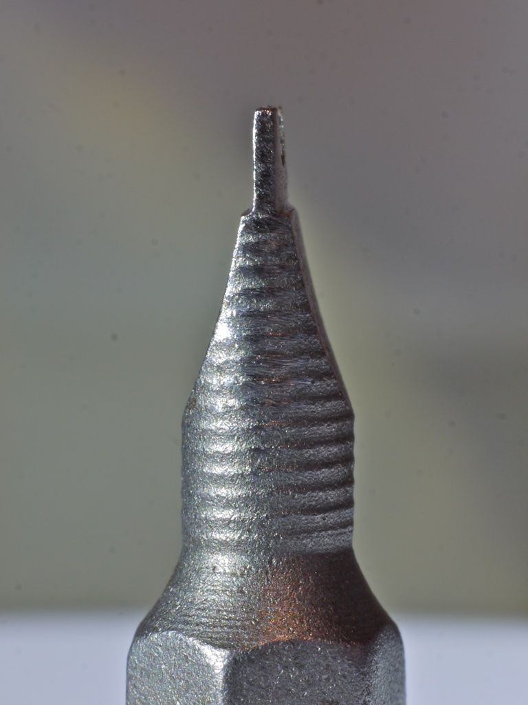

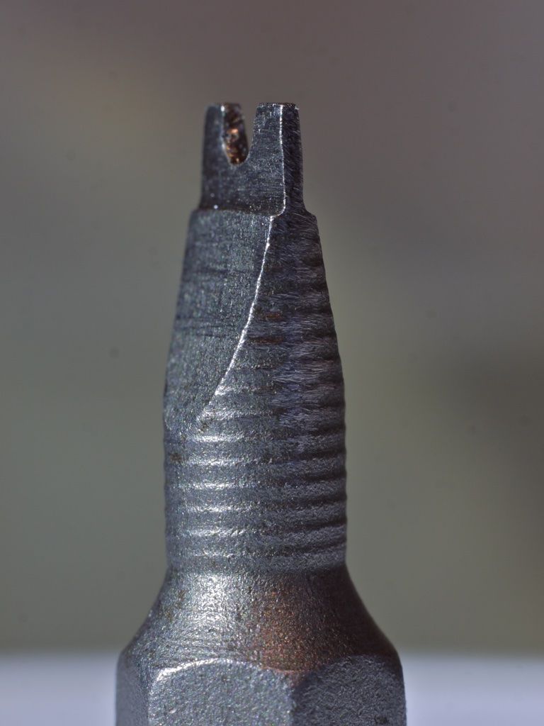

                                Posted by Mike Poole on 07/04/2020 08:53:19:
                                A properly tempered screwdriver should be possible to file with a decent file but the tip will always be slightly tapered […]
                                It ain't necessarily so !!
                                The tip can actually be any shape that you are capable of filing:

                                        #462970
                                          Posted by Michael Gilligan on 07/04/2020 10:05:55:
                                          The best thing about cheap scewdrivers is how easy it is to turn them into something useful!
                                          I've even got one filed to a 5mm hex on the end for allens screws in very deep holes as well as one that matches that bit above perfectly.
