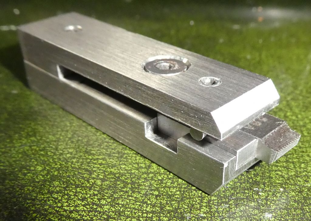

                  Further to Rik's observation … The individual inserts can be useful to the amateur, as thread chasers.

                        "Further to Rik's observation … The individual inserts can be useful to the amateur, as thread chasers."
                        Indeed they can Michael – here is a holder to do that very job which I made a while ago:
                        #338931
                          I have a set of single inserts and a holder from Tracy Tool for use as a hand chasers.
                          In practice I hold one in a QC tool holder.
