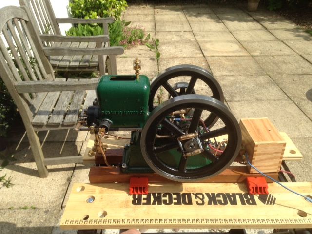

                      I built the Nemett as my first engine, it's not as simple as the Firefly, but the ME magazine series was so detailed and well illustrated with photo's it made it a bit like painting by numbers and if you stick with a glow plug, the complexities of spark ignition can be avoided.
                      #153952
                      colin calver
                        @colincalver
                        Just had to tell, 4 months in cave and then…………………………………it runs. Oh what joy.
