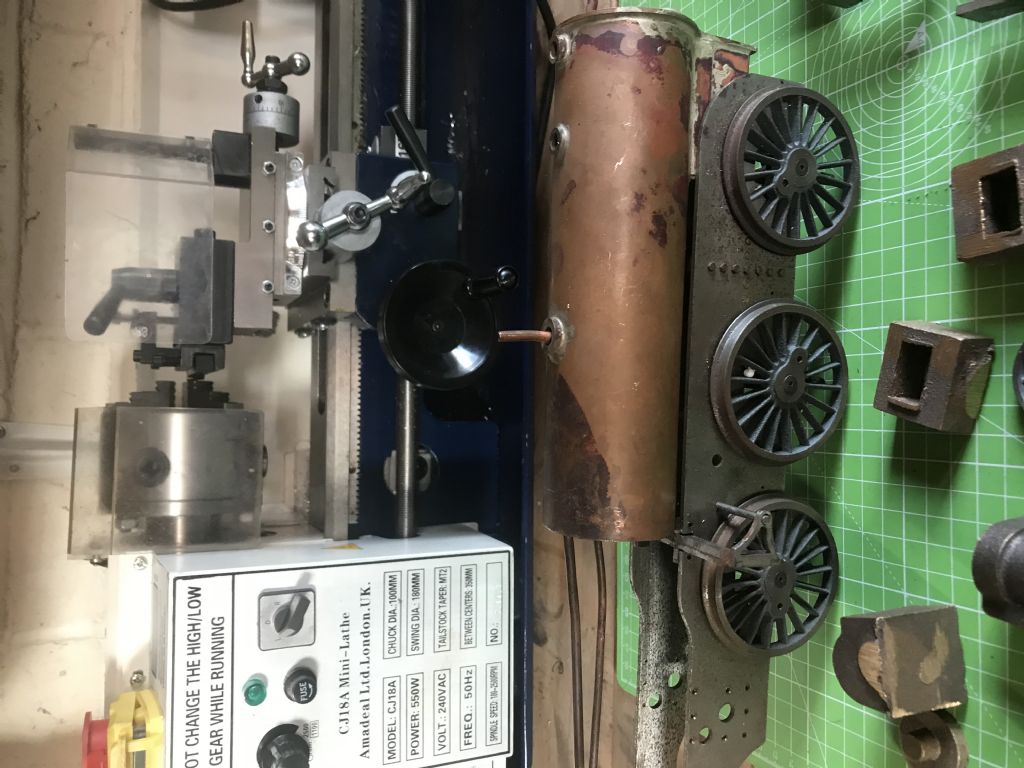

      A while ago the wife bought me this part-made loco, I’ve now got the time to do something with it….. however, I’ve no idea of what I’ve got, or where to go to get what I need, any information/ recommendation would be gratefully received. Many thanks.3462a32c-82fb-406f-b021-37ad81400e22.jpeg

        Jon Lawes
          @jonlawes51698
          The firebox shape looks almost like a dean…. I'm assuming thats the firebox at the top anyway! I'm notoriously bad at this game though. It could be a freelance design of some sort.
          I presume it appears to be an 0-6-0?
          #375123
          John Baguley
            @johnbaguley78655
            I would say that it is the Gauge 1 2-6-2 Green Arrow by Martin Evans described in ME starting In October 1971. Not sure if anyone still does castings for it.
            #375125
            John Baguley
              @johnbaguley78655
              Just had a look at the articles. The chassis and probably the castings are for Green Arrow but unfortunately the boiler is not. Green Arrow has a wide firebox coal fired boiler whereas yours is a shorter narrow firebox boiler either gas or spirit fired. Possibly meant for something like the Gauge 1 Project?
              #375156
              john francis 5
                @johnfrancis5
                Thanks for the replies, John, I think you may be spot on, I’ve found two packet labels, one refers to the Green arrow, and one to a Gauge 1 project, so it seems I have the chassis and some parts for the Green Arrow, but no boiler, and a chassis, with no wheels and maybe a boiler and some body parts for a Gauge 1 project, Would I be able to get the rest of the parts, boiler etc for the Green Arrrow, if not, do you think these parts would have any value to someone, or are they scrap? Many thanks John

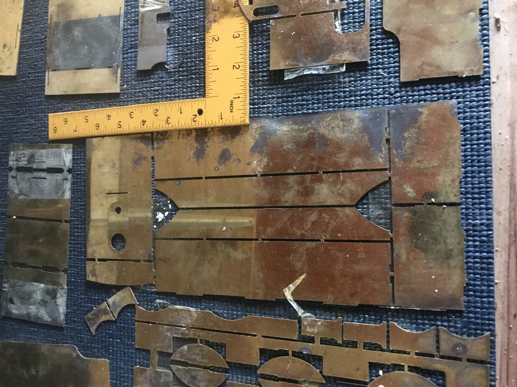

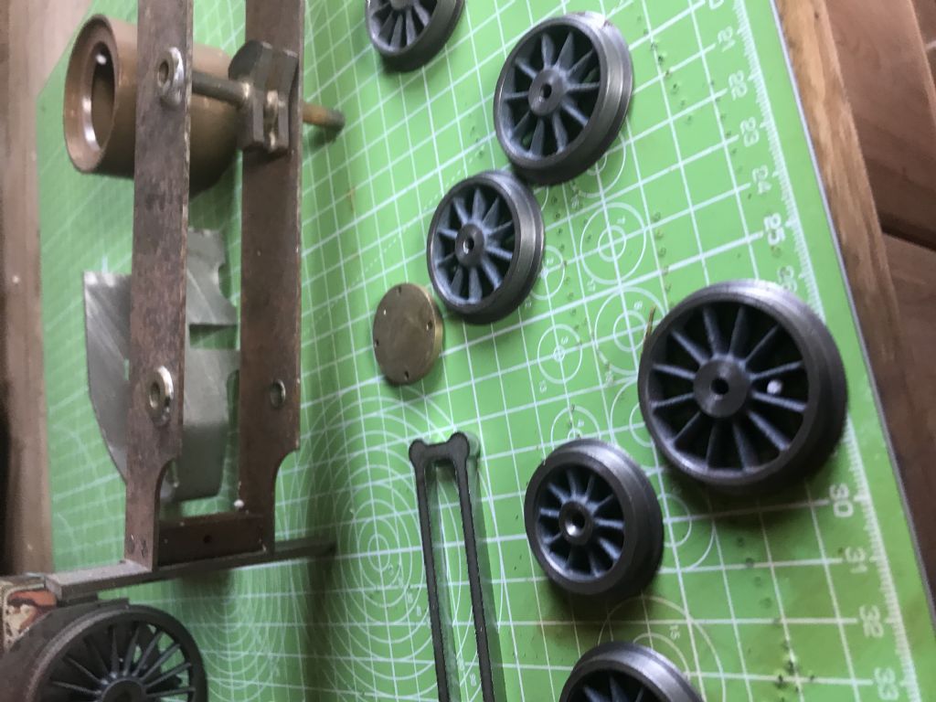

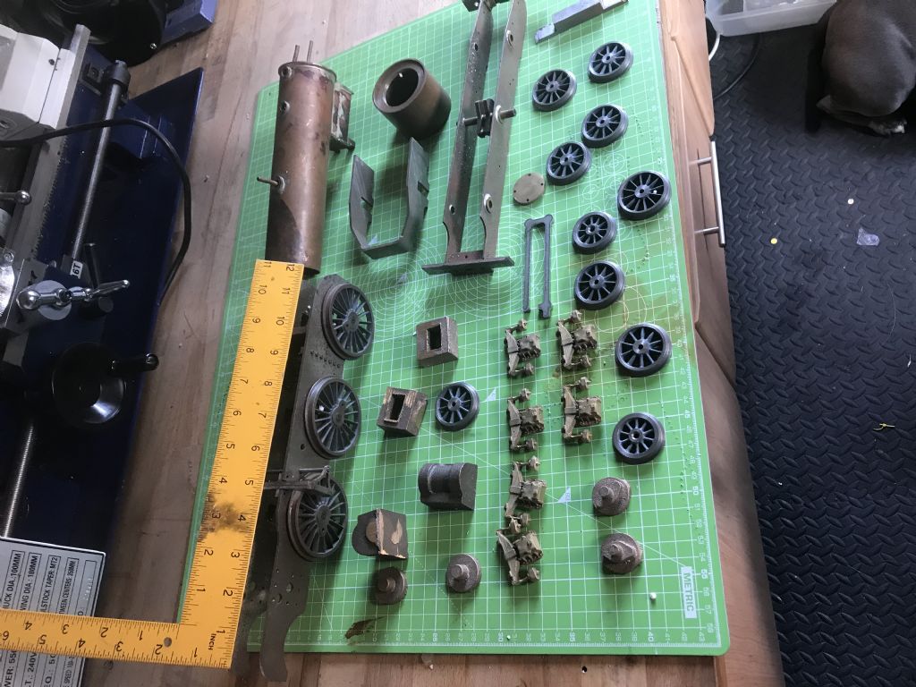

                        The above pictures are of the other parts I've got, would love to build a Green Arrow, just don't know where to start???

                          Hi John,
                          I can't find anyone who sells the drawings for Green Arrow but I can let you have a copy of the articles if that would help? All the drawings are in the articles so you don't really need the full size ones anyway.
                          It looks like you have most of the castings and anything missing could be fabricated.
                          Model Engineers Laser do some parts for Green Arrow including laser cut tender bits.
                          You should be able to get drawings etc. for the Project from the G1 Society. I think they do a booklet for it.
                          #375191
                          EdH
                            @edh
                            The drawings for Martin Evan's "Green Arrow" were in the centre fold of ME’s 4394/5/6  Dec2010 to Feb 2011.
