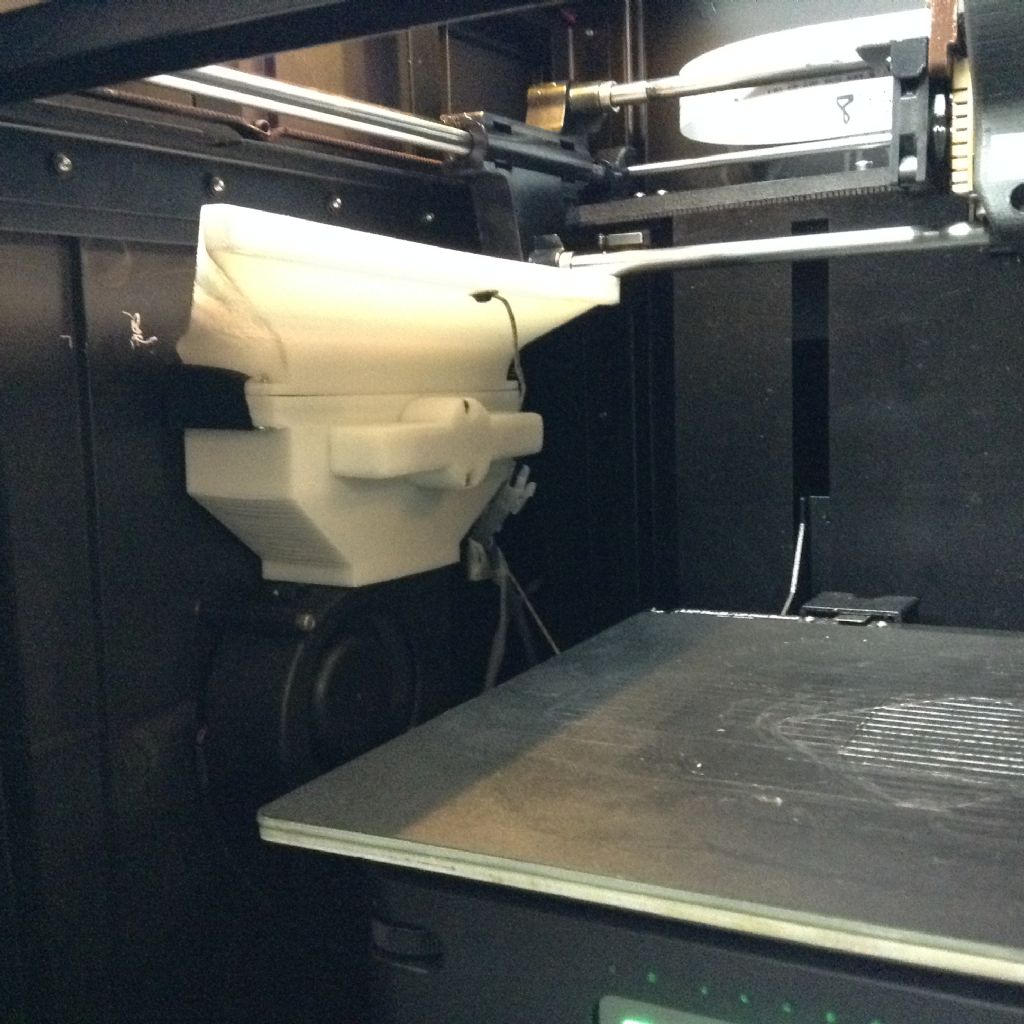

                                                I'm experimenting with Chamber Heating using a 200W heater with a duct that directs a flow of heater air [~70c] across the bed along similar lines to a Stratasys professional printer that I dismantled. This keeps a uniform build environment and speeds up getting the printer up to temperature, I feel it is worthwhile time investment for bigger prints.
