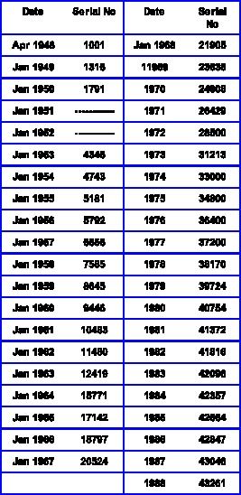

                                      "What is your view on the Boxford 5" x 22" for sale by gandmtools"
                                      That is a similar machine to mine with some minor differences, as to it's condition unless one can inspect it impossible to say.
                                      Serial numbers give the a clue to the age not very clear jpg but should give you an idea if you ask for serial number.
                                      Do not dismiss 3 phase machines as these are easy to run off a converter which converts the single phase supply to three phase, costs vary but £250.00 should cover it.

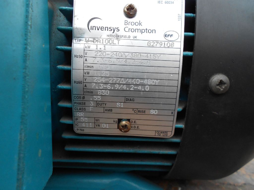

                                                    Would a Colchester Bantam 2000 3phase machine run off an invertor which would run on a domestic circuit?
                                                    Or indeed, any other 3 phase powered machine of similar capacity?
                                                    Jack
                                                    #157228
                                                    Bob Brown 1
                                                      @bobbrown1
                                                      Assuming the motor is a dual voltage motor it is reasonably easy, the motor needs to be dual voltage so that it can be wired in delta rather than series. It should be just a case of changing the links in the motor and the motor plate should give the game away.
                                                      The plate above shows Volts 254-277 delta and 440-480 star.
                                                      The only other restriction is size but you should be ok up to 10hp off single phase.
                                                      All is not lost even if the motor is not dual voltage as they are not that expensive to change and even conversion to single phase is possible.
