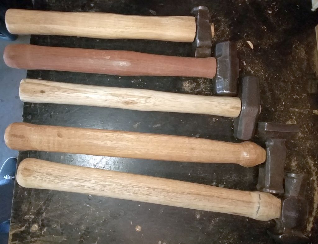

          Mate who's into Blacksmith asked me to make some new handles for his selection of scored hammer heads.
          His request was for handles to suit each head and his large hands typical handles fly across the floor as they are often to small.

                Nice work Ray!

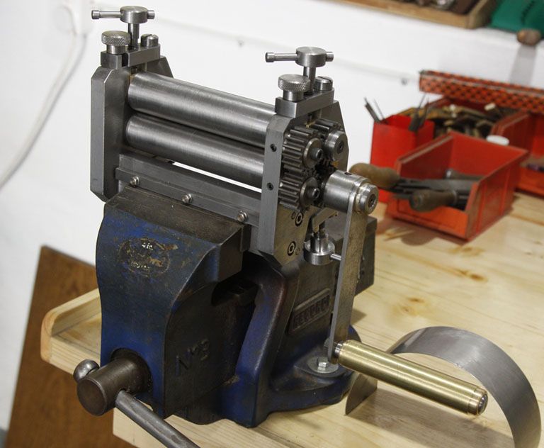

                              Finished my geared bending rolls. Made to the design of GHT. I already have some 12" rolls that I used when I was making a boiler, they are to heavy and cumbersome, so made a set with 5" rolls. More useful for the small work I now do.bending rolls 2.jpg

                                Nice looking rolls, should do some good work.

                                    Fine work there, Saxalby!
                                    What's their thickness capacity? The sample looks to be about 1mm thick.
                                    What's finish on the steel-work? It looks darkened, as if some form of protection, or is the effect just photographic?

                                          Nigel.
                                          Yes the sample is about 1mm thick and I have used it on 1/16" anneal copper which is about the thickest I shall be doing. The darkened metal is just my bad lighting in the workshop. Although I do intend to blacken the steel to give a bit of rust protection.

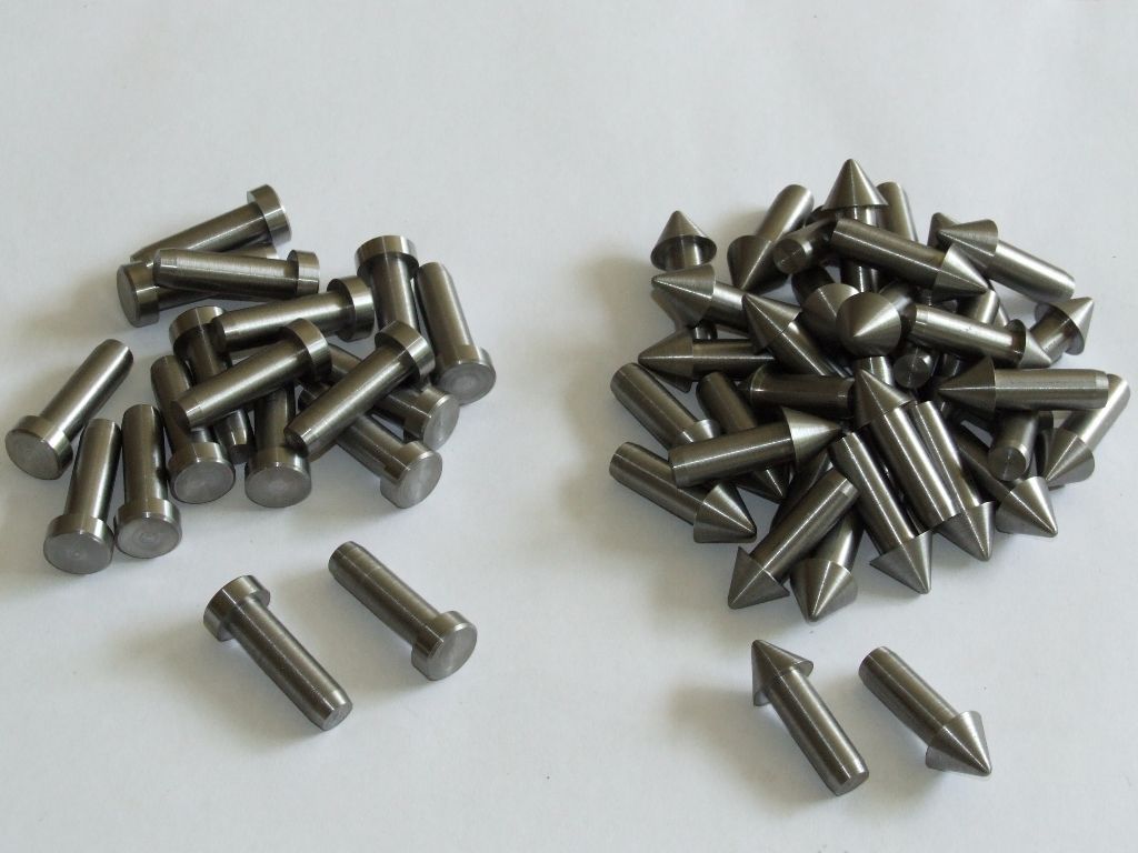

                                                      Also knocked out the anchor bolts and frost spikes:
                                                      For scale the shanks are 3/8". The anchors bolts were entirely done on the repetition lathe, all with HSS toolbits. The frost spikes were roughed out on the repetition lathe, but the tapered end was done on the centre lathe using the top slide and one pass. The rounded end was done with a file.
                                                      Next job is to machine the rectangular slots in both parts for the keys that keep them in place.
