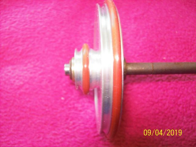

        Now for something Completely Different ! Lightweight and entertainment related, this is a replacement double drive wheel for a jukebox being restored by one of my clients. It's just over 2.5" diameter, so very small beer compared to the majority of subjects in this thread.
        The original was moulded black rubber with a brass bush, and it was so perished and cracked that it was difficult to decide what the diameters should be. This was important though, if the turntable was to hit 45rpm. The client decided on the use of 'O'rings for drive tyres so I turned an aluminium replacement, suitably grooved, with a bonded-in brass bush.
        He only sent me one of each size, but has since tested it and decided two are definitely necessary. After a couple of tweaks at his end he has achieved 45.2 rpm, which he reckons is good enough for rock 'n roll !

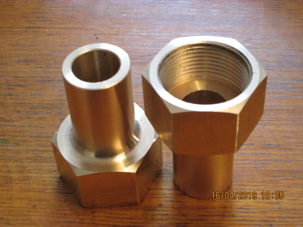

                Finished a pair of water gauge sight glass nuts for the Polish tank engine:-
                They're 1.67" AF hex – started from 55mm diameter LG2 round bar. The thread is what I'll call 1.7/16" x 12 TPI, for want of a better description. Hexes were done on a Bridgeport clone with a dividing head.
                I had a sample nut to work from, but without the tubular tail. In the water gauge currently fitted to the engine, the vertical glass tube's enclosed in a rectangular perspex box with a red line painted on it to indicate the water level.
                They don't like this and asked for the tail to go down to water level. When I deliver the bits I'll ask 'em why, 'cos it seems a bit pernickety to me.
                I cut the thread mostly rotating the chuck by hand, because screwcutting under power close up to an internal shoulder, when you can't disengage the halfnuts and it's hard to see the tooltip, seems like courting disaster to me. My metric WM250V has a 63 tooth change gear, not 127, so the 12 TPI setting can only be approximate – but fortunately both nuts screw on to the sample water gauge spigot they lent me – after I'd cut the thread …

                  Nut tails down to the proper water level?
                  That seems very odd! Wrong in fact A shroud UP to the minimum level to help give a larger safety margin, yes, but DOWN? Perhaps they are thinking of maximum level to help avoid priming, but still above the red line.
                  Unless I have a screw-cutting tool that gives the full thread profile, I cut nearly to size then finish the thread to size by tap or die. That also completes the profile and would correct very small pitch errors.

                    I have a question about the actual 'O' ring you used. The majority of seals easily available are black in colour. I have seed silicone rings which look red/brown and some green 'O' rings, what type are the ones in the picture and who stocks them?

                      Yes, the shrouds seem odd. I even suggested slot-drilling a couple of windows over most of the length of the tail so as to observe the level of the water if it was covered, but they said emphatically "no, we certainly don't want that!" Hopefully it'll all come clear…?
                      blush
                      As for finishing off the screwcut thread with a tap; of course, that'd be wonderful if one was available in that oddball size…!

                        A 63 tooth gear for metric/imperial conversion gives an error of only 0.0125% if used in the correct direction (63*2.54=160.02). So it's not all that approximate. wink

                            Thanks – I thought it'd probably be OK, and it seems to be.

                              Yes, the maximum level is what they're interested in – I asked today as I delivered the bits. Apparently this engine has its current water gauge mounted too high, and the convention among cab crews is that any level visible in the sight tube is within limits.
                              So the objective of the tail is to push down the max limit, and the cost of this is more careful maintenance of levels due to the reduced range.

                                So at a glance it's hard to tell if the boiler is over full or under full?
                                Ouch…

                                  Well, that'd always be true if you didn't see the meniscus and couldn't tell if the tube had water in it or not. The idea is to make sure you can see it, below the tail of the top nut and above the bottom nut. Just the space between the two is reduced from maybe 10 inches to about 8 (memory guesses), so you have to check it a bit more often. The gauge is only mounted a couple of inches high – that's my understanding.
                                  And I'm not going to get into dispute with those guys who've been puffing that engine up and down the line for years…

                                    " if you didn't see the meniscus and couldn't tell if the tube had water in it or not. "
                                    I can see shortening a long gauge-glass might help you maintain a more consistent level, but a contrasting line or stripes behind the glass is a well-proven way to make clear what's water and what's steam. Does the fitting have this?

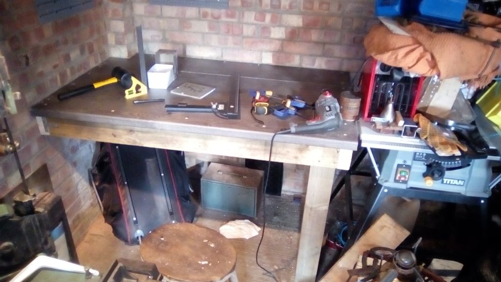

                                      Having sold two of my stationary engines last weekend I now have a space in my garage so yesterday I built a work bench with a storage shelf underneath, the bench is made from a 50mm kitchen worktop and 4" x 2" treated timber.

                                        Take a good long look at that space, my forecast is it lasts about six hours before you never see it again…

                                          I just did and there is more space because I've transfered the contents of the old work tool bag into two tool cabinets, the shelf for under the bench will be made tomorrow and the only time the space will disappear is when I plonk half of my 20 stone frame on a stool and my legs slide under it smiley
