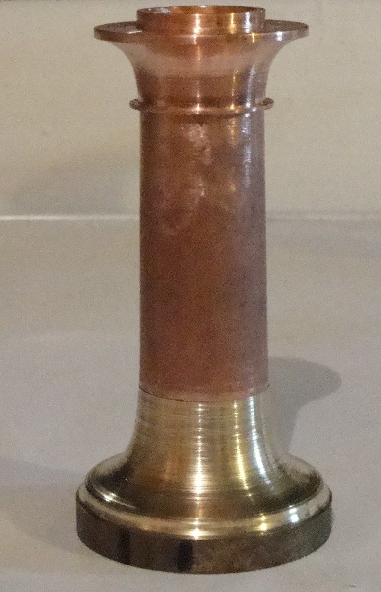

            dsc00785.jpgi had a go this evening at making the copper cap for my 5"g terrier STEPNEY out of solid copper.
            tricky stuff to turn! im not quite happy with the profile yet, and the beading at the base of the cap is yet to be turned to finished size.

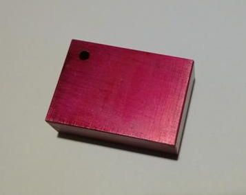

                  Changing the theme a bit… to what I did today.
                  made my first steps into anodizing. I'm happy to tell that it went quite well cool :
                  It might interest someone that I didn't use the usual 20 % sulphuric acid. Instead I prepared a mix of 2 liters distilled H2O, about 400 grams of PhMinus salt and 100 grams of liquid PhMinus. These two products are used for treating swimming pool water and are easily obtainable. I think the liquid is sulphuric acid, but only about 10%, and the cristalline is Sodium-Hydrogene-sulphate. I added the liquid form only because first I had no current flowing; later iI found out the culprit was the Alu wire I used for suspending the sample. I changed the wire to a Titanium wire and set for around 200 mA for this small item (with a lab power supply). I found a value of 10 mA per cm2 in the online literature, seems that's a good number!
                  The colour – is magenta ink for a inkjet printer! First thinned down, then I put a bit of the concentrated stuff on with a small paintbrush. Btw the dark spot near the hole is just a picture artefact
                  A couple of these famous (for anodizing) Dylon textile colours are already under way for the next trials!

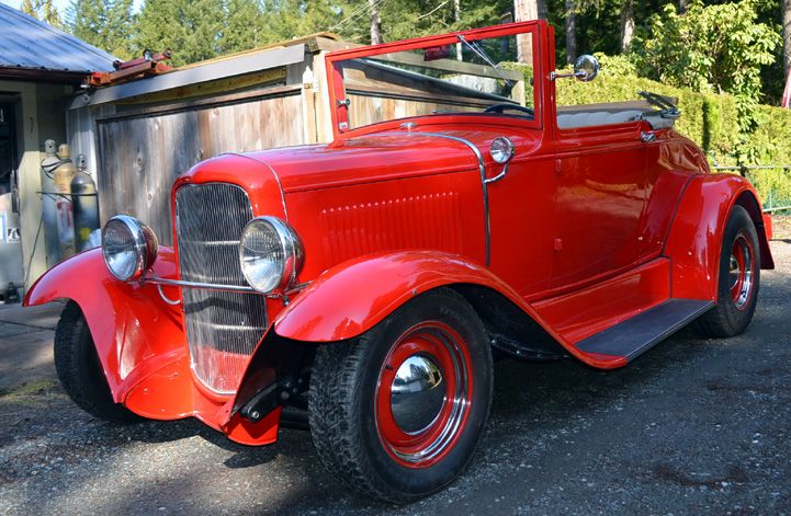

                     latest pic.jpgI did a little work on this prior to fall setting in.

                          Posted by HobbyNut on 26/09/2014 15:51:08:
                          That's nice !! … Tell us all about it.

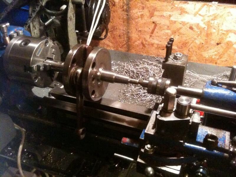

                                    image.jpgA friend has recently bought a 1976 twin shock motor cross bike , the bike became a non runner in the late 80's and was left in a barn ,that was until my friend purchased it to restore to its former glory .
                                    The left hand thread on the crank was damaged ,so I thought I'd have a go at repairing it ,a bit ambitious considering the size of the crank and my lathe being a Myford ML4 .
                                    Above is a pic of it mounted on the lathe, I'm pleased to say it was a success .

                                            It is a 1930 Ford Model A Cabriolet. The body is all stock 1930 sheet metal except for the hood and grille, which are repro 1932 Ford items. The frame was built by me, the diff was shortened by me, every nut and bolt in the car was put there by my 18 y.o grandson or myself. We did everything except paint.
                                            It is powered by a ,67 Chev 305 V8, Auto trans, to the 3.55 geared 9" Ford rear end. The upholstery is repro 1930 on original springs. Brakes are Chrysler discs, Chevy Calipers on '48 Ford spindles up front, 10" Ford drums on rear. Chevy Vega cross steering, with a 1932 Ford steering column and a '36 ford steering wheel. the dash is a '38 Ford item scavenged from a wreck found in the bush.
                                            Engine mods are a CC 268 Cam, 1.6 ratio rockers, Hi volume oil pump, roller timing chain, Electronic ignition, Victor Jr. intake manifold with Edelbrock 650 carby. hedman extractors into 2.5" dia. exhaust pipes and SS mufflers.
                                            Paint colour is Porsche Guards Red. (or as they call it over here, resale red!) No it is not for sale !
                                            Obtained body in 2005, finished car in March 2014.

                                                    Posted by HobbyNut on 27/09/2014 18:28:19:
                                                    It is a 1930 Ford Model A Cabriolet. < etc. >
                                                    Thanks for the info.
                                                    Very impressive job !!
