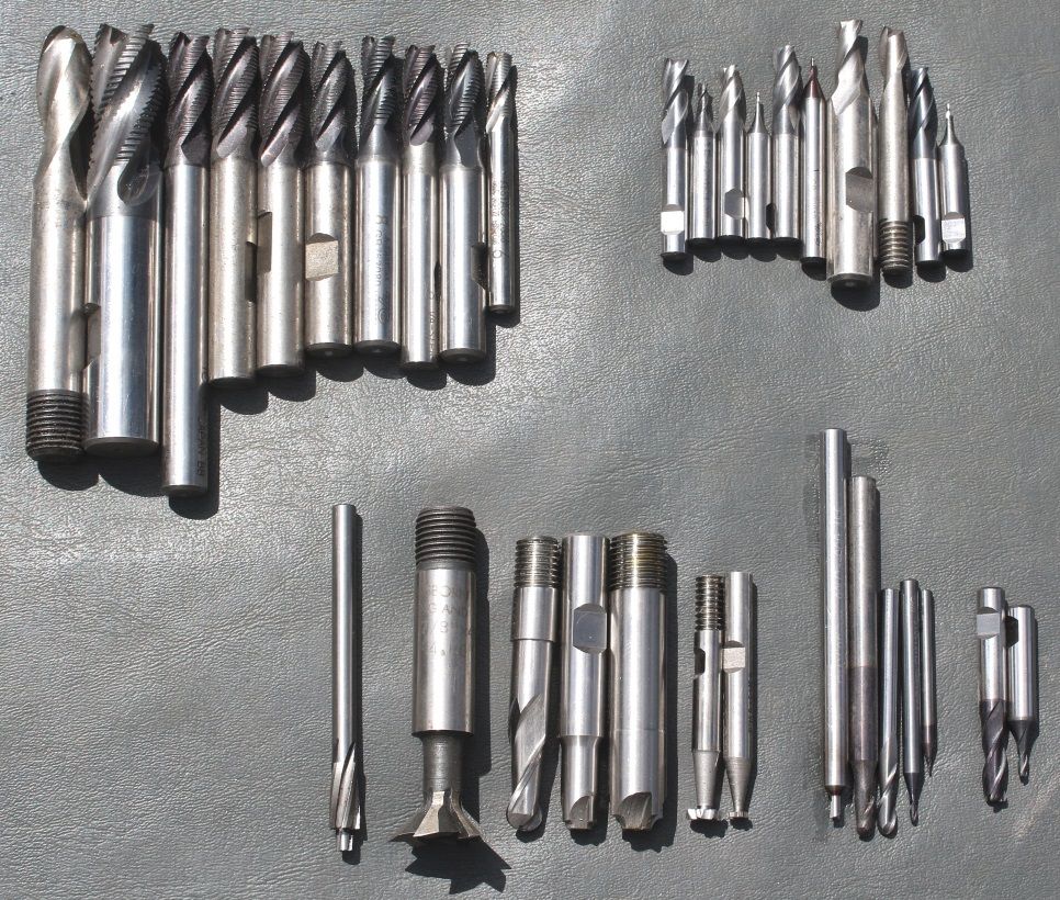

                Only managed shopping at one car boot today as I couldn't be bothered getting up early enough for more. This was this mornings haul from one seller.
                9 x rippa cutters 6-16mm
                18 x slot drills and end mills 0.6 – 12mm
                2 x radiusing cutters
                1 x 7/8" x 45 degree cutter
                1 x 5 degree slot drill (don't know if I'll ever use that one)
                1 x 3 fluter with pilot
                34 cutters in total, all new in their plastic packets – he was happy with his eight quid but nowhere near as happy as me. teeth 2
                May the good boot continue to flourish and provide.
                Rik

                    Blimey Rik, the dovetail cutter was easily worth that!

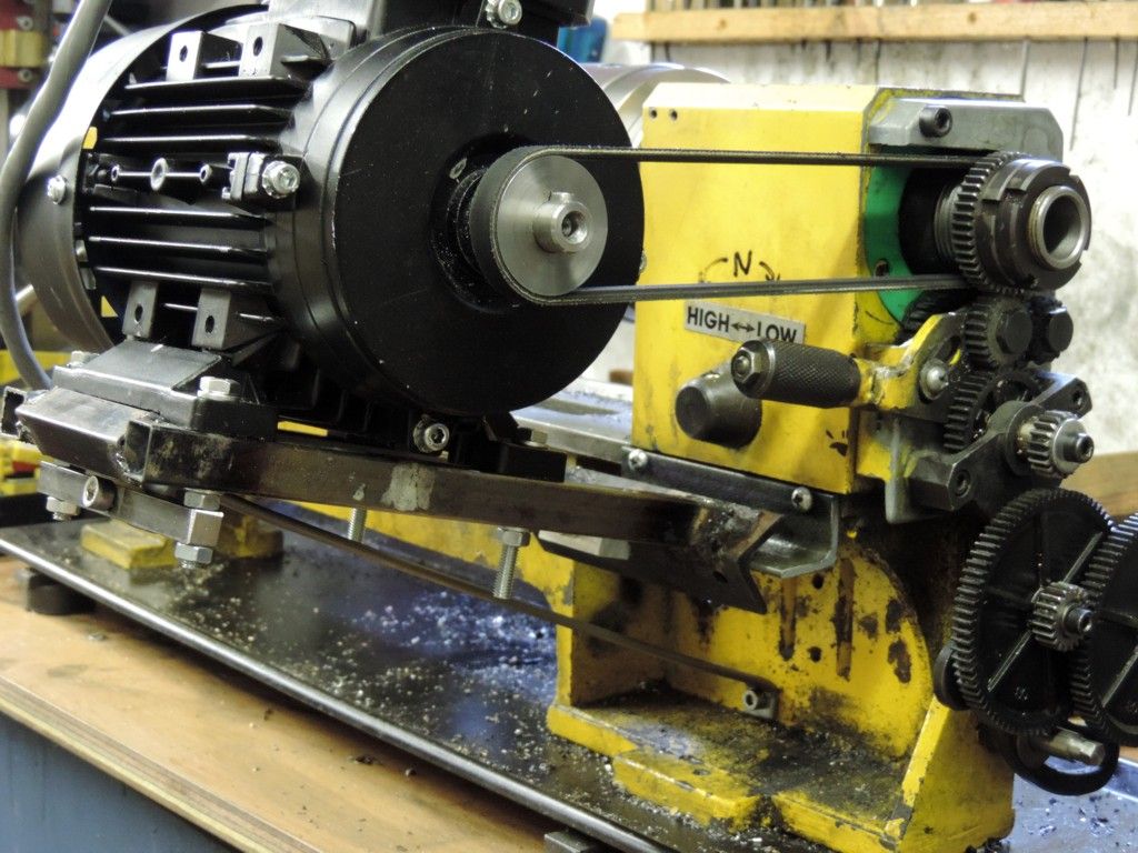

                    I have committed major butchery on my lathe, making then fitting a poly-v pulley at the back of the spindle. I have had to take a big chunk out of the tumbler reverse mounting plate.
                    Next stage, I have to bolt the lathe to the new bench, off to Wickes for penny washers tomorrow. Still haven't decided whether he motor will hinge on a plate I've fittedto the bed behind the headstock or sit on its own little 'rabbit hutch'.
                    #153637
                      More welding practice. 0.75 mm thickness tube is a challenge for me, I had to turn the amps down and wave the rod a lot. Using half-length rods helps my aim and only waste 1/2" of each rod. I actually managed to get a few bits that looked like welding instead of blobbing too!
                      Finished the 'proper' poly-vee conversion. Instead of the cobbled together layshaft to replace the motor, the belt now directly drives the back of the spindle 1:1 giving speeds of 4-1750 rpm.
                      If I end up short of torque I'll make a reversible 2-step pulley and shorten the tensioning rod so a speed change will be loosen off motor, reverse pulley and retension.
                      The tumbler reverse lever is a bit close to the belt, but who changes the tumbler reverse when the lathe is moving?
                      Just need to modify and extend the guard.

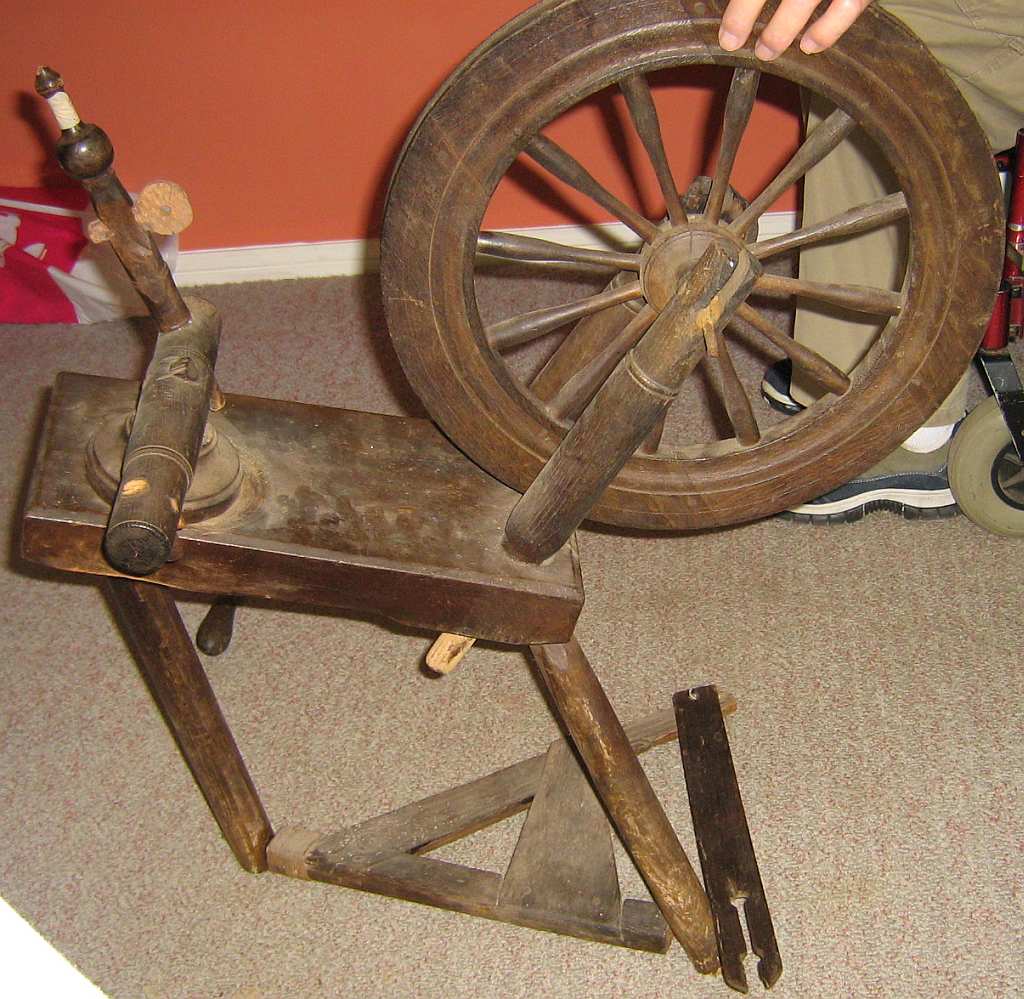

                                Not today but Sunday after 4 years, a love job came to an end. I/we were able to hand over the restored 200 yr old (approx) Hebrides spinning wheel. The full story on our Blog
                                It didn't take that long to do just how long it was in the workshop in stages of repair/restoration, brought to Australia 1800's from North Scotland and has been in the same family since passed down. Originally a Flax wheel, all Oak.
                                Parts were missing, parts broken others so badly worn from years of use from the family Crofters
                                This is the state of it when delivered
                                Then completed
                                I am on making a copy for LOML much of its ready just the wheel/fellows to make and assemble everything else is turned.

                                    Made a smaller poly-v pulley to go with the big one, give about 40-1200 rpm, which is probably more useful for general stuff. Swapping over takes less than two minutes: loosen off tension screw, lift motor to loosen belt, swap pulleys, and retighten screw.
                                    Although the motor drops lower with eth smaller pulley to get the tension, because the belt angle changes it doesn''t run any nearer the tumbler lever, which is a relief.
                                    The guard went back on a treat after chopping out a rectangular section – it's main job is holding the tacho sensor in place!
                                    Final task (for now) is replacing my pendant with fixed controls built into the old control box. I've now got a clear run for the control cable.

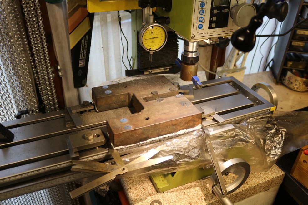

                                      Having bought a set of castings on here for a Double Tangye I have had to discard the two steam chests and covers as they had been drilled by the previous owner (no doubt a student of the Hope & Pray academy) – a right mess!
                                      This main base casting is in serious need of rectification having been previously machined incorrectly (same bloke?) . It is right on the limits of my tiddly WM-16 mill hanging over the table on either side, but I am hoping that having jacked the casting up at the left hand end I can skim the standards pads in two separate passes with the fly cutter to get the topside somewhere near right.
                                      After that it has to be turned upside down and the bottom re-machined as matey has left one end of the casting 3/16" higher than the other.
                                      Setting up and holding down are made more difficult because the hollow casting is so thin and "springy" – the walls are less than 1/4" thick. So tomorrow I will be crossing fingers that when the pads are done and I put it on the surface plate it won't rock. I 'spose that makes me a student of aforesaid academy as well. dont know
                                      Rik
                                      #153821
                                      Rik Shaw
                                        @rikshaw
                                        Should have appended this to my previous:
