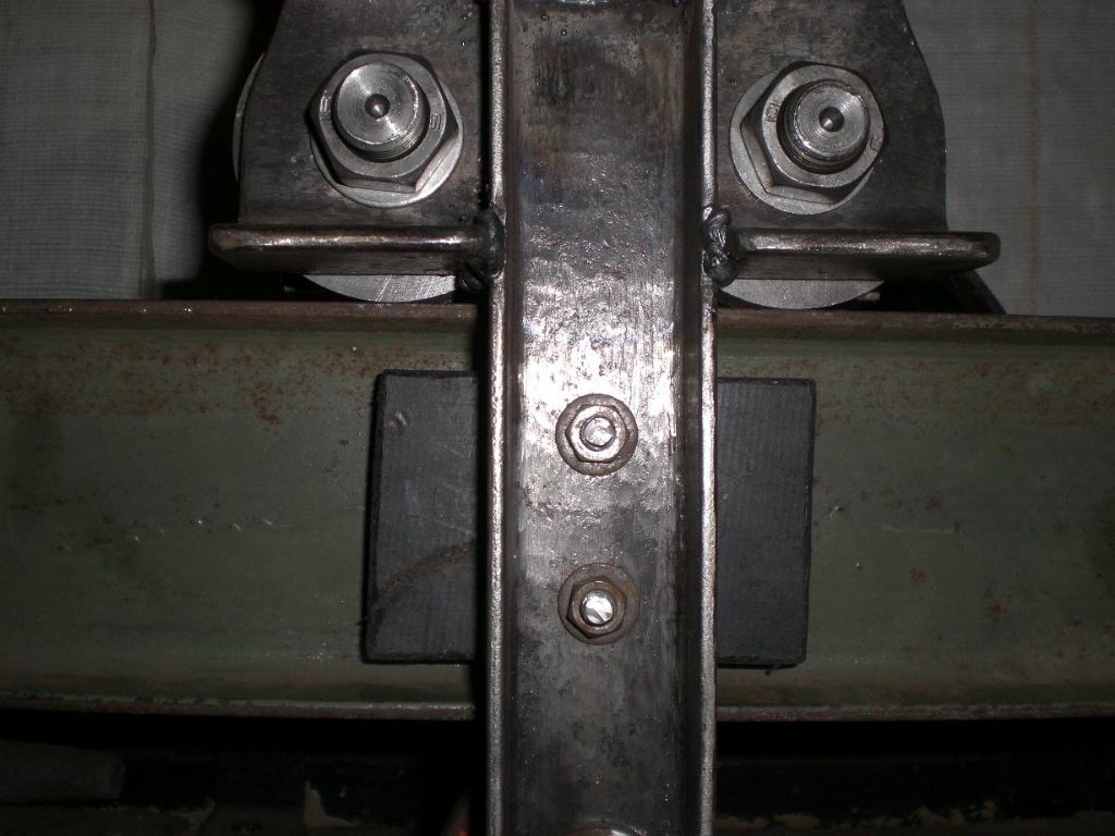

          Hi, well yesterday I cut and fitted the guide pads for my lifting beam trolley. They are made from 25mm thick abrasion resitant slippery plastic and one is bolted on the channels that hang down either side and brush against the web of the lifting beam. There is around 2 to 3mm clearance between the two of them, so there is no braking effect.
          There is a small bevel on the leading edges that face the web, which was put on with one of those de-burring milling thingies using a pistol drill, as this stuff don't like being filed, and they were then burnished with a well used flap disc on my 4 1/2" whizzy thing.
          This afternoon I gave it a test lift with my milling machine and it coped with the utmost of ease.
          Les, I did consider using flanged wheels, but the lifting beam is only 44mm wide and it would have only given 11mm wide each side of useable flange at the very best and by leaving enough clearance to stop the trolley binding, wouldn't have left much of a safety margin in my opinion. Also I would have lost a lot more travel from one side to the other. One other thing is, even if the bearings or wheels fail, it is unlikely to fall off the lifting beam.

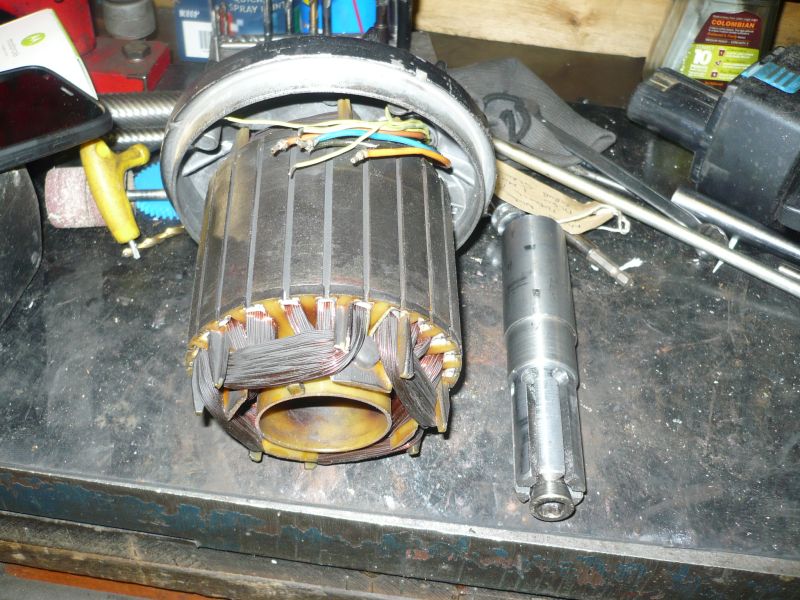

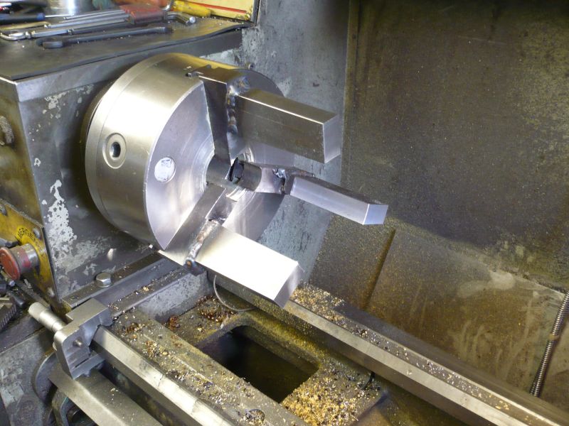

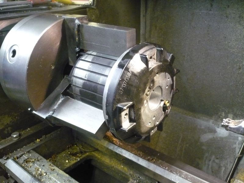

              I occasionally have to repair outrunner type motors in various sizes.
              These are where the stator stands still and the outer housing spins.They have two bearings pressed in from either end, one is shallow but the mounting end one is buried about 50mm inside.
              to do the buried one I used to hold the stator on an expanding mandrel on the die cast bore of the stator and tap to run true.
              However recently these have been coming thru with the diecast centre not central and often tapered which makes the use of a mandrel a bit iffy.
              The one I got today in the picture is the worst I have had, 30 minutes with a soft faced hammer and getting nowhere.
              So working on the opposite to hit it with a big hammer I followed the weld it where it touches school of thought.
              Result ?
              Greedy Jaws. devil
              Ten minutes later, jobs a good un.

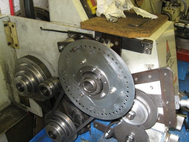

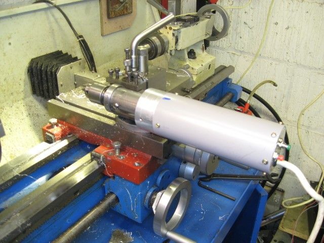

                        Finished making my toolpost mounted drill. Made from old cordless drill, a lump of aluminium from melting down the extrusion fro our old patio windows (Not very nice to machine.) and assorted bits of metal I had in stock. I did have to buy some suitable bearings.
                        Being used to drill holes in its cover.
                        Indexing plate.
                        Drill with cover fitted.
                        Les.

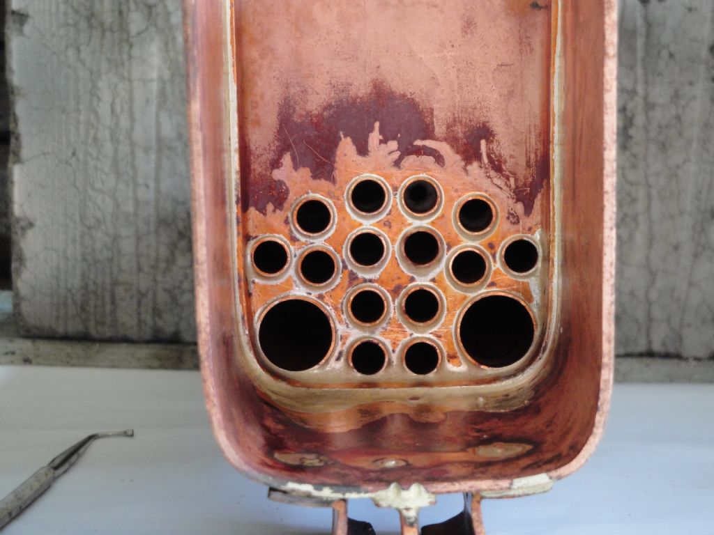

                          i silver soldered the tubes into the inner firebox of my 5"g current build LBSCR terrier STEPNEY.
                          the LBSC method of fitting silver solder wire rings (silverflo 55) over the tubes on the water space side and heating from inside the firebox was used.
                          cheers,
                          julian

                            Hi Les,
                            I have something that looks remarkably similar, right down to a switch on the end. The planetary gearbox is now housed inside a bit of steel bar and the plastic end cover is an old spice pot. Great minds eh?
                            Neat work, Julian.

                              Hi Neil,
                              The drill was a cheap one with the label "Cougar" which I bought from Asda well over 10 years ago. On this drill the torque limiter works by allowing outer of the planetary gearbox to rotate. It is prevented from rotating by a number (6 or 8 I think) spring loaded balls that engage with dimples in the end of the gearbox casing. The pressure on these springs set the torque limit. I removed this as it gave a nice cylindrical section to mount it. Removing the chuck was the difficult part as there was no way to grip the output shaft from the gearbox. I had to remove the motor and all the gears and make a tool that fitted over the three output gear spindles. I thought these might shear off when I tried to unscrew the chuck but thy survived. I did not have a switch of suitable size and current rating hence the start and stop button. It is a variation on the SCR latch that I suggested on the thread about a stop button for a VFD. Now the SCR drives a power MOSFET . Your Article about using a 63 tooth gear enabled me to cut the 3/8" 24 (UNF) threads to match the chuck. You can probably see the 63 tooth gear from Arc Euro on the view of the indexing disk.
                              Les.

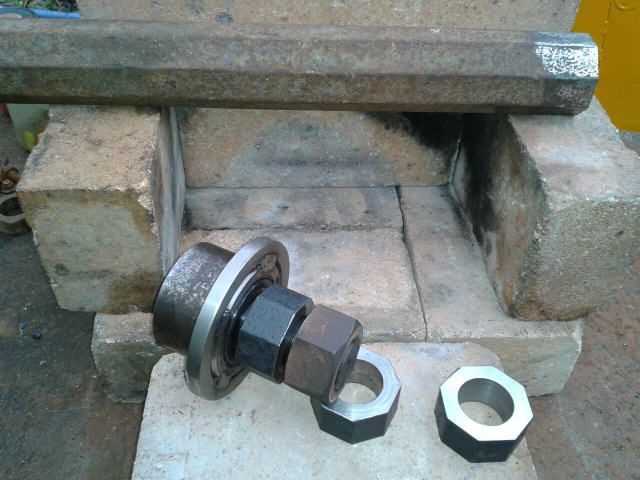

                                  Hi, well today I managed to make four big spacers for my traveling lifting beam in my garage, after a bit of a slow and troublesome job yesterday afternoon. I used a bit of octagonal bar that was large enough in diameter as it was all I have at the moment without swafing down a lump of 4" bar, however it turned out to be a bit harder that I had anticipated. After taken about a hour to saw off a couple of short lengths and struggling to get a big enough hole drilled through one of them to get my indexed carbide boaring bar in, it then took a long while to make the hole big enough and took the edge right off the carbide tip.
                                  I was beginning to think that I may have to hack down a bigger diameter bit, but I wasn't ready to give up, so I made a makeshift furnace by stacking together some refractory bricks that I have and then heated up the second bit to a nice bright red heat with my O/A tourch and then covered it up for the night with a couple more bricks.
                                  This morning I put the heat treated bit in the lathe and although it was still a bit tough, I'd drilled a hole in about tem minuites, using about five different sized drills big enough to get the boaring bar in. Having much more success drilling this bit than I did the other bit yesterday, I then cut off two more bits using a thin cutting disc rather than my power saw and then heated these two and the one I was having trouble with yesterday and then covered them to cool slowly.
                                  While they were cooling I then proceeded to boar the one that I had just drilled out, but before doing that I wondered if I could touch the edge of the carbide tip to save destroying another edge. Having ground it on my green wheel, I poped it back on the lathe and started to boar the hole out at 5 thou to start with the spidle running at 850 rpm, it was cutting happly producing a steady stream of blue swaf, I then put on 10 thou each time and it was still happly cutting away. With three holes to do, I only had to retouch the tip slightly once.
                                  The photo above shows my makeshift furnace, the rest of my bit of bar I cut the spacers off and three of the finished spacers, one of which is on one of my modified cam rollers.
                                  Regards Nick.
                                  Edited By Nicholas Farr on 10/04/2014 00:13:09

                                      Nick, are you sure the octagonal bar is not a crowbar, that would explain the toughness.

                                        Hi Ian, if it was part of a crowbar, I wouldn't want to pick a fight with the guy who may have used it, as it's about 2" across the flats and the couple of foot I've got is heavy enough. I think it might have been a drive bar of some sort as it came from where I used to work a few years ago. It was last used as a drift, because one end had the corners ground down and was slightly mushroomed and the other end is rather more mushroomed where it's been hit with a sledge hammer.

                                            Posted by Nicholas Farr on 10/04/2014 20:21:09:
                                            Sounds like a classical wrecking bar to me. You just lift it up a couple of feet and bring it down point first as hard as you can. Not many things stand up to that. Great for smashing up concrete floors etc before they invented those Kangol things. They are best used by themselves without a sledgehammer – the bigger and heavier, the better.
